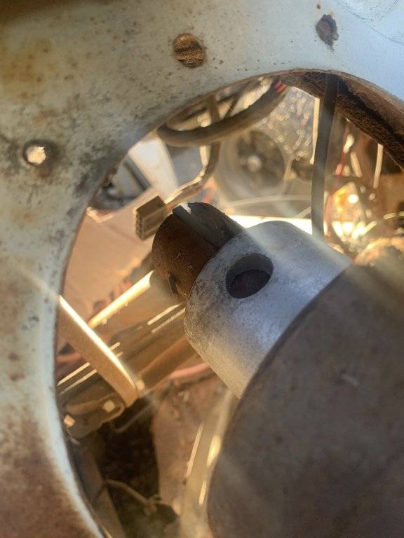

I got it apart. Mine has the roll pin. There was also about a half cup of PS oil that ran out on the floor when I pulled the column off. That upper seal must be leaking some. I have never had any oil leaking from the unit before so I'm not real sure it is something else I should deal with. My steering problem was not too much play in the steering but it was a side to side rattle when I would go over a bump or rail road track. I can see from my old bushing why that was happening. I also found the copper horn ground is broken off. The horn worked so I'm not sure that is needed but I think I may try to make a new one since that PN is no longer available. Here are a couple pics of mine.
