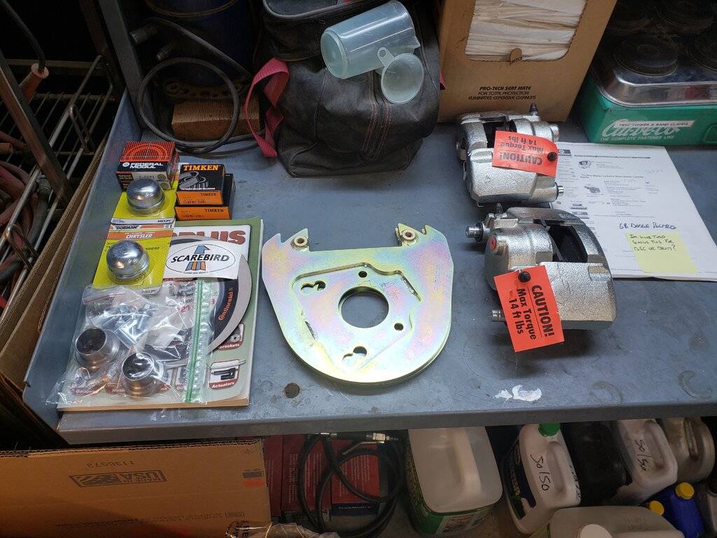

I just got the kit for my 64 880, I went with the larger scare bird calipers. Everything so far is $526.00, have to mount everything to chk hose length and buy those. I have already upgraded to a dual master cylinder but might have to change that and add a adj valve for the rear brakes.
