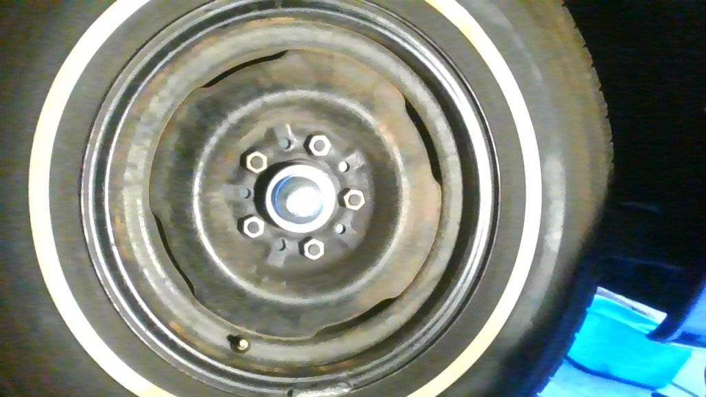

14" wheel 4 nub rim (where the poverty cap would mount- EDIT- I now found out this is a ford rim! completely wrong!)--- will not fit on front hub, as inner hole slightly too small to go on new front disc hub, but works on rear axle -- seems to take a 10" poverty cap?

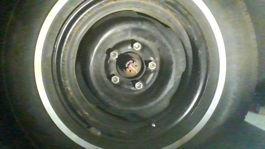

14" rim 3 nub style (where the poverty cap would mount)-- works on new front disc hubs-- so seems to be what i need--- hard to get a good measurement--- seems to take 10" poverty cap? ( I now know this is the correct Mopar rim--- Thank you 413!)

The 4 nub wheel with a smaller center hole is a Ford wheel. Don't know what cap it takes. I'd get rid on it.
Your 3 nub wheel is a mopar wheel and what you want.
That no nine wheel who knows it's origin.
When you use different year or make of wheels than the car came with they can be slightly different size and caps will fly. Or they can be quite tight to install the caps.

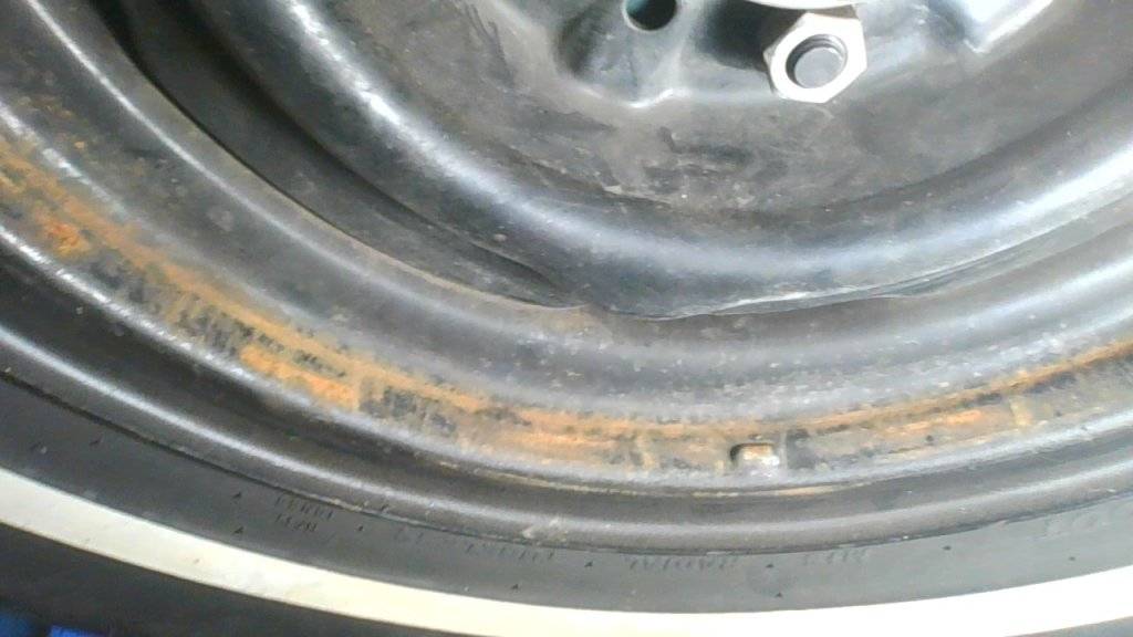

Not to beat a dead horse--- But upon further inspection, the correct 3 nub 14" Mopar steel wheel has these little nubs on the outer rim, I assume to help hold on the full wheel cover..
No wonder I was throwing them off --- It was the 2 bogus rims the whole time.. ( They do not have these nubs. )
Thank goodness now I know what I am looking for--- 2 correct Mopar rims with the exact correct features.
The nubs only address the wheel cover "turning" on the wheel as it flexes, not the other issue related to them leaving.

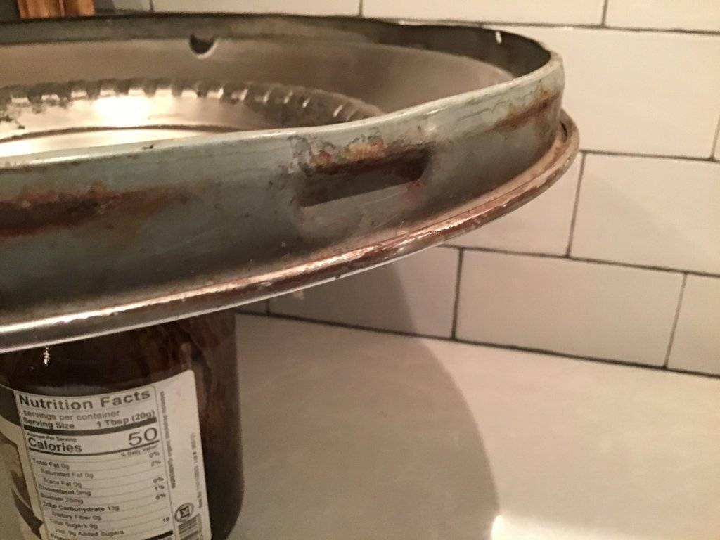

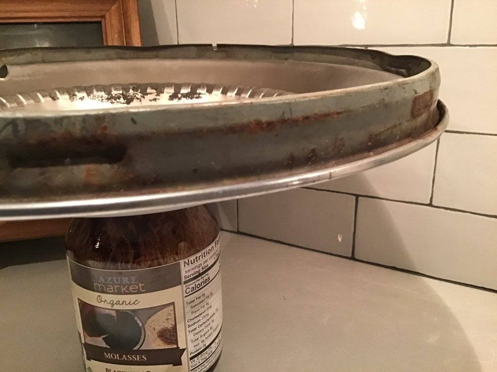

Those nubs are the only thing that retain the full wheel cover. There are 4 evenly spaced around the rim. Then the cap has 4 reliefs that go over these nubs, and 4 raised spots that grab the rim.
Photo one shows a relief
photo 2 shows a relief on left and raised spot on right)
There are no "teeth" on the cover to retain it. Does you cap look similar to this around the perimeter?
The 2 nubs to keep tha cap from rotating are a few inches apart on either side of the valve stem and they are not this large.
