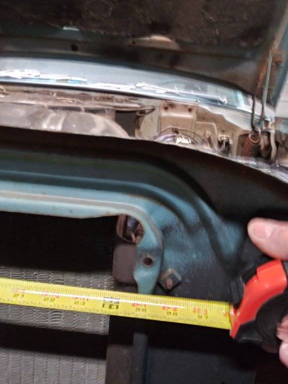

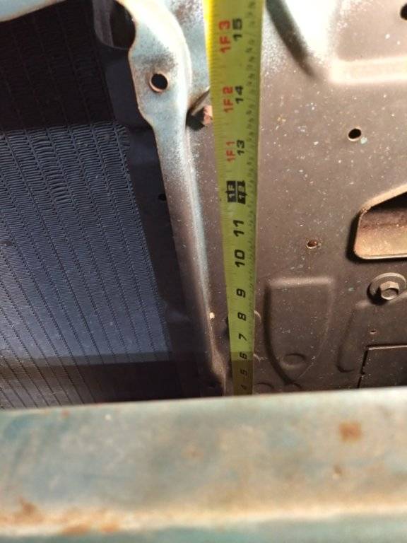

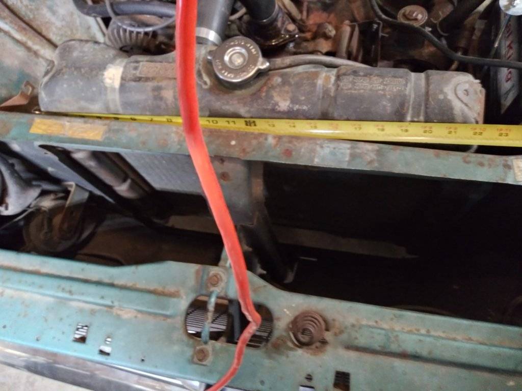

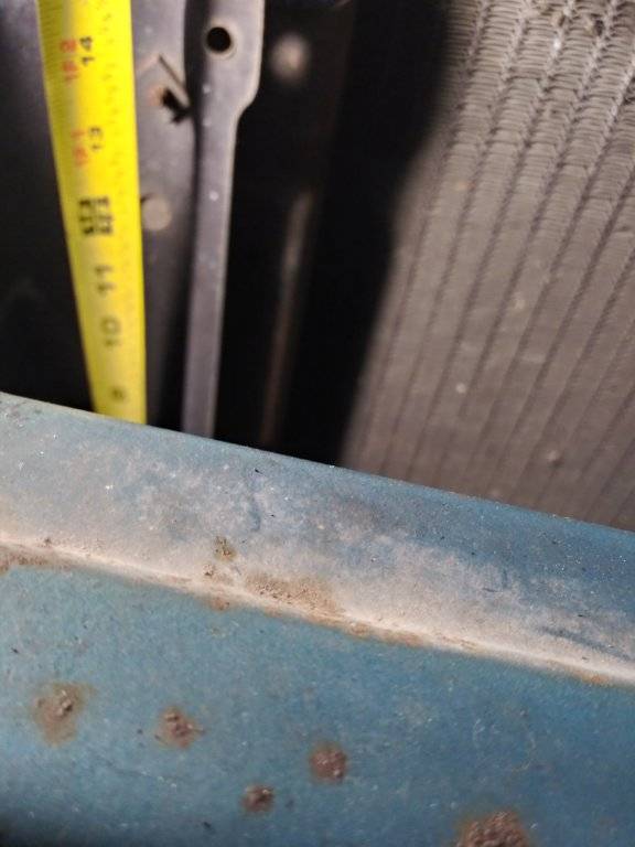

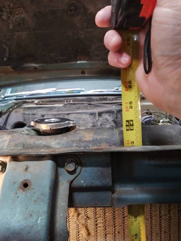

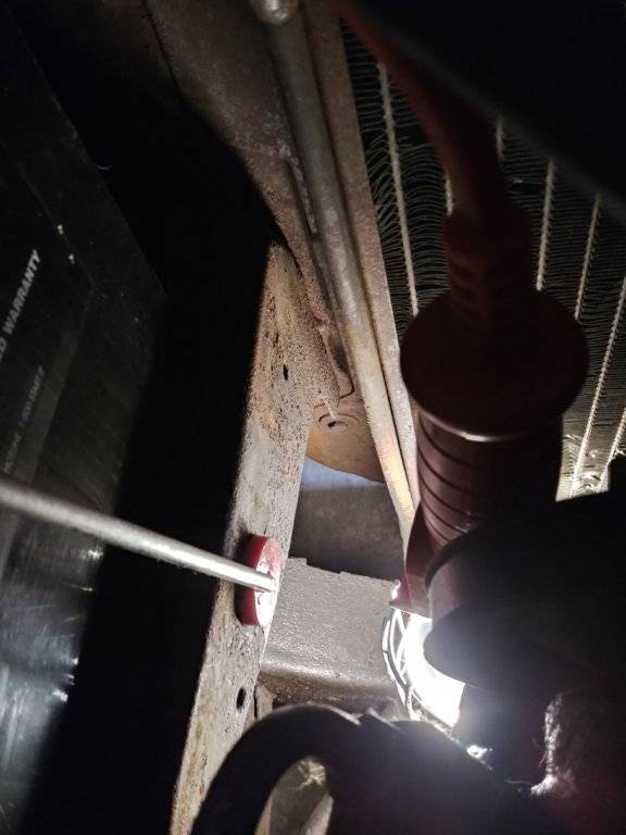

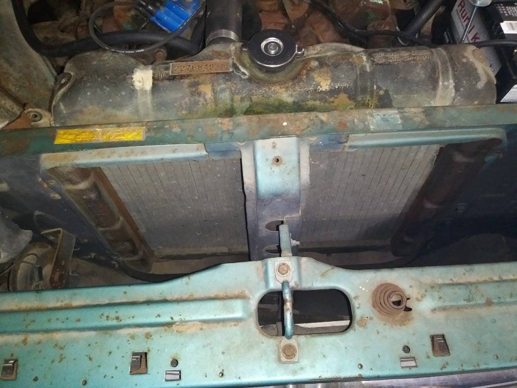

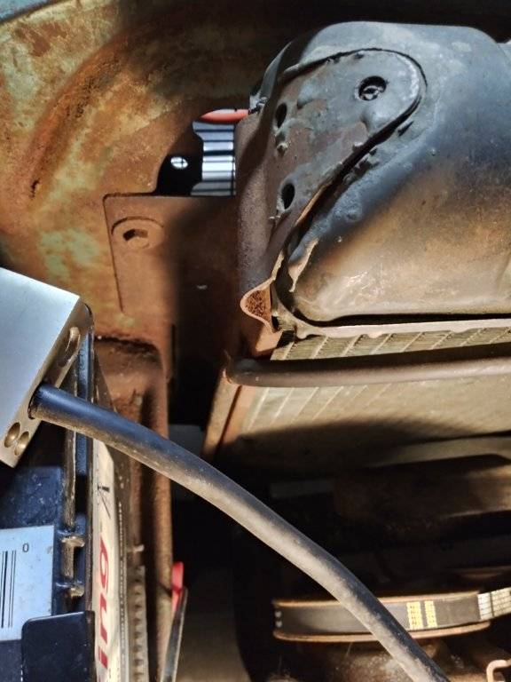

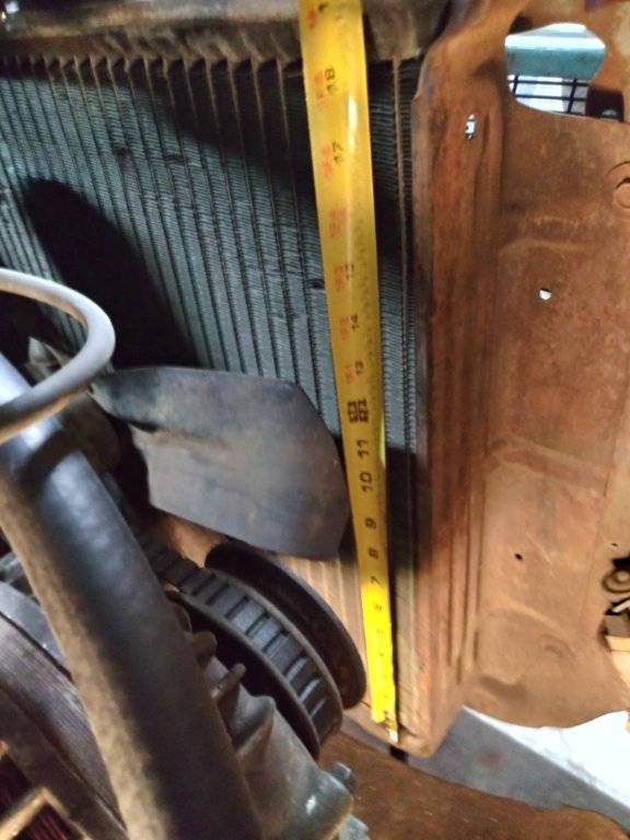

Here are some notes and in-car photos of the radiator in our 63.
Mounting bolts are about 26” side-to-side and 13” up and down.
Overall width with bracket is about 27”
Top tank is about 22 x 4
Overall height is about 24”
Core is about 18” high and 21.5” wide
Inlet is a little right of center and outlet is on driver’s side.
There is a big notch in the driver's side bracket around the battery tray.
Your top bracket needs to have the solder connection for the mounting bracket redone (Its loose from the top tank) so the core does not flex and fracture the tubes. Looks to be a standard 22" core otherwise. Attached is the '63 radiator parts numbers. Click on mail 009, not the icon.
