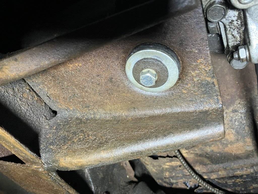

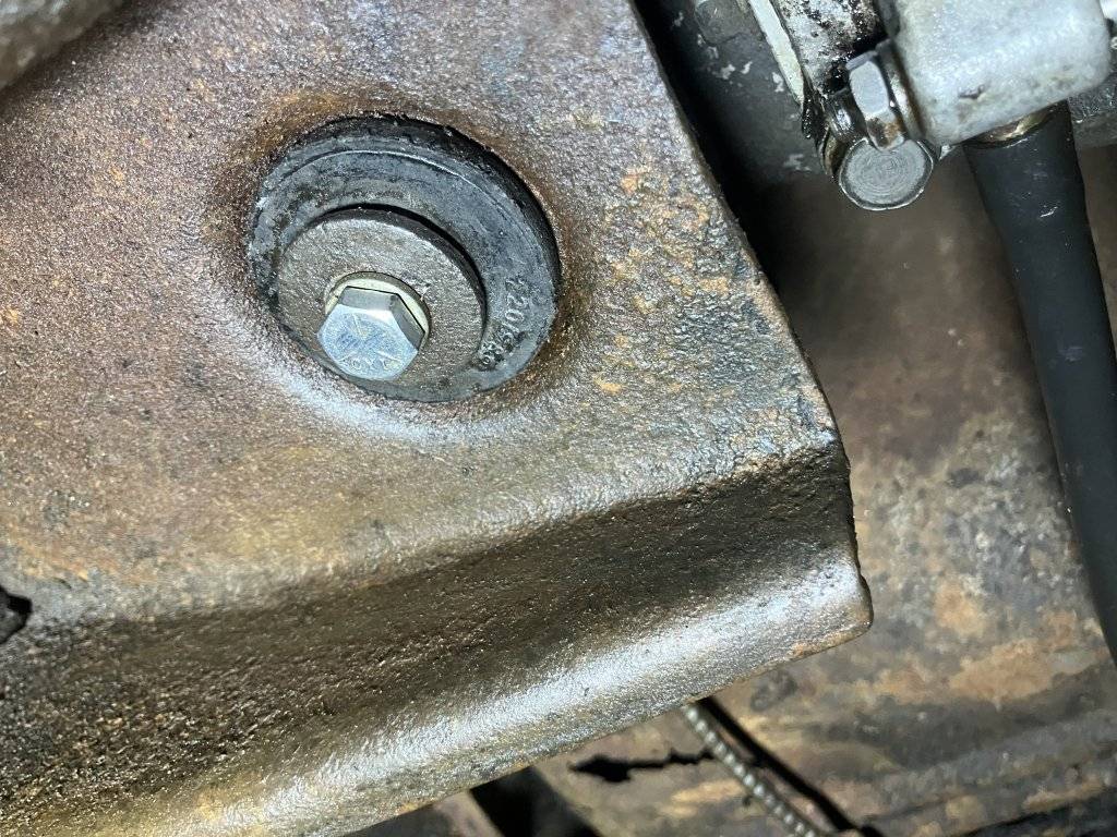

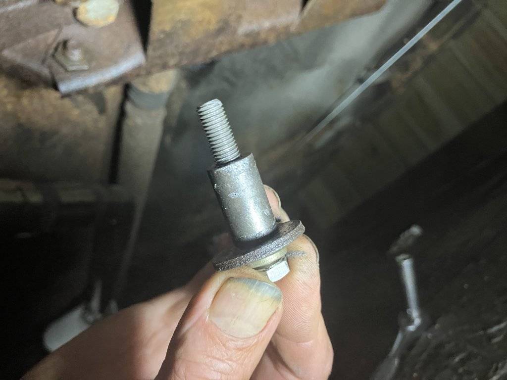

So I replaced my transmission mount in my 63 880 over the weekend and I have a question. There is a large spring between the rubber mount and the crossmember which I figured out is supposed to be there. The mounting bolt has a sleeve with a washer and when you tighten it, the sleeve bottoms out and the washer doesn’t quite tighten against the rubber bushing in the crossmember. I’ve seen this referred to as a floating mount so I wasn’t sure if it was supposed to be this way or am I missing a part. The bolt was stripped and falling out. The parts book I have lists all the part numbers but doesn’t show the diagram for the partitcular mount I have. Anybody have a picture of their mount or info they could share. The picture with the big silver washer is how I think it should go. Thank you.

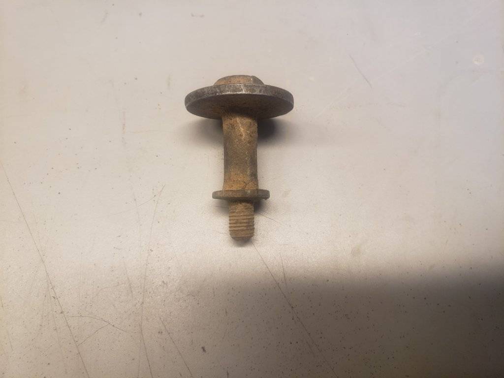

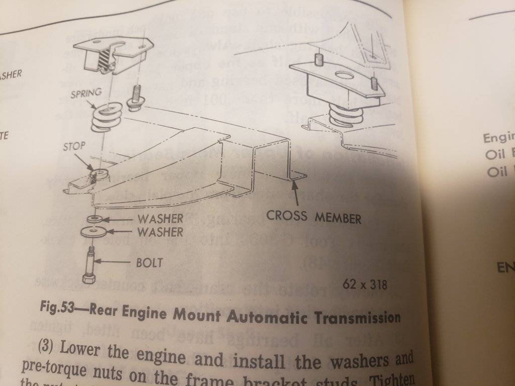

Thank you very much! The info I was looking for. What manual is that and do they list a part number for the shoulder bolt.
Great. Thank you for the pictures. Now I have a visual for the part numbers in the parts manual. Appreciate it. Does the big washer sit tight against the rubber grommet or is there a little space between it.
