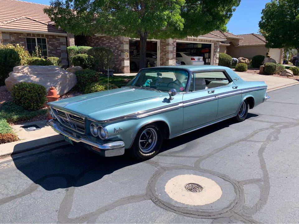

Wow, I just noticed an older ad for this car that says it was listed 47 weeks ago! So it's been for sale for almost a year.

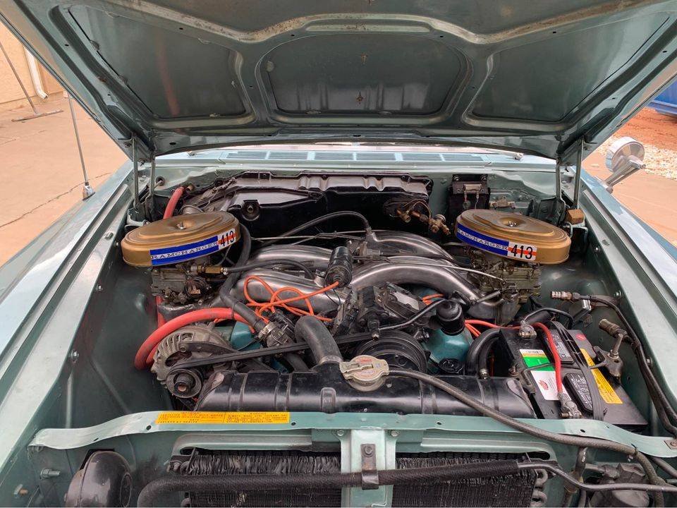

Maybe someone can take a run at decoding the fender tag. It shows a '52' under the AB position, which I think is associated with the engine.
whats wrong with the trunk not flat or closing. that can't be an option on that car, there 1960-1961 manifolds not 1963-1964

I could be wrong, picture isn't the best angle, but those look like longrams, and IIRC in 63 and 64 only the shortrams were available.
Air cleaners are the inline dual-quad type of 59 and 62 - not correct, but still valuable.
My hunch is this was a modified 383 car - but if decent quality, was well worth the $9000 price.
your right they are long rams
