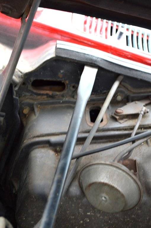

A couple questions for the slab side owners out there.
First - take a look at the photo below and tell me - what am i missing here?
I've checked photos of different cars, most have two hoses connected here. I thought it might be for a rear heater or AC unit, but saw a convertible with the hoses there recently.
The manual seems to be of no help. It also shows hoses going there, but only in outline. No definition or explanation unless I'm missing it.

The hole in the firewall is where the heater hoses connect with the heater control valve. Yours is missing.

Expect your heater core to leak, that's probably why it's disconnected.
The nipple is broken off that actuator in the picture,check for the nipple in the end of the vacuum hose. Nipple could be glued on if you find it.
Yep, it's still in the hose and fits back in perfectly. I've got a large soldering gun, so I'll try to slobber it back in first, epoxy if that doesn't take.
Thanks for the info on the valve, Imperialist. The glovebox is out (missing) so I could get a good view inside and there didn't seem room for anything much in there. Was thinking it must be some kind of control or bypass valve but could find zero info in the service manual. Found a couple replacements online that say they're for the 66 Imp but don't include the little cover with the bracket for the copper coil. Others that have the cover don't seem to have the same bulkhead plate. Think I'll cover both holes for now to keep the critters out and figure it out later.
