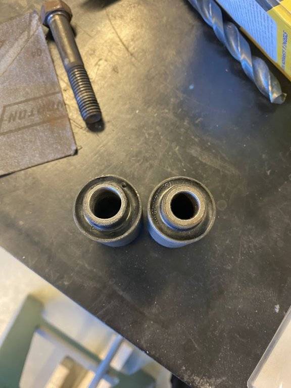

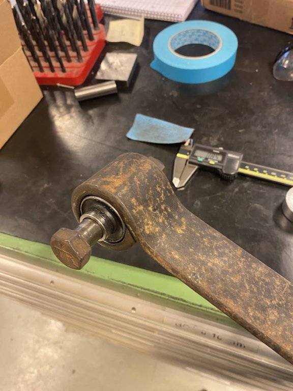

Not to make the story too long; I got the best result using Monroe L69802. If you drill out the center sleeve from Ø0.5" (12.6mm) to Ø0.57" (14.5mm), they are a direct replacement to the Harris 61120 / MOOG BR81 / Clevite 111930 originally fitted to the Imperial struts.
The bolt going through is Ø9/16".

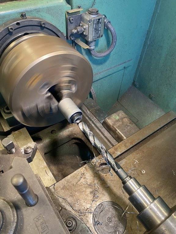

I drilled them in a lathe in 2 very small increments (0.04" / 1mm), as there are not a lot of inner sleeve to clamp on. I imagine it can be done in a drill press as well. Took me about an hour to do all 4, so that was well worth my time at $10/bushing.

After and before drilling:
