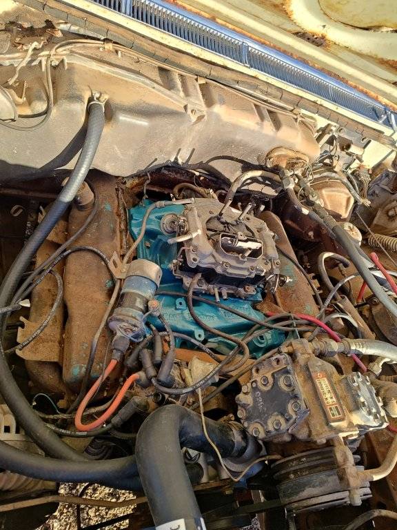

So I was very happy today when the beasty fired up! I had to add three spark plug wires (one was mia and the other two were visible broken. Somewhere in my barn is a box full of spark plug wires, but I couldn't find it. So two new sets are on the way. And no, I could bare to rob wires from my 70 Challenger!
So best I can tell, the mechanical fuel pump is not working. I had hooked the suction side up to a five gallon gas can, and nothing pumped out once the carburetor fuel bowls emptied after I filled them. So another part to buy - fuel pump.

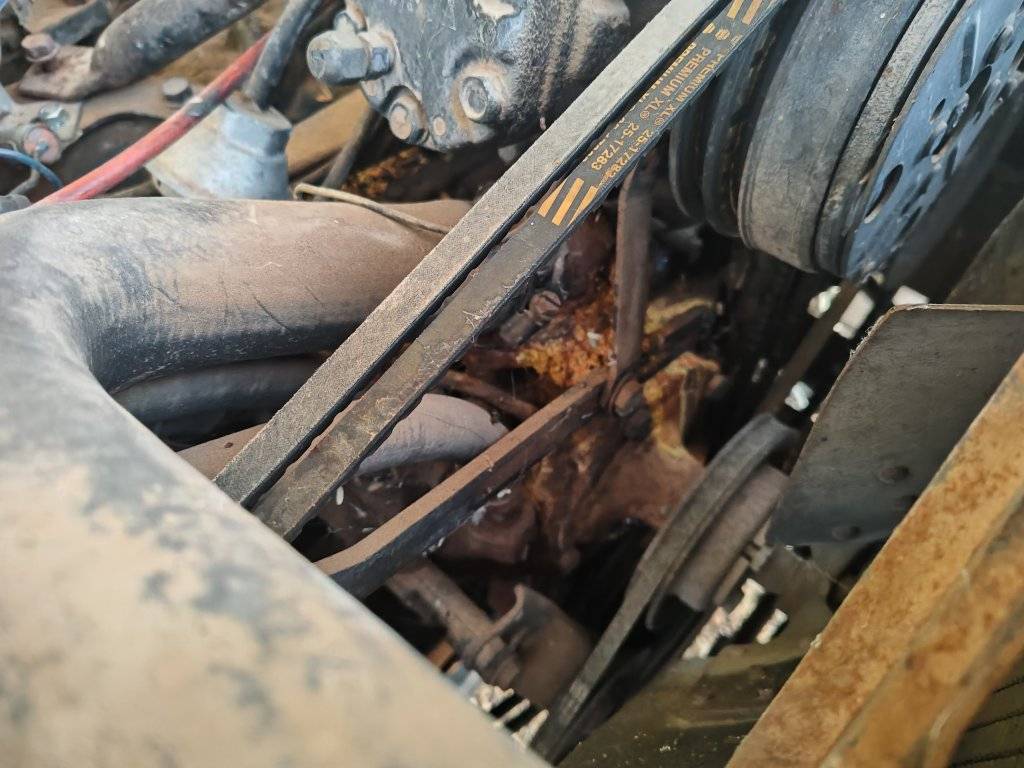

Since there seems to have been some kind of massive coolant leak at the thermostat housing, I going to just pull the whole front end off and replace the housing, water pump, fuel pump, radiator, timing chain set, camshaft and lifters and pushrods. Then rebuild the carburetor.

Changed out spark plugs and added new spark plugs wires. Hooked up a $10 electric fuel pump and she runs good! Need to rebuild the carburetor while I'm at it! Too bad I can't upload a nine second video of it running!

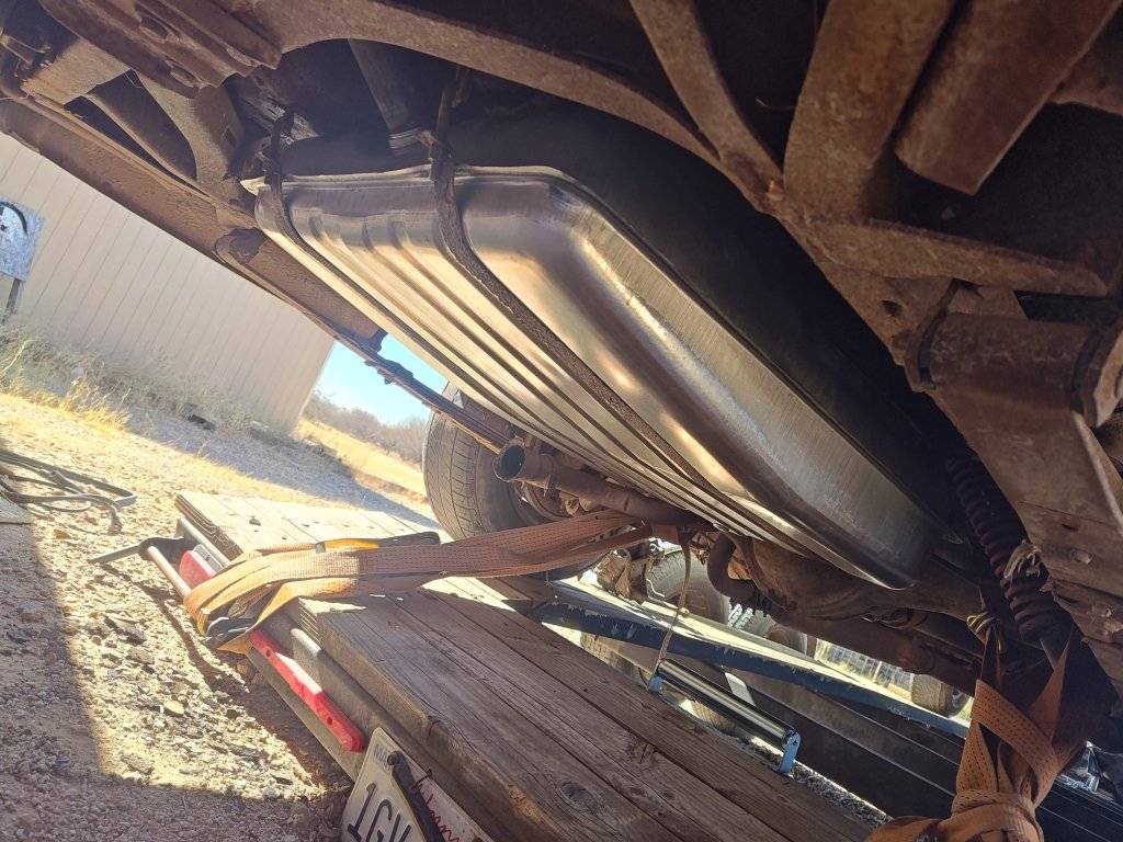

Got the new fuel tank and sending unit installed into the Imperial today. I cleaned the bottom side of the trunk and painted it with self etching primer, black paint and under coating. Old tank is probably still good, just needs a good cleaning.

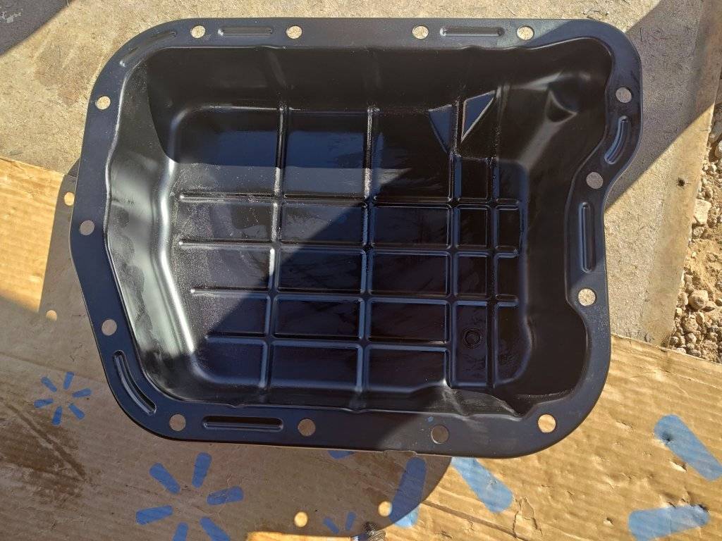

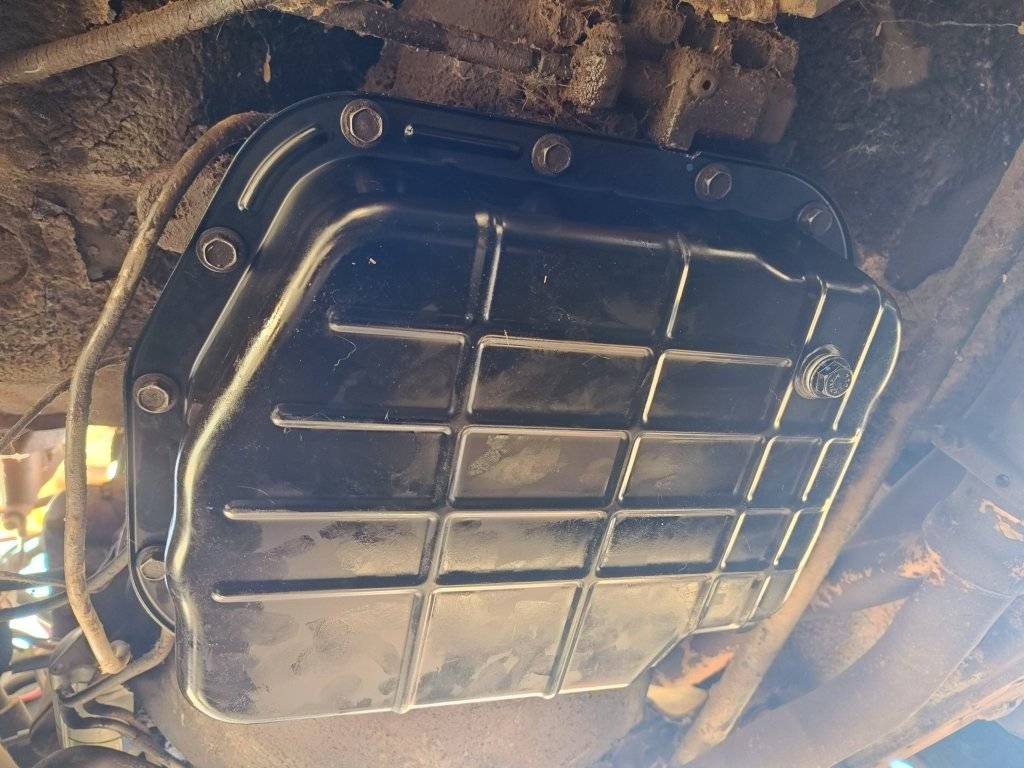

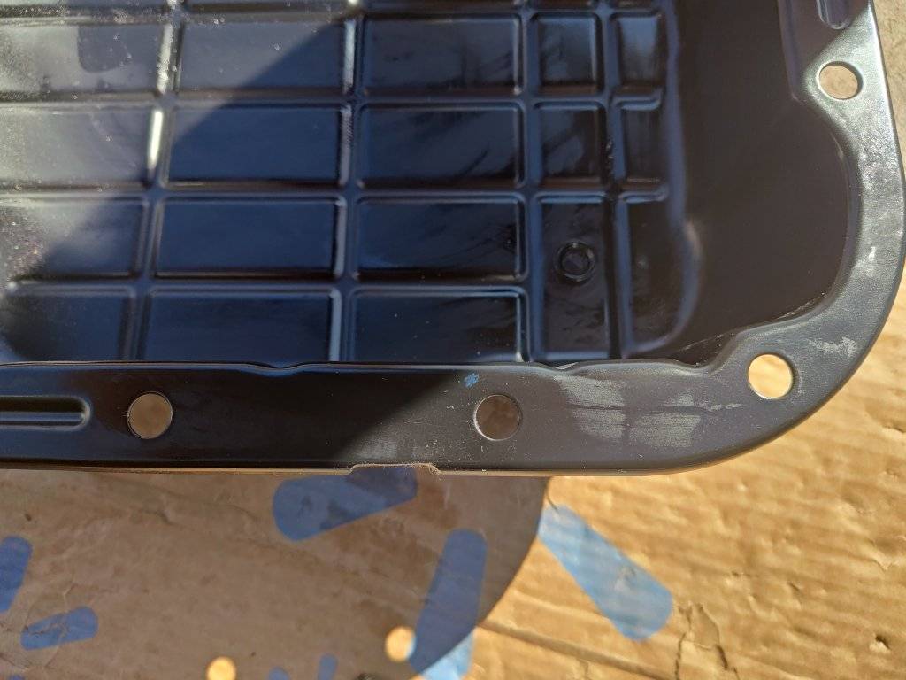

Been working on installing the front disc brakes, but took a break from that to surface the transmission. One of the things I like to do on all Mopars with a 727 is install a later 518/46rh transmission pan and extended pickup. As most of you know, and for those of you who don't, 64 727 torqueflites are not only cable shifted with a separate part cable, but have a rear pump as well! So I had to mark one of my 66 and up filter extension using the correct filter and drill a 1/2" hole for the rear pump. For those that don't want to modify an extension, A&A transmission sales them for $65 with a gasket to go between the valve body and extension. So I took off the old pan and drained the transmission in the process. So imbecile has installed a regular filter that didn't have the correct rear pump hole in it! Know what you're working on folks!! Hopefully the Imperial's transmission is OK. I did want to share a slight modification I had to make to the newer deeper pan. The newer pan hits the parking brake housing so a little grinding was needed. See pictures for the modification. Hopefully I can get this this driving by end of March. I was hoping for the end of February but life gets in the way!
