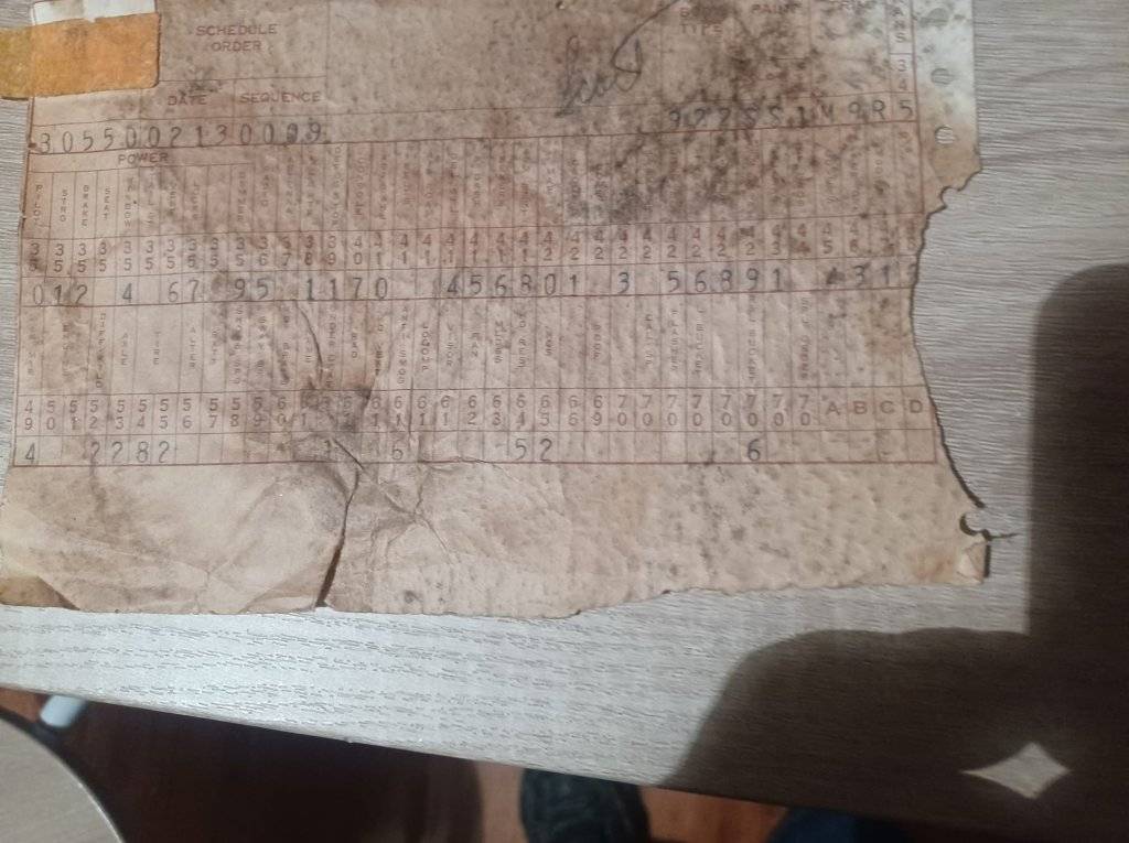

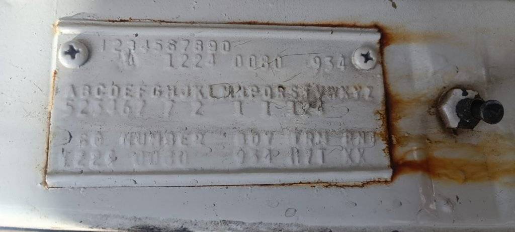

its the data plate option codes on the door jamb that we are researching,
lines 3 & 4 down. alpha numeric format.
for eg, G9 = auto headlight beam changer.
so we are looking for the 3 items - data card, broadcast sheet and body tag pics for the same car in the hope this will make things easier to decode.
tx mark
i dont know for sure that there is one in the car, you can get a photocopy of the ibm data card from chrysler historical once you prove ownership of the car in question, but im told the quality can be poor.

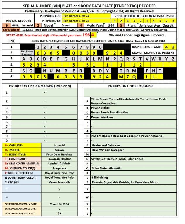

If anyone is still tracking this thread, I have a decoder under testing. Below is what it came up with for the car in question. Questions/concerns/criticisms welcome.
