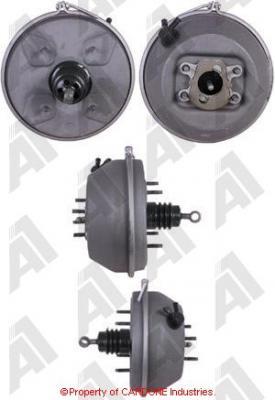

The one I'm familiar with looked like this, and is known as a 2 pc shell clamp band booster, which was different than the disc booster which was a 2 pc shell bent-tab closure type.
Drum brake booster (IIRC, it's a Midland-Ross unit)

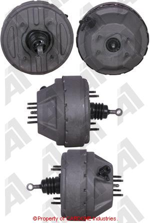

Bendix Dual Diaphragm Disc brake booster

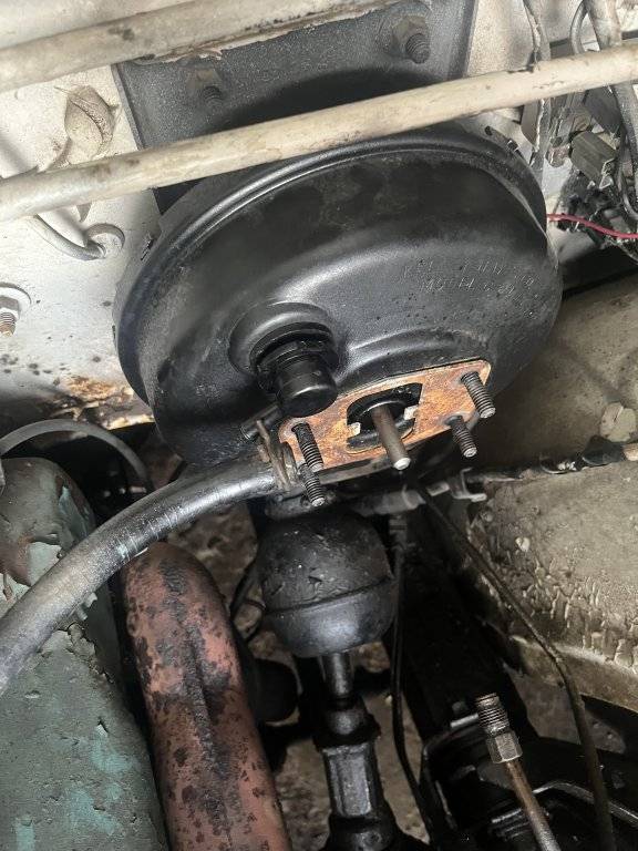

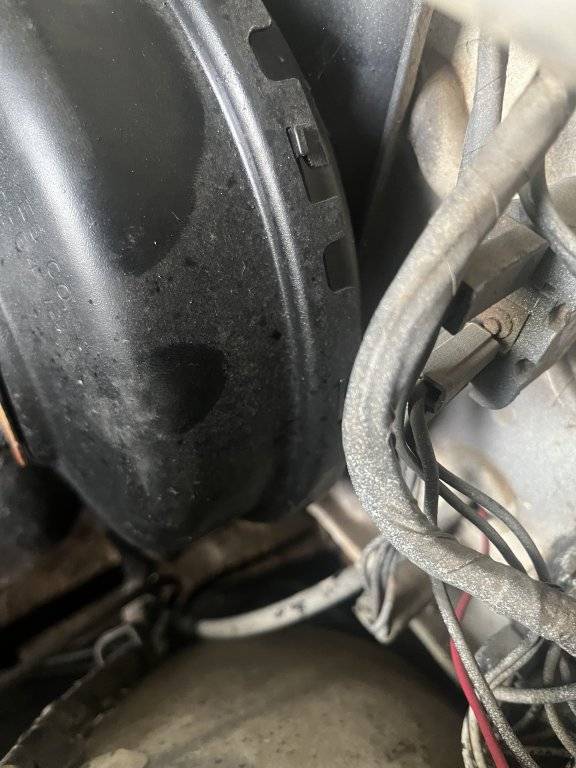

Please see pics
This car has been in the family since 1972
I’ve owned it since 1980 when I was 12
Don’t remember any brake work being done
One rebuilder thought this unit was an aftermarket available in the 70’s?
Thanks again
Hmmm - looks like a "field/upgrade for the aftermarket" KH booster. Never seen one of those on a C body that I recall.
If it fits and worked well, have it rebuilt.
