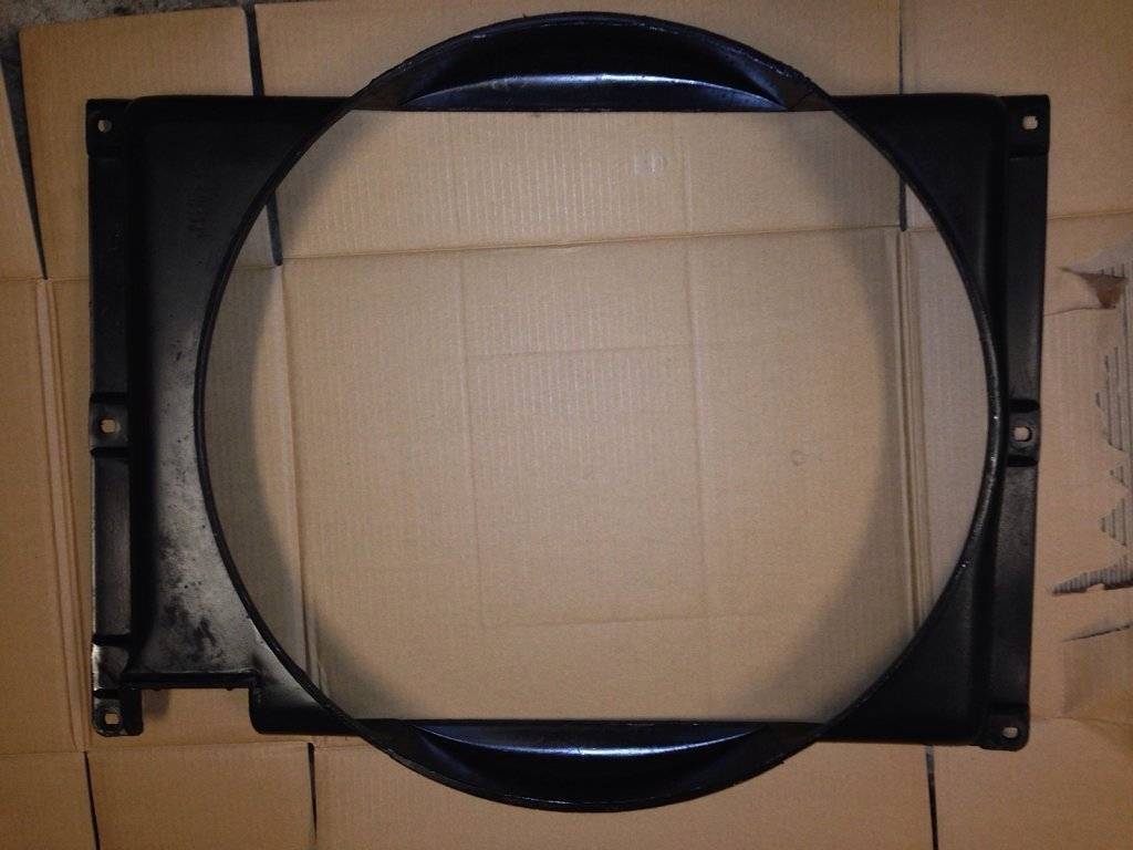

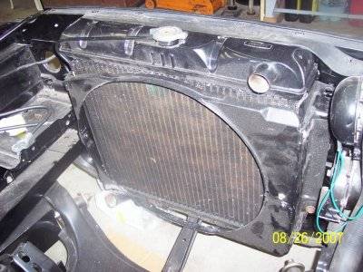

do you have any pics of the rad with shroud?
That's a 26" radiator, I don't have a shroud on either of my 26" radiators, but I might have a broken one I can use to take a picture.
That radiator in the ad has the studs for mounting the shroud.

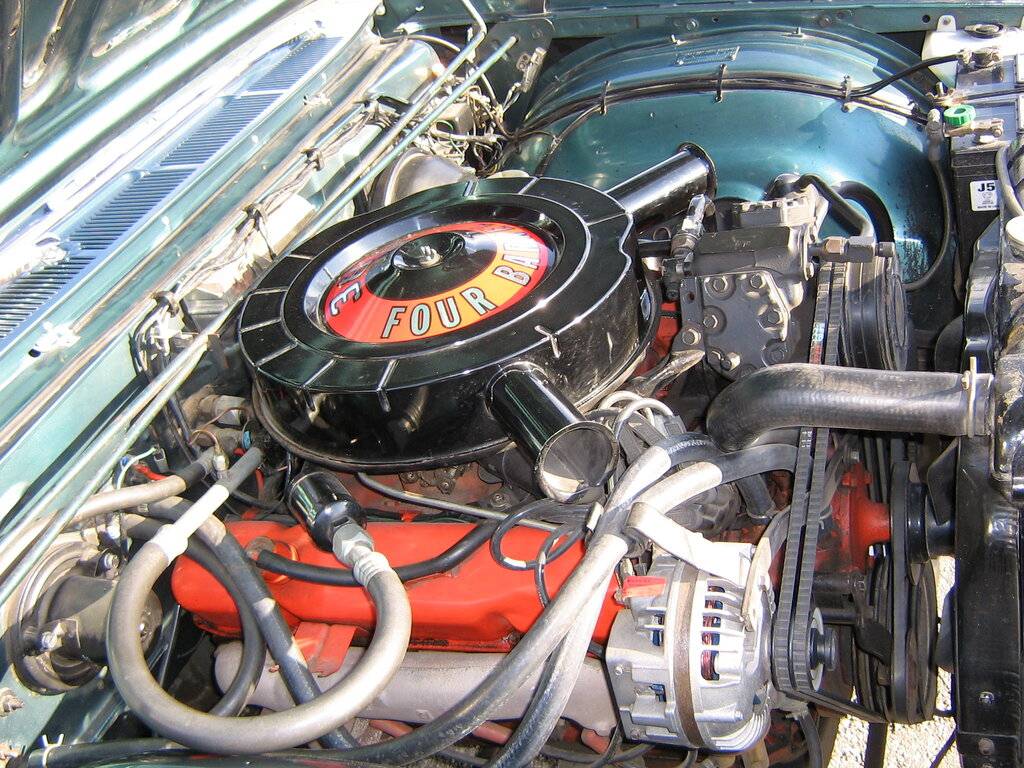

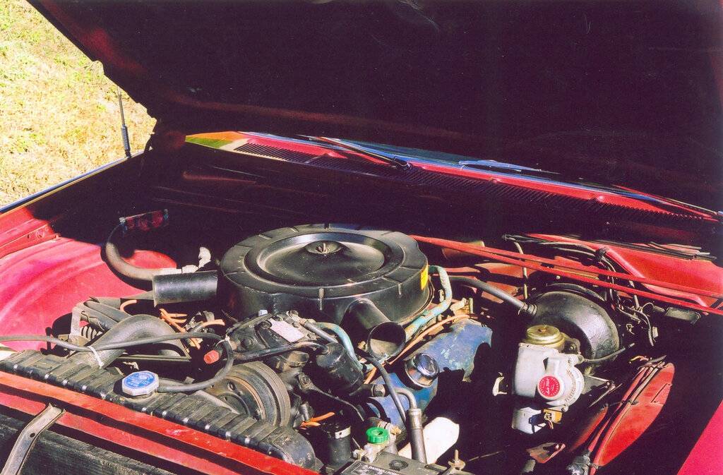

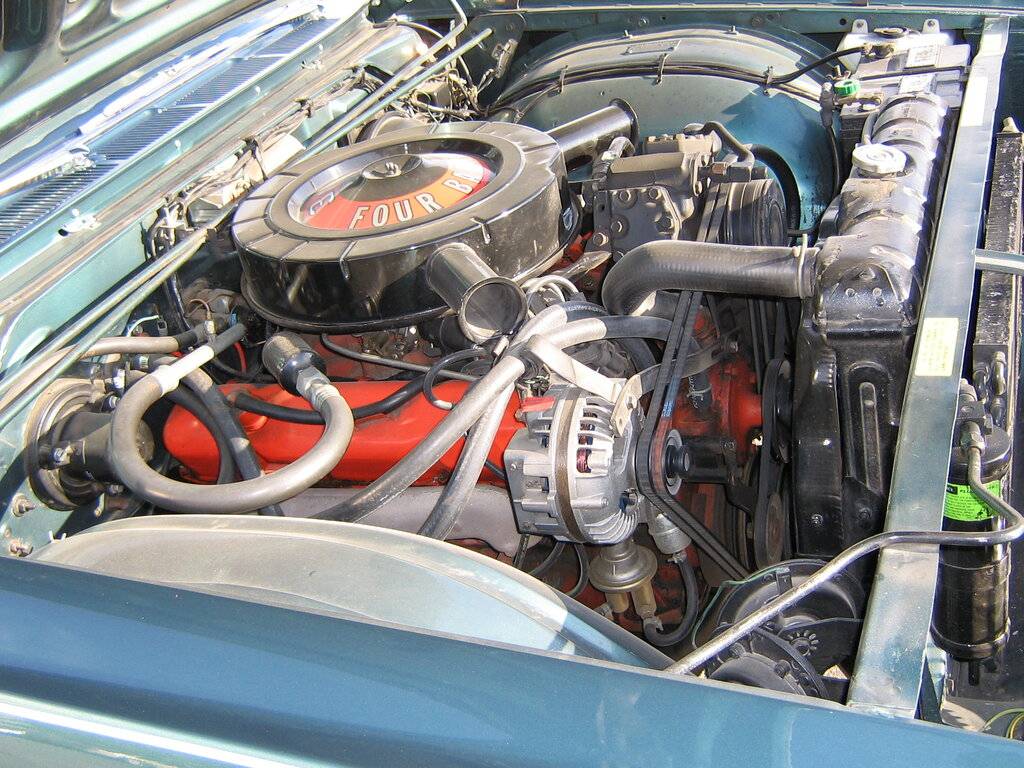

Here is a picture of my 66 Monaco with a 22" rad and shroud. It should be the same from 65, because that's where the shroud came from.
Here is a pic of a 66 with a 26" rad (and although you can't see it, it has a plastic shroud).
Which rad do you have?

Had 3 - the middle car in the picture has been sold.
Sorry, forgot to mention:
The shroud for a 22" rad is a two piece metal shroud.
The shroud for a 26" rad is a one piece plastic.

good to know. the one i have is a 2 piece so it must be a 22'
22" shroud (B body shown, but C body is very similar - you can see how the two pieces bolt to a bracket in the middle):
26" shroud:
