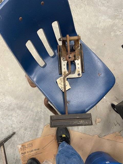

These should be 65 Fury Power (they are labeled as such). I had the booster laying around from that car for a long time, but may have chucked it. I will look around. $50 plus actual shipping fro the pedal. I am assuming you don't want a manual trans setup - those are a hens tooth.
