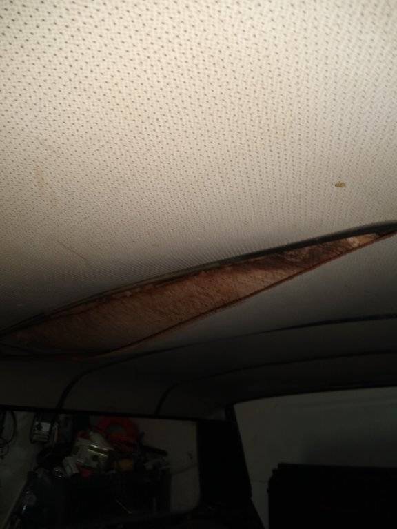

65 New Yorker wagon, one panel has separated. Looks like they are just glued to the chrome bows, on a very narrow channel.
To repair, do you just be careful, and glue it back on the bow, or do you move that bow around?

I'm hoping I can just secure this back up, rest is pretty good condition

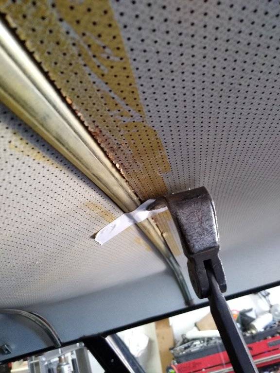

No one reproduces it. I'd be interested to know how you deal with the repair/repositioning, as I don't think they're glued, just held up there by the bows and friction. The bows have to be positioned to keep the panels tight in the channels, or they'll fall.
That's what I'm trying to figure out, I think you might be right, it's kinda of a pressure fit, but I don't know for sure yet. Very small edge to glue to
With time, the board has probably shrunk a bit, which caused the detachment from the bow?
See if you can push it forward to re-engage with the bow AND hope that it hasn't deformed too much, re-indexing with the bow properly. Then worry about the back of that panel, hopefully with some "stock" to fill the gap?

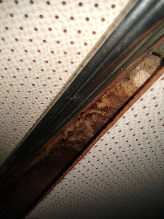

CBODY67
Looked like the board in front did buckle a little. Maybe hitting it with steam would fix it? I decided to hit the edge with expoxy. When dry, I'll expoxy the whole edge. Might put up a chrome strip to hide it, it's stained anyway ( pic not loading, I'll put one up later)
