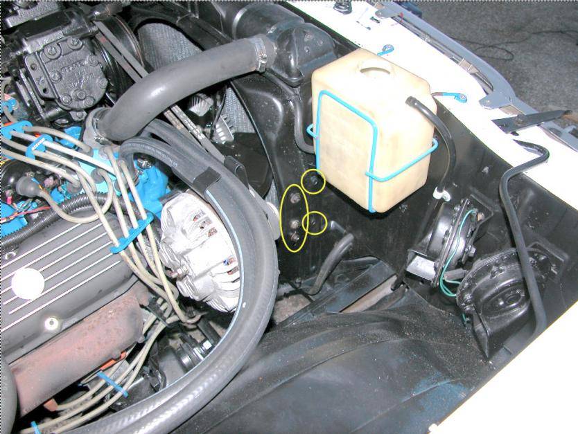

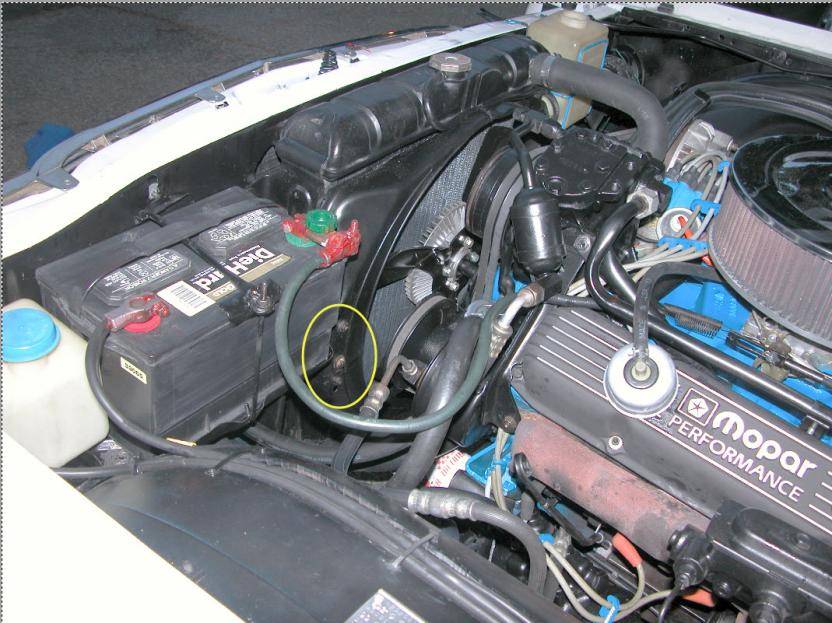

The stock one for a 413 w/AC, four row core is a 2 piece. There is a bracket that is on both sides of the radiator: facing the engine, there are three studs on each side, the two halves overlap, and are nutted on. The left side has the studs facing left and the right side has the studs facing back. Attached is a picture of both sides. The battery is hiding the radiator to bracket bolts but it is the same as the other side.

I have a 65 Coronet with a 1968 440 but it has a 1965 "C" body radiator. I'm looking for a shroud and it seems the one pictured for the 413 is what I would need as my radiator brackets have two rectangular holes on each side, half way up the core, and spaced about 4" apart. The shroud pictured seems to be mounted that way? However the holes do not have captive nuts in them so I don't know how you would fasten the shroud to the radiator?
Thanks......
Great pictures and description, very helpful. Thanks.
