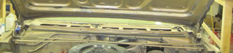

I am having some issues with the hood, I re positioned the locking latch and now it locks tightly, however when opening the hood, i am not sure how it props open, there are 2 metal rods extending to both sides of the hood, but how does this assembly work?

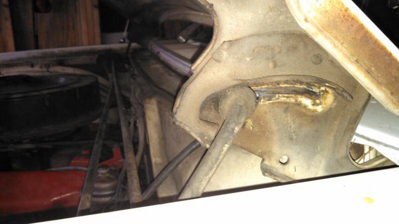

Don't know if you still need an answer on this, but I can send you pics of my 66 fury III hood attachment to show how those rods attach to create the torsion springs that keep the hood open. Let me know if you need more than the attached image.
Rob

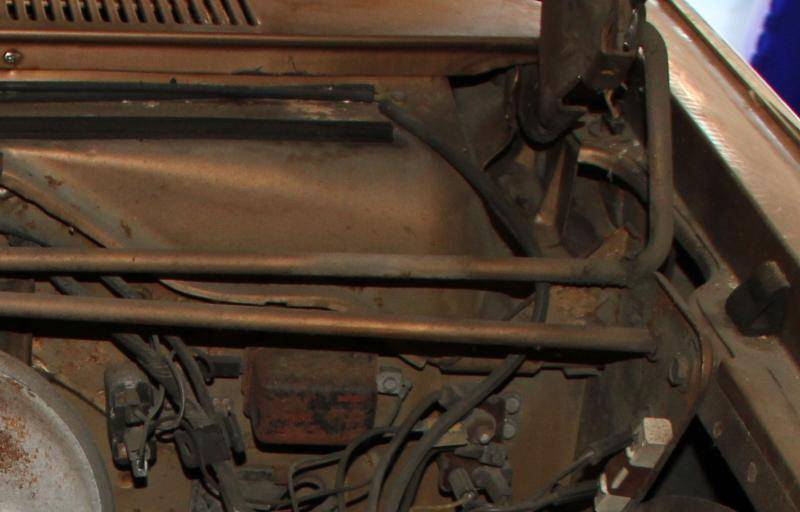

I have the two rods, but they are very slack and loose when connecting to the hood hinge, is there a spring or something somewhere? some more pictures of various parts of the mechanism would be helpful, also the other side of the hood hinge too.

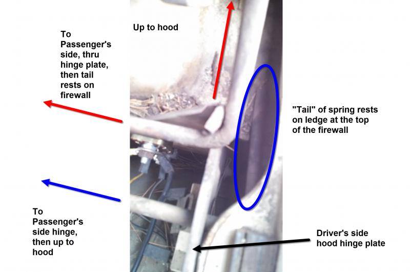

The rods are the "spring" they are torsion bars. I haven't had a 60's era C body in 20 years so I'll defer to current owners on the adjustment...but it sounds like adjustment is all that's needed.
If the springs are loose, then you might want to check how the ends of the rods are positioned. I hope this pic comes through. It's a real tough spot to photograph.
