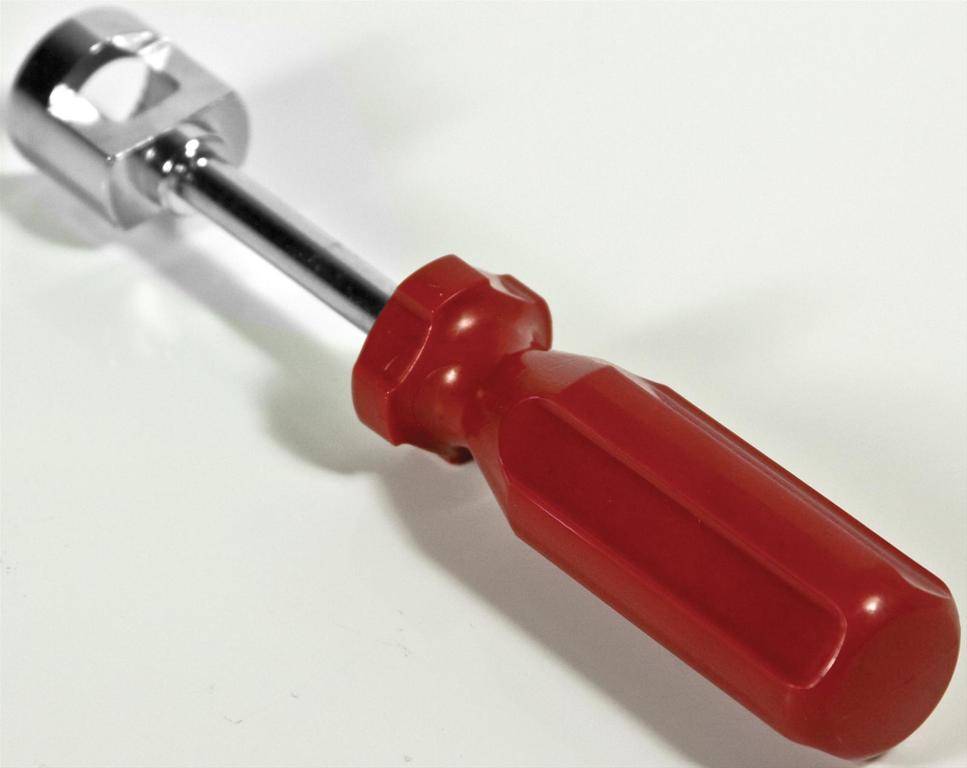

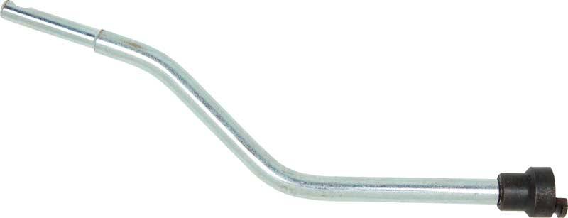

Another question I have is the 1965 service manual keeps saying special tool this and that. Is there a drum tool kit I can buy that has the tools I need?
Hi Shorty65
There’s nothing special about the drum brakes other than having the right typical brake tools
The two tools that make things easier are these..
I've done drum brakes without these many times, but they do make the job much easier.
Big 10-4 on having the right tools to make the job easy! After finally breaking down and getting a combination tool at VatoZone for ~ $12 I asked myself, "WHY did I subject myself to using pliers, box-end wrenches et al for the last 40 yrs I've worked on drum brakes?"
