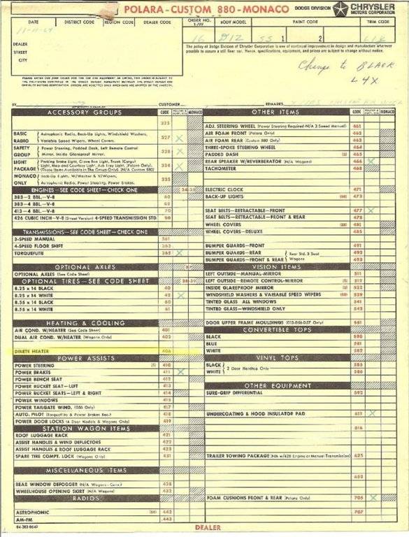

    The 65 Dodge order sheet is very clear that code 406 Heater (which WAS standard) Delete was available.
    This the best 65 Fury order sheet I have. I believe the highlighted portion shows HEATER DELETE 406 was available.
    • Thanks! Thanks! x 4
    • Like Like x 1

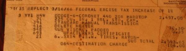

    '66 /6 Coronet. Code 416 HEATER DELETE $70.30 credit
    • Thanks! Thanks! x 1
