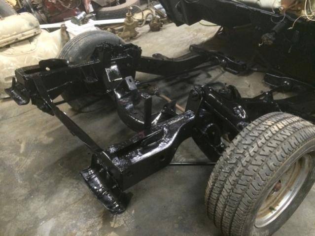

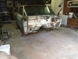

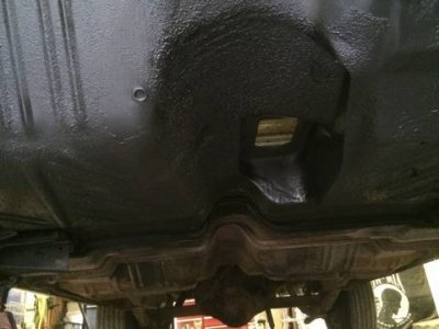

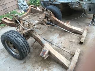

Well to day I removed the stub frame from the 66 and the 65. I put the 65 stub back under the 66. I cleaned up the fire wall from the pinch weld down and use spray on bed liner (plastikote number 264) to give it a protective coat from the pinch weld to just past were the stub frame mounts. I got the 66 stub cleaned up and washed so tomorrow I can paint it black (john deere blitz black) I still have to remove the brake lines and fuel line. They will get replaced. Then after it dries I'll put the 66 stub under the 65.

Well today was a rainy day. I'm not complaining cause we need it. But I did get some done. I removed the brake lines from the 66 stub and cut the sway bar brackets and clutch bracket from the 65 stub and got them welded on the 66 stub. And got the stub painted. Tomorrow I'll get it mounted to the 65. It's drying as I write this. I'm thinking of upgrading the front to disc brakes or splitting the lines so if I loose a wheel cylinder I will still be able to stop. If I do the disc brake what's the most common or easiest car to remove the parts I need?

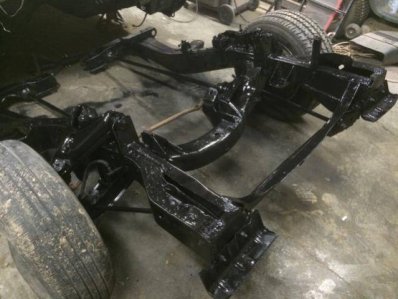

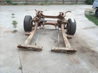

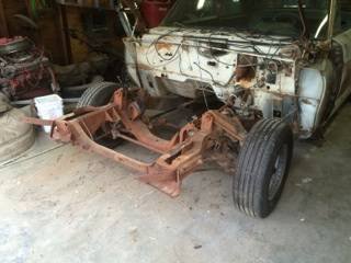

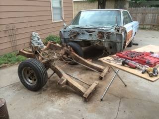

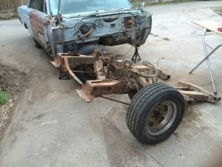

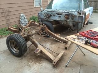

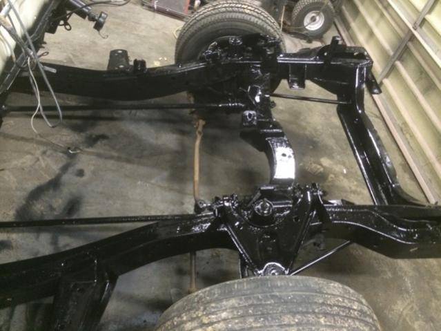

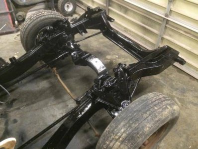

Here are some pics of the stub swap.
IMG_1741.jpgIMG_1742.jpgIMG_1743.jpgIMG_1744.jpgIMG_1745.jpgIMG_1746.jpgIMG_1747.jpgIMG_1748.jpgIMG_1749.jpgIMG_1750.jpg

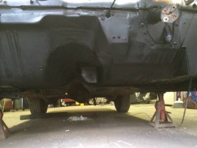

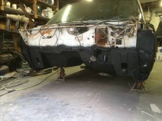

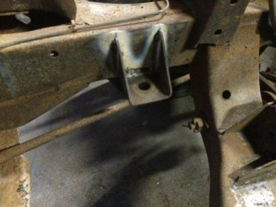

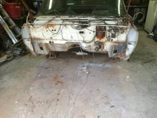

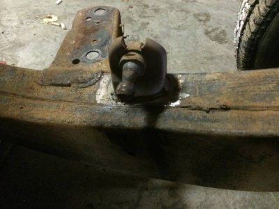

And heres a few of the fire wall and my sway bar bracket and clutch bracket i welded to the 66 stub frame.
IMG_1751.jpgIMG_1752.jpgIMG_1753.jpgIMG_1754.jpgIMG_1755.jpgIMG_1756.jpgIMG_1757.jpgIMG_1762.jpgIMG_1763.jpgIMG_1765.jpg

looking good, what paint did you use on the stub?
It's just some john deere gloss enamel nothing to fancy. Same stuff I shot on my GMC's frame and it's held up pretty good. It's like $20 for the quart of paint and quart of reducer. If I was building a top show car I would have had it blasted and powder coated.
Well a couple days ago I got the stub under the 65 and squared it up to the body. Now I'm goin to fit all the front pieces back together to get it all fitted right and how I want the gaps to look.
