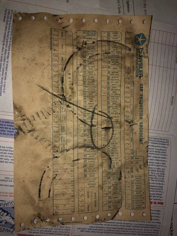

    im looking at putting my interior in my car back together when I tore it out the carpet and head liner were horrible. Does anyone know where I can find the color code so I can get the right blue interior for my 1965 sport fury coupe

    www.smsautofabrics.com. If you send them a sample, they can match pretty much anything. Color codes should also be on the build sheet if that is available. SMS builds the headliners in the correct materials also.

    Don’t have a sample to send them but do have the original build sheet I found under one of the seats

    What section of the build sheet says the option code

    Same interior color codes should also be on the Data Plate under the hood. Might check out www.hamtramck-historical.com for information in the color & trim books in the Library section.

    Awesome website I never knew about and found the code for tourquise interior in 2 seconds thanks for the info
