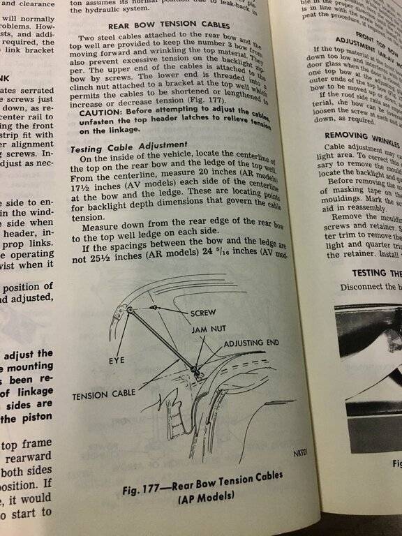

65 fury rear bow measurement
TerryM
Jun 18, 2016
471
1,447
Brisbane, Australia
Hi, does anyone know the measurement for the rear bow from the back edge to the tub edge on a 65 fury? I’ve just started fitting my top and the manual I have only shows the measurements for AR and AV models. Nothing for AP. Or could someone measure theirs? Regards Terry
