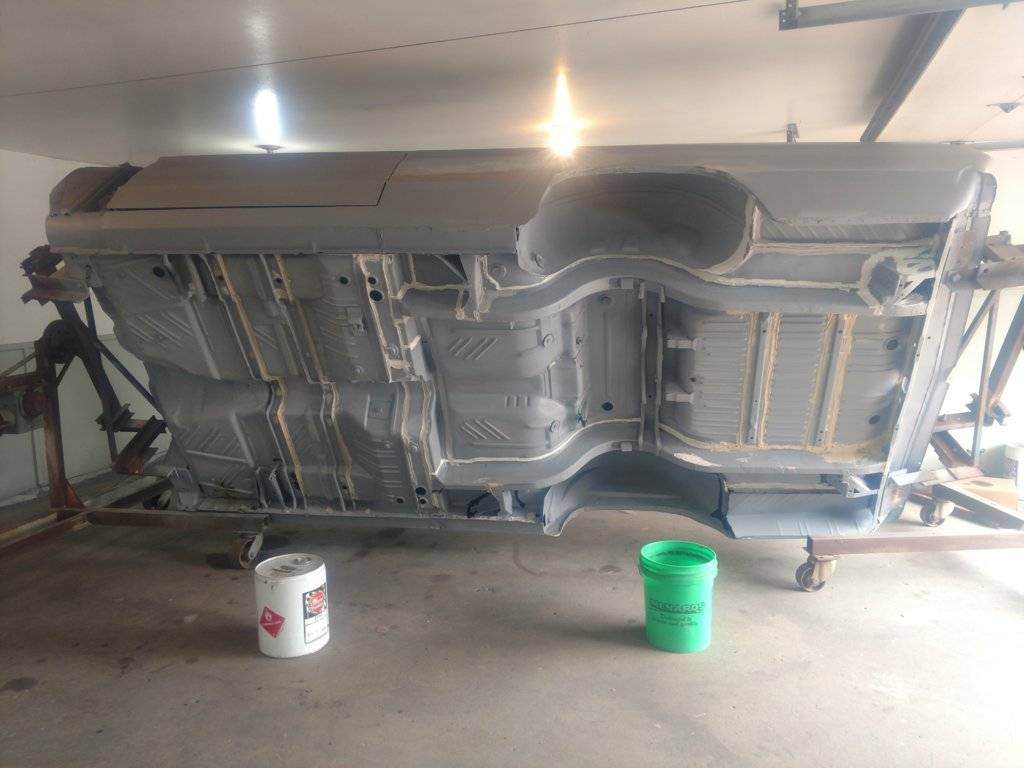

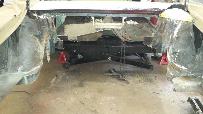

It's been a pretty hectic summer, but I'm back to working on the fury. Just about all the sheet metal is done. The entire bottom of the car was sandblasted. We then shot some epoxy primer to seal everything up. And using urethane caulking around pretty much everything with a seam. This car is going to be driven so this will help to keep dirt and whatnot from wedging itself between anything. It should also make cleaning the underside a little easier. We hand sanded the whole bottom to prep for undercoating. More to come!

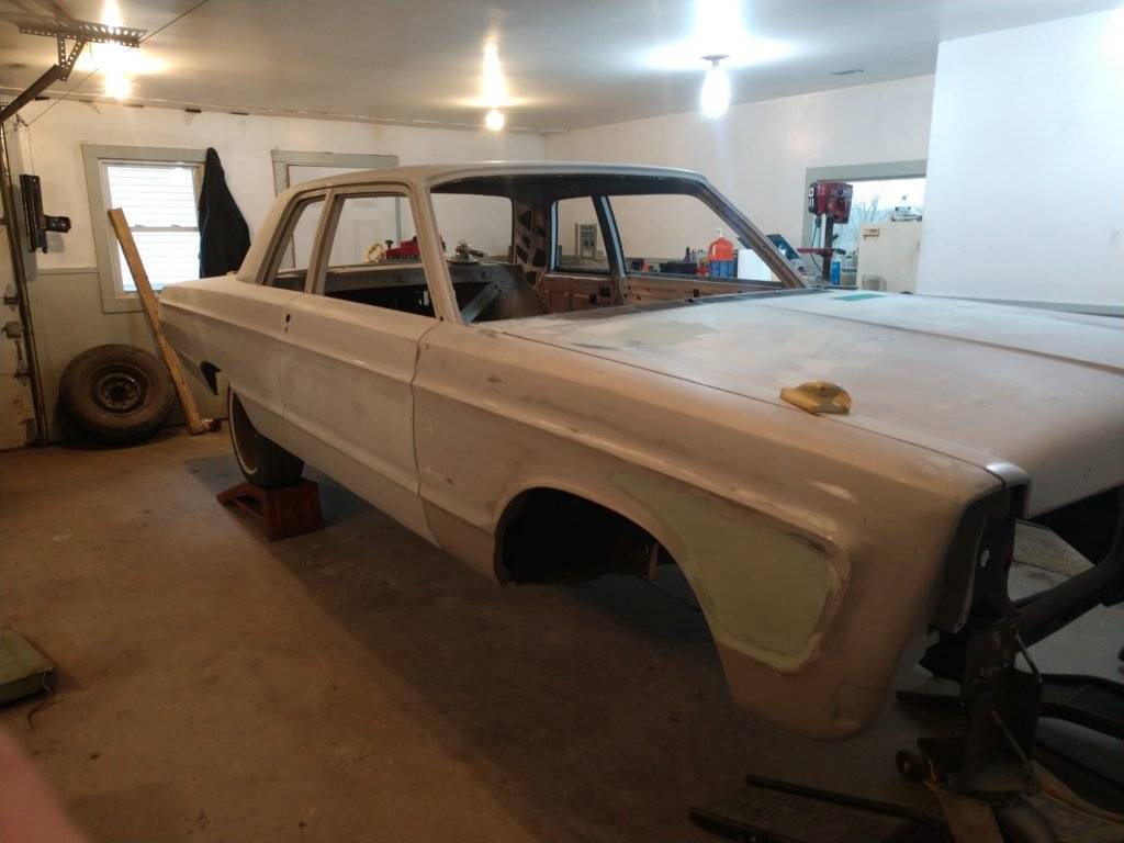

A lot has happened over the last few months. Bottom of the car was undercoated. Subframe and rearend were painted and bolted up. Front sheet metal is all on and lined up! Won't be long until it's in paint now!!

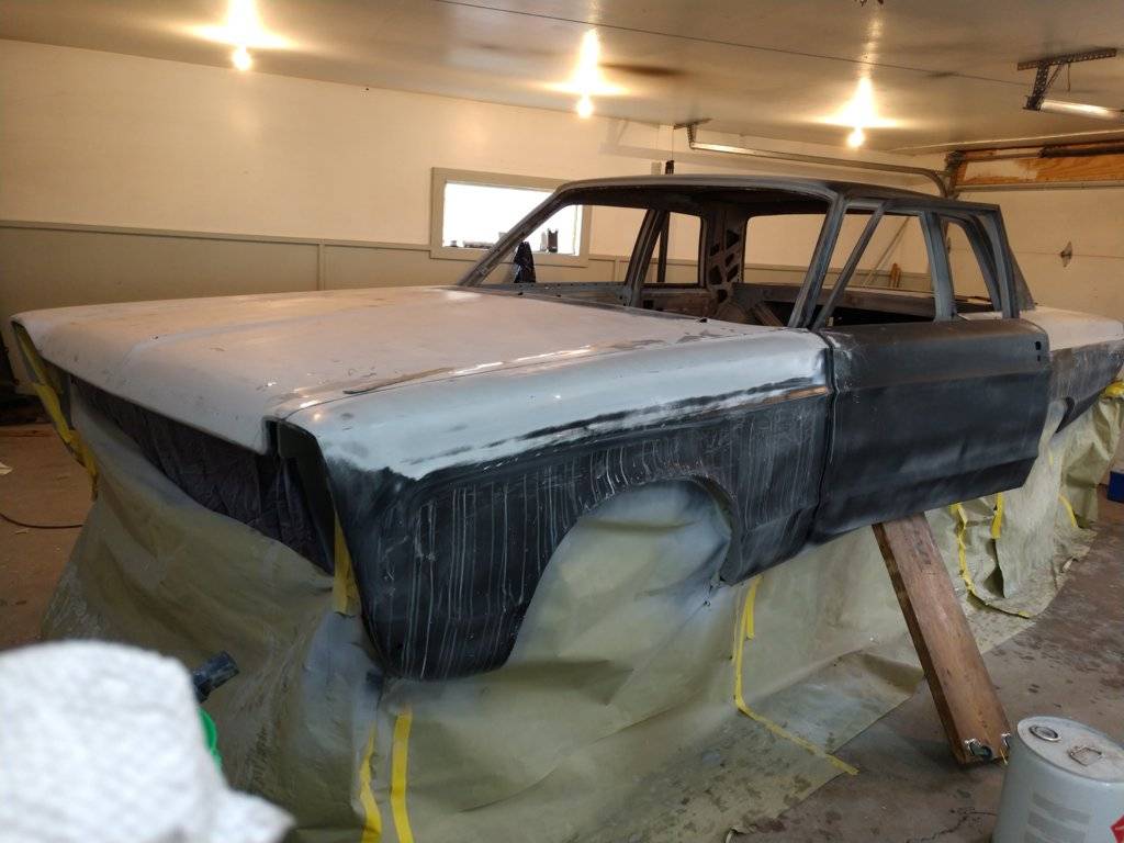

Wet sanded the car with 220 last weekend. One more coat of primer and sand with 400 and shell be ready for paint!! Can't wait to see this thing with some color!

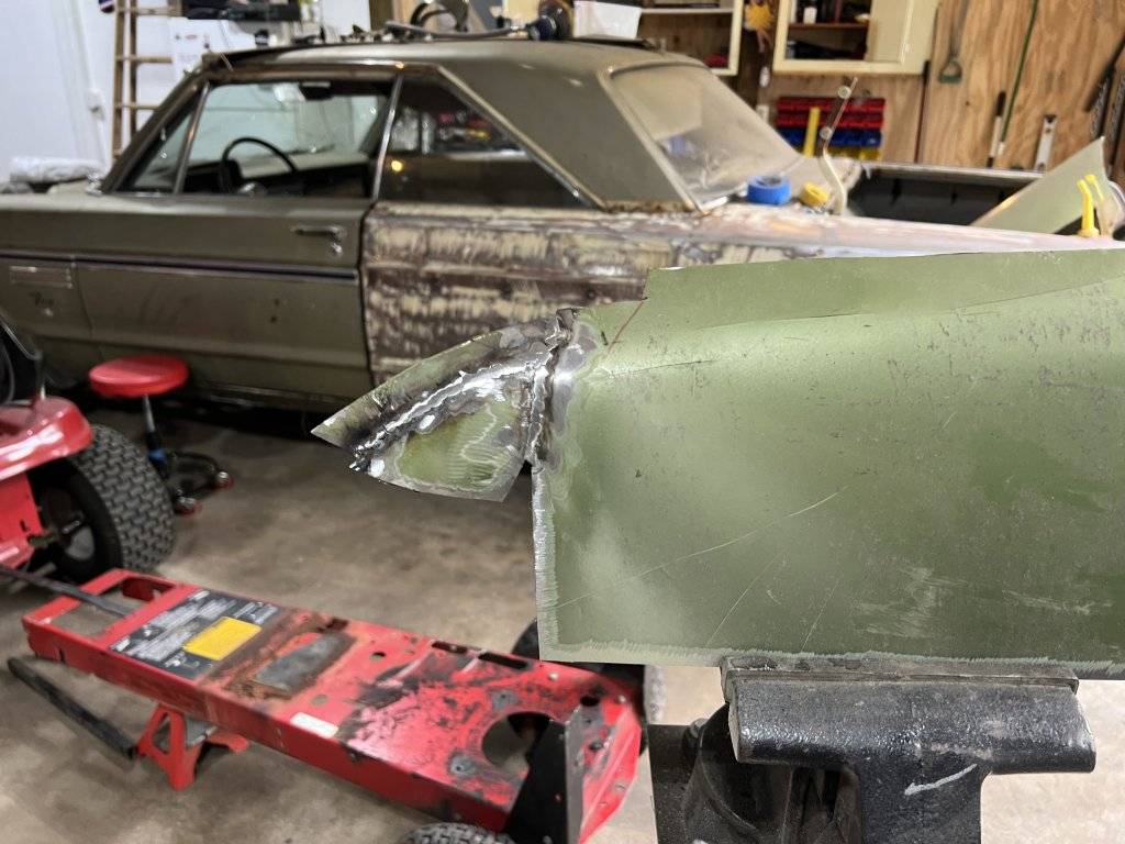

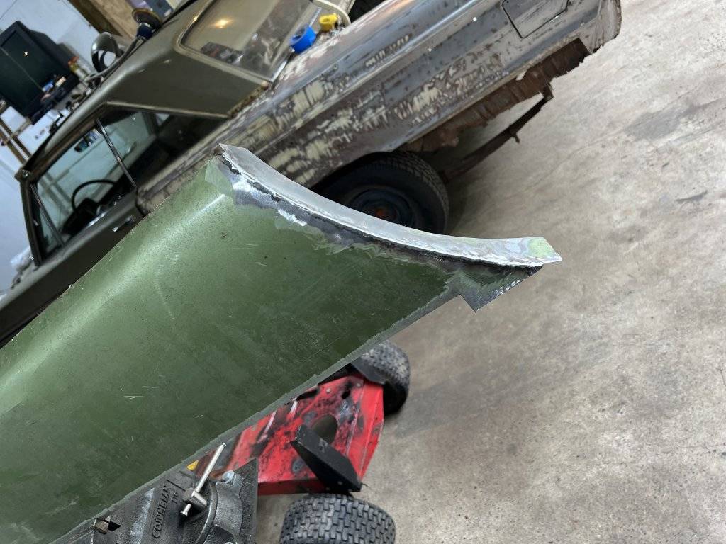

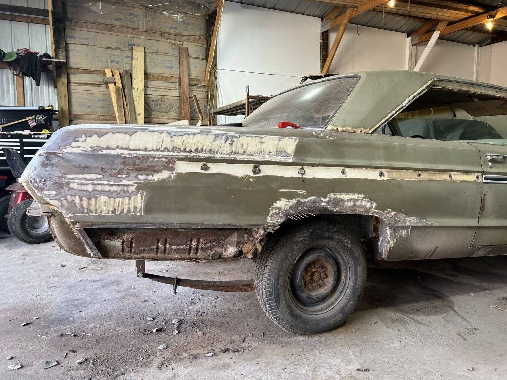

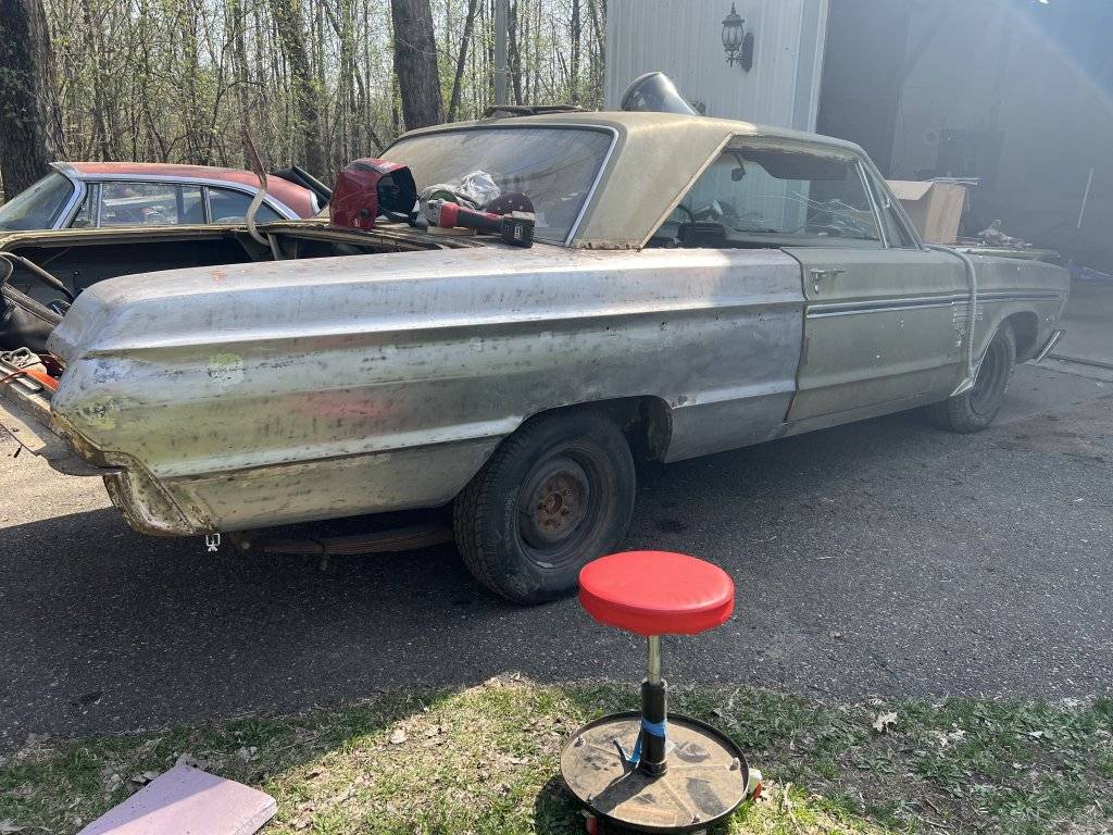

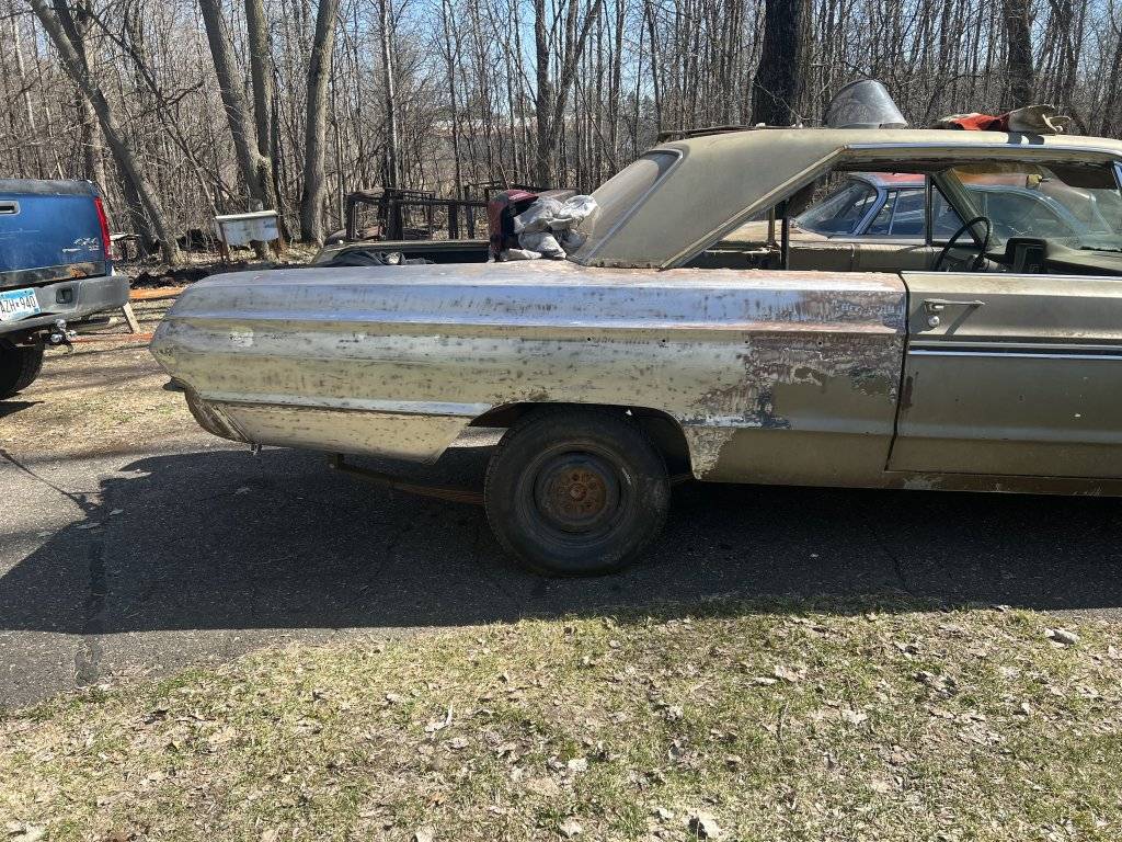

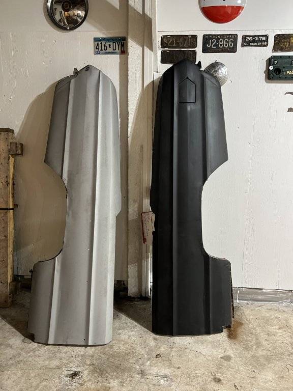

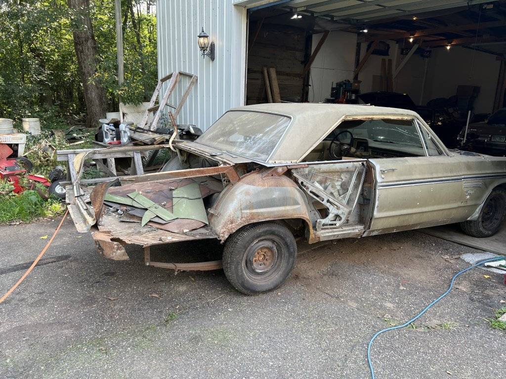

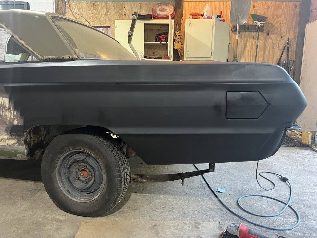

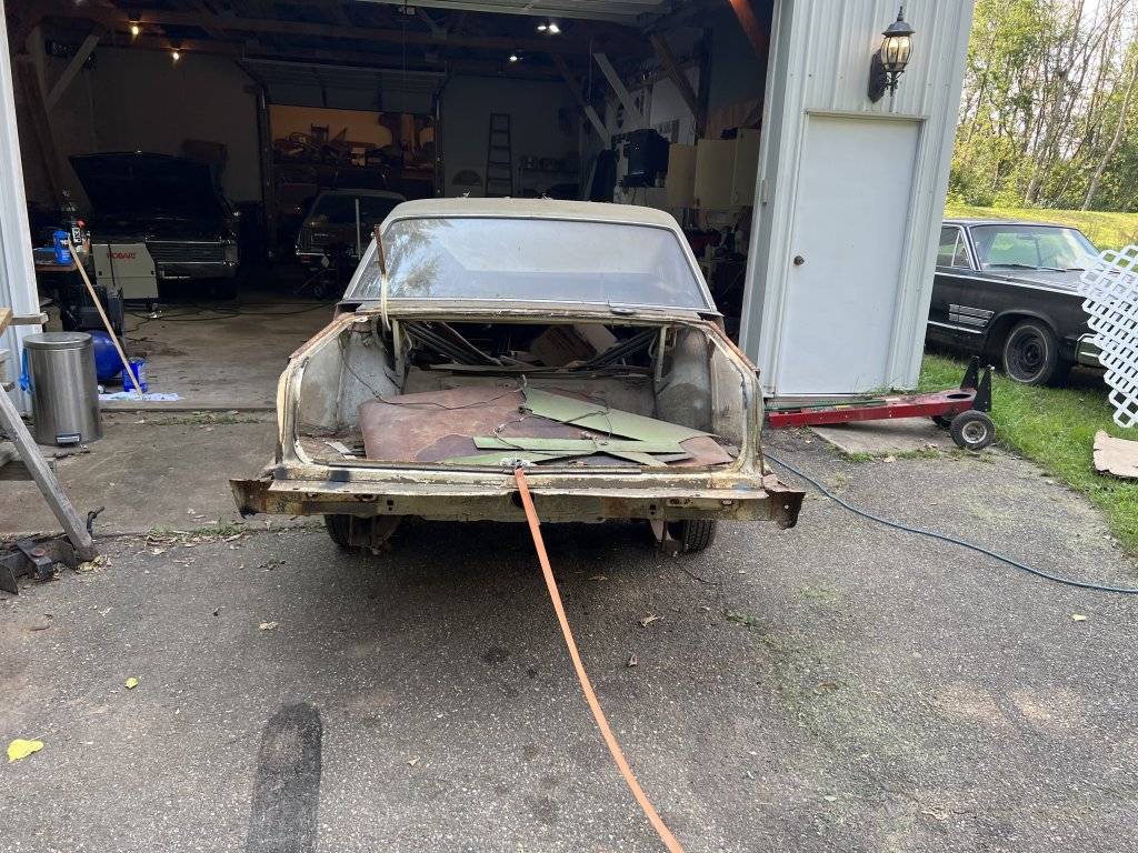

A little update on this project. It’s been a few years now since I’ve done anything with it. And those cheap quarter panel patches that we used just required too much messing around and there’s more filler material in the quarters than I am comfortable with now. So I located a half decent parts car from North Dakota with some okay quarter panels. Looked for close to a year for either quarter panels or an entire parts car that was rust free and I couldn’t locate one. So here’s the car I ended up with. I’ve been working away on the rust repair for a couple months now. Then I’ll be cutting the whole panel off of this car and using it on my 2 dr sedan.
Started working on the drivers side too! I hope to be done with rust repair this month to get the parts car out and free up space in the garage.

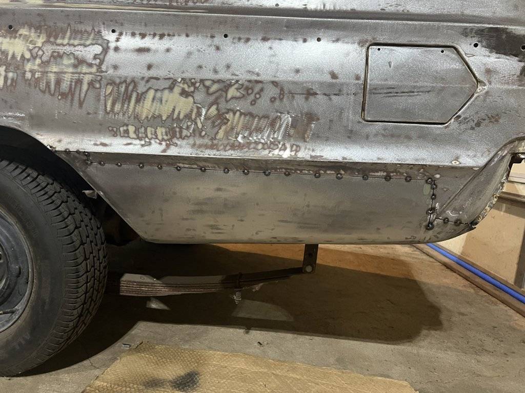

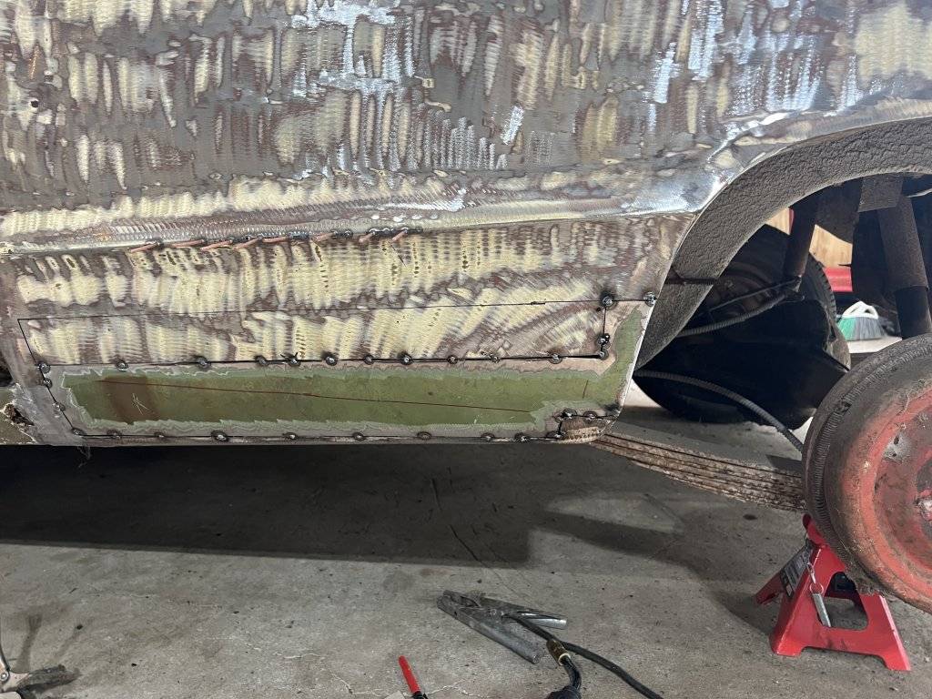

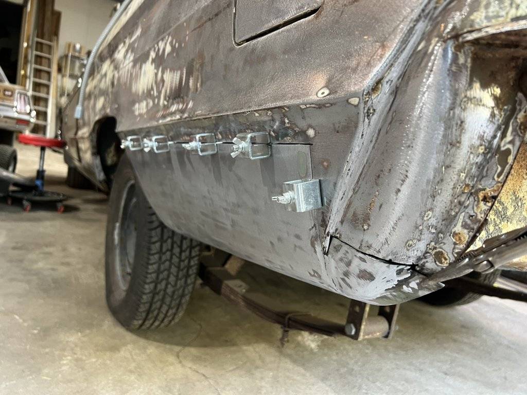

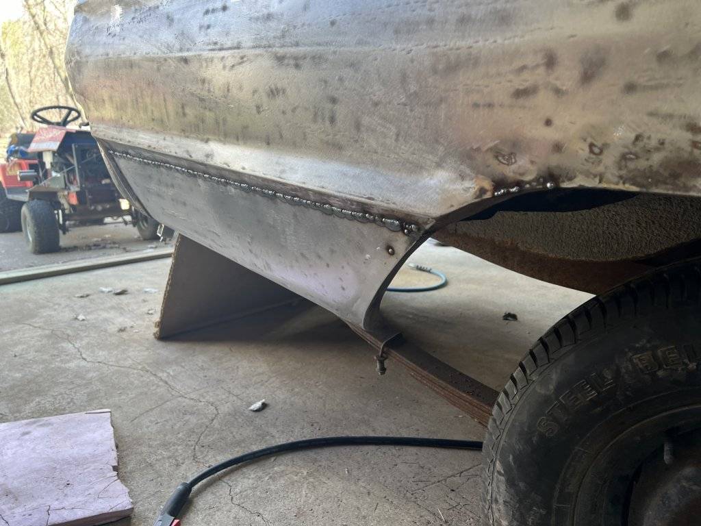

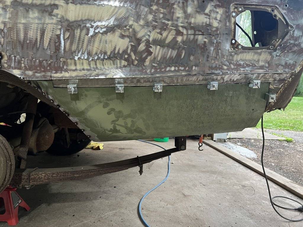

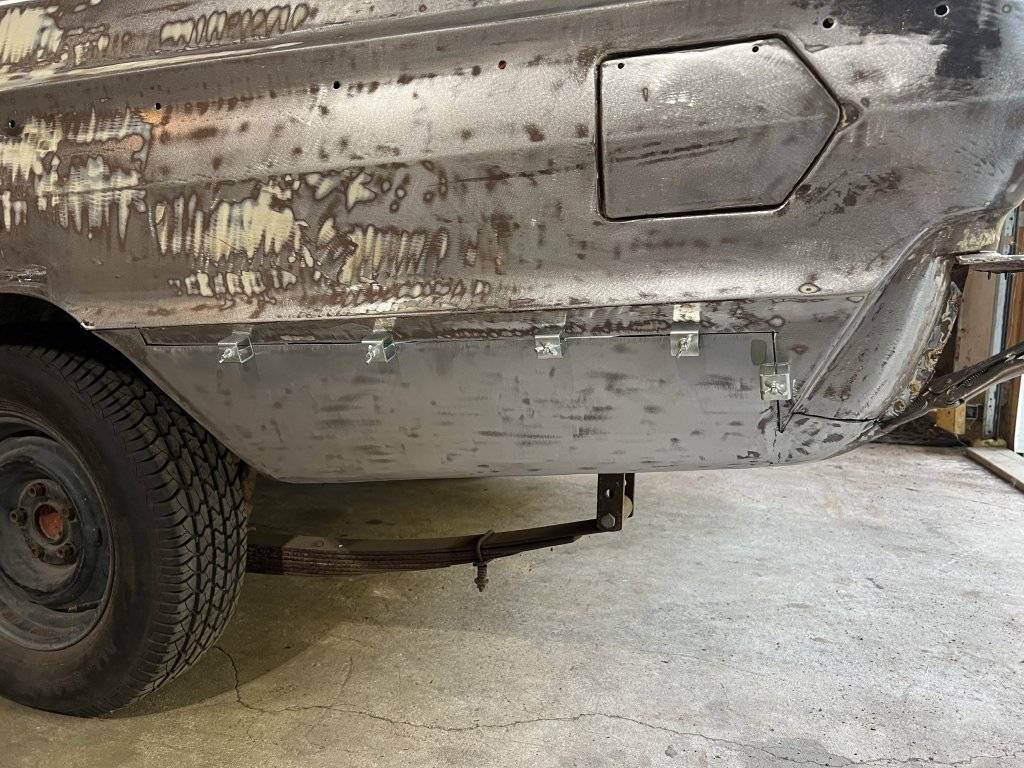

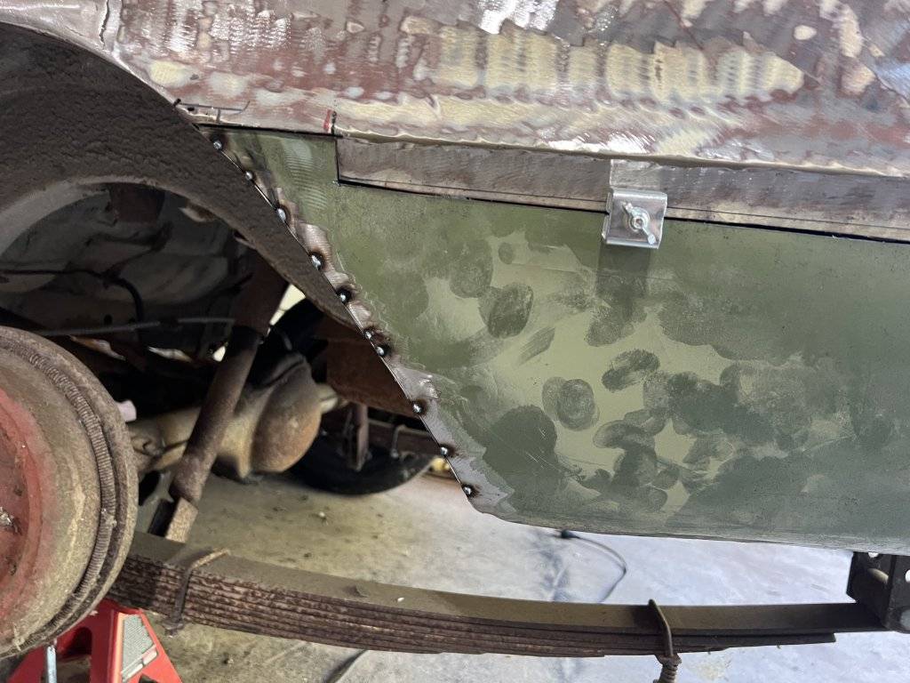

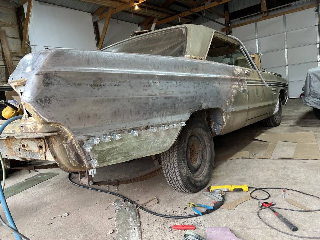

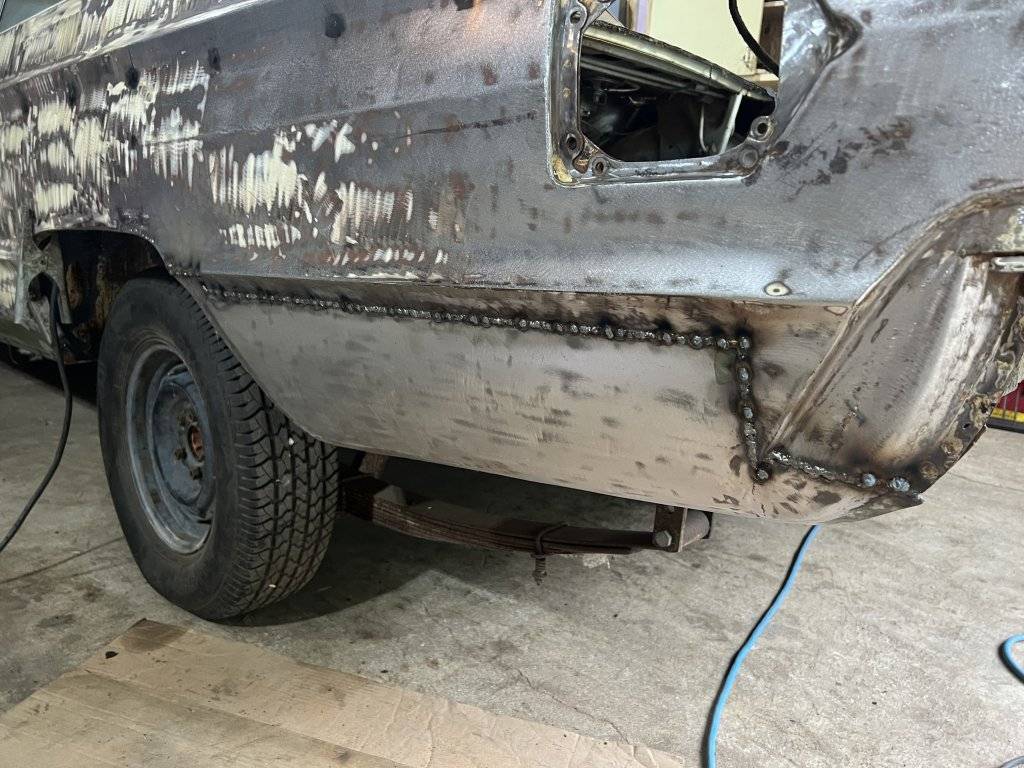

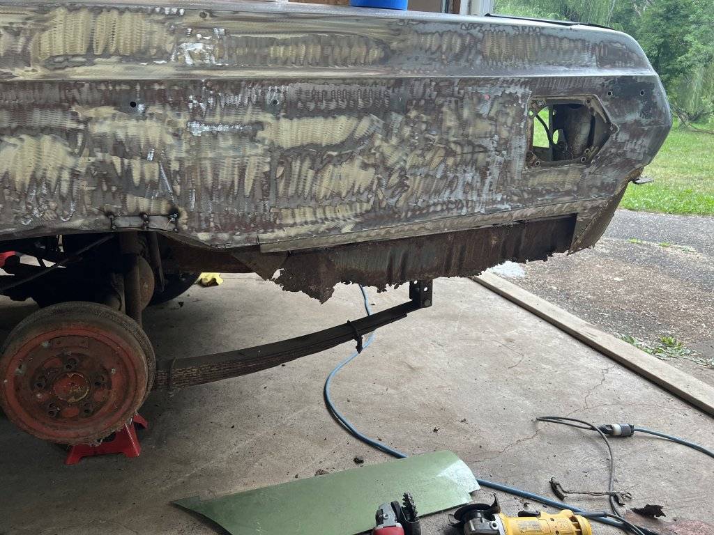

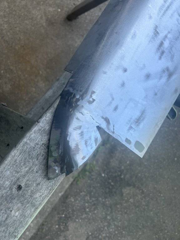

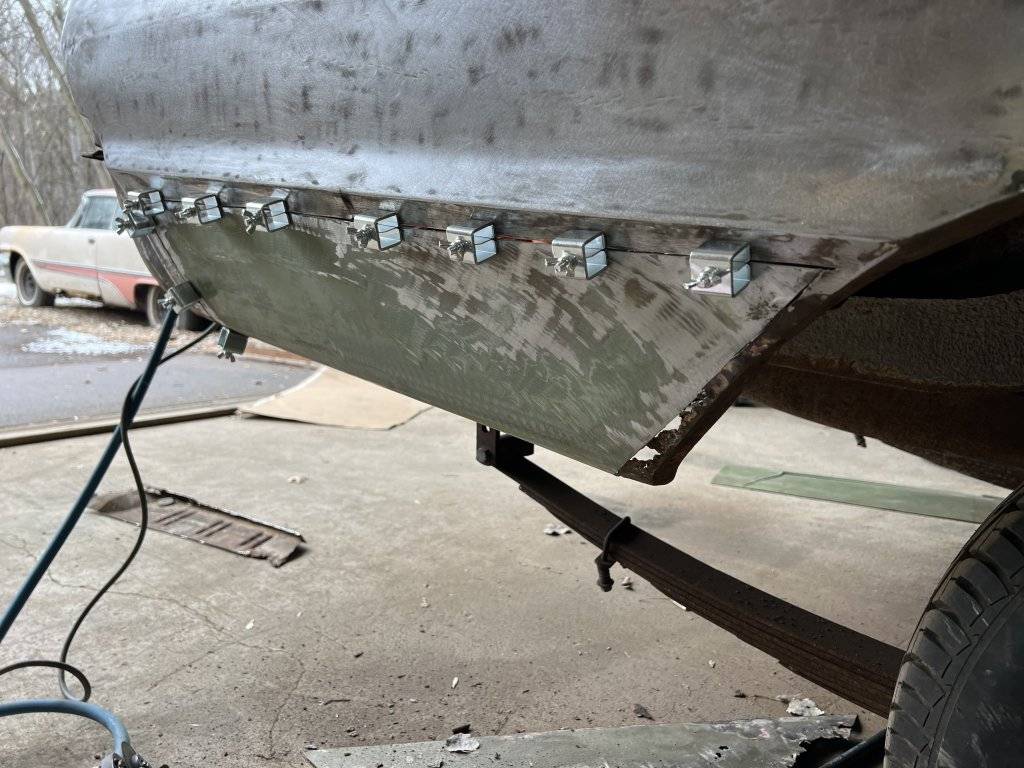

Little update. I’m pretty pleased with how this rear lower quarter patch is coming along!
Needs a little more grinding in a few spots. But getting closer! It’s going to need some hammer and dolly work above the wheel arches. After they come off I’ll beable to get those areas decently straight.

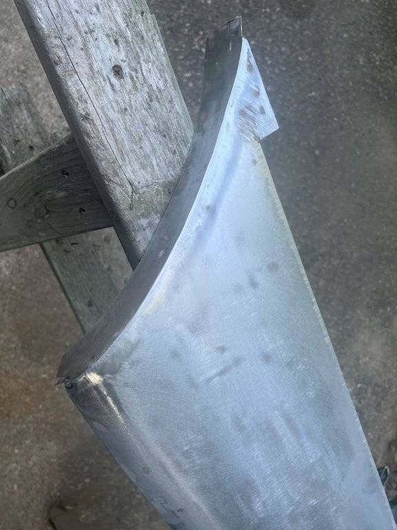

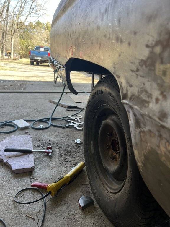

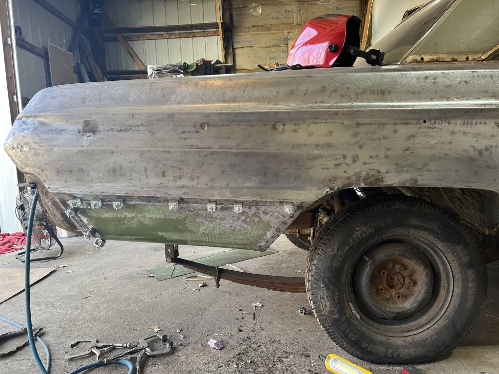

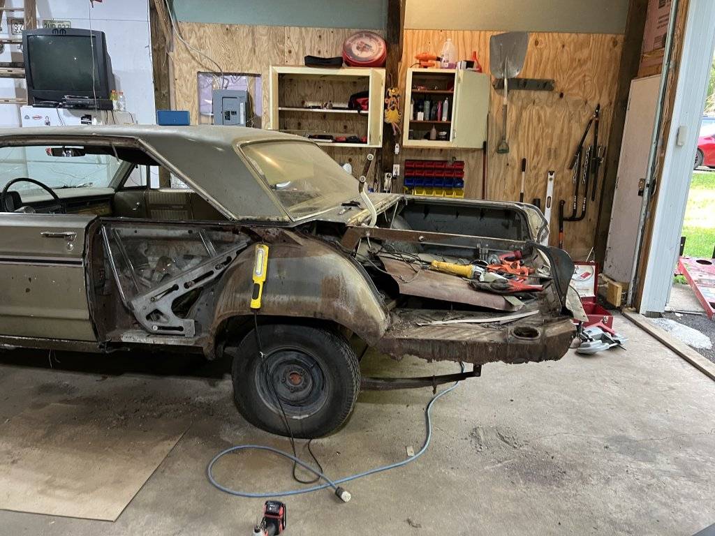

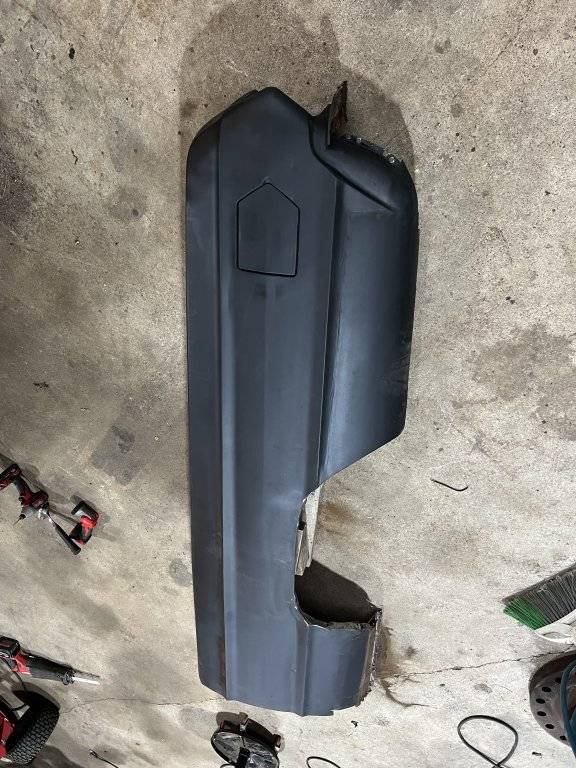

Made some progress today. Drivers side removed. Probably be two weeks before I get to the other side but I’m liking how it’s going! I’m also going to cut out sections of the inner fender well to use on my other car. While also “mini tubbing” it.
Got the passenger side quarter cut off today. Now I can get this fury 3 out of the garage and get cutting on the sedan.
