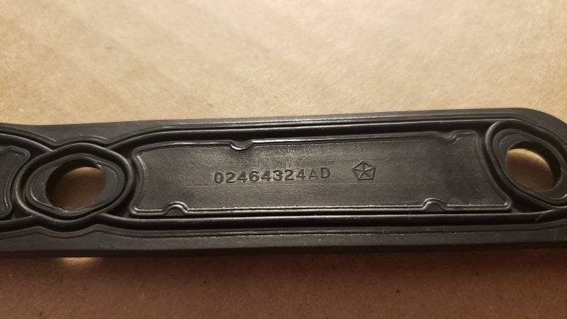

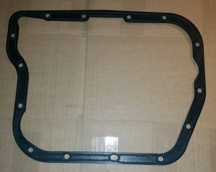

Assuming is a 727, a great pan gasket is Mopar Part #2464324AC. I know transmission builders that swear by them.

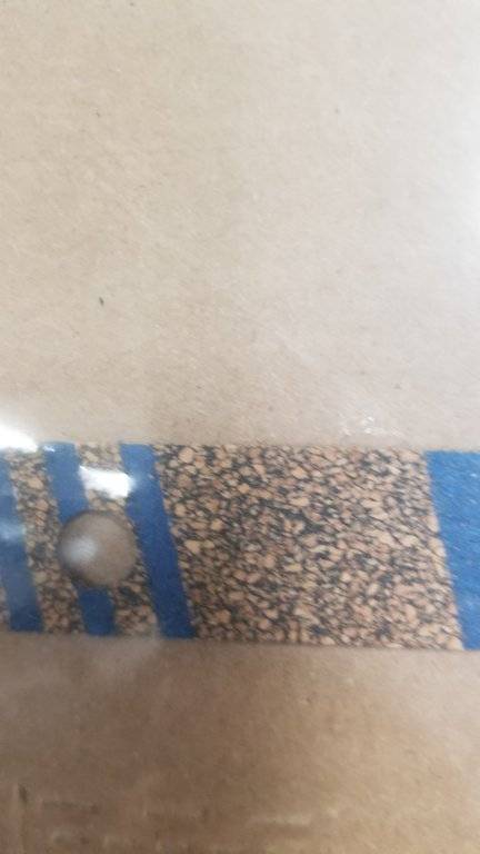

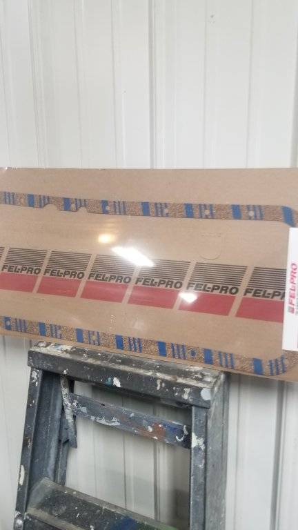

It is a 727. I've already purchased a felpro gasket.... good or bad???

The Fel-Pro gasket is a black leathery looking thing... Correct? Probably all folded up in the box too?
The Mopar gasket is rubber and steel piece of goodness that will seal and can be reused. It's heads above the Fel-Pro gasket.
The felpro looks like a cork and rubber mix. It's not folded. Layed out on cardboard.
