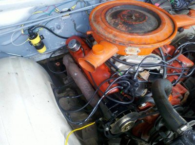

The purists are going to hate on me for this...but I recently did some upgrades to the '65. Today the Newport fired up for the first time in almost a year. It started with wiring issues and the alternator had died. The wiring was a rats nest complete with multiple splices and wire nuts. The Mopar electronic ignition is a good setup for the most part but it went away in favor of a homebrew HEI setup. It is much cleaner, no ballast resistor, no leaky spark box silicone on my firewall either. I also swapped the alternator for a one wire unit from JEGS. It took a lot of R&D to figure out how to mount this on a BB. This eliminated more wiring as well. I took a quick test drive up the road and the HEI setup did indeed outperform the Mopar setup. It idles smoother and it just seems to have more get up and go over all. Happy with it so far. If anyone would like advice on this or needing to see pictures, I will help all that can. I asked about doing these mods on a few sites and go a lot of flack and disrespect so maybe I can help someone else. While I was in there messing with pulleys and things, I did change my fan clutch, replaced the water pump and added a mini starter as well.

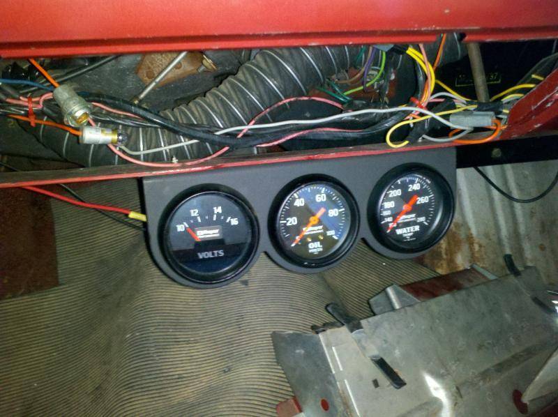

2014-10-03_15-51-32_583.jpg2014-10-05_18-42-16_882.jpgPictures of said progress. Installed some old school Mopar gauges circa 1989 or so. They are Auto meters with a Mopar decal on them but still cool in my opinion. Very happy with the alternator and ignition setup so far!
The engine is getting some blow by though...:(. I've put some serious miles on the car though in the time I've had it.
