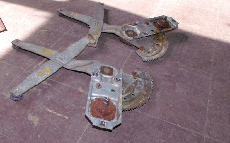

Hello all
i have recently made my first classic car purchase
I bought a 1965 fury 3 2dr and the previous owner
took out the rear window regulators..and bolted the windows shut... I want them to work again...so I got the left and right regulators but I can't figure out how to install them....I'm not sure if I'm missing parts or what can someone point me in the right direction?

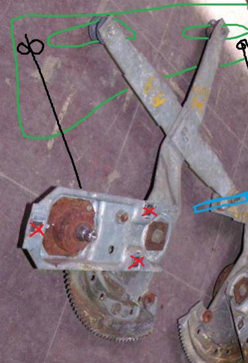

It's a kind of complicated mechanism, but maybe this will show the basics of how it works
There should be two vertical tracks for the window to slide up and down on, a long one at the very front of the window, and a shorter one close to the back. (the black lines)
The green thing is the metal part that should be attached to the bottom of the glass. There should be a roller assembly attached to the front of it with a pair of wheels that go over the front track.
There should be another roller assembly at the rear, it will have the two wheels that go over the track, and another one that can slide back and forth inside an openning in the green thing.
The regulator attaches to the body with 3 bolts where the red x's are
The small roller on the regulator goes back and forth in a little horizontal track (the blue rectangle) This keeps the two arms parallel when the window goes up and down
Finally the two large rollers on the regulator arms go through the other opennings in the green part.
Hope this helps some
