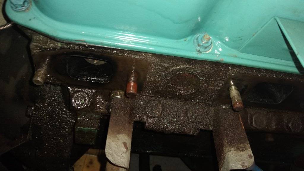

Went under the car today to clean a few things up and noticed a puddle of oil... Looked up and found this.
I can't tell if it's a blown gasket or hear from the exhaust blasting on the side. Also noticed my exhaust manifold is wet from oil soaking.
Before I tear into taking off the exhaust manifold, any thoughts on this by anyone. I'm by far no expert, but it looks like I need to buy some gaskets.
Exhaust leak is because one of the retaining bolts is missing the nut and has probably blown out the gasket (Note grey exhaust stain on engine block). Heat riser is missing some parts, spring for the butterfly it appears, so the heat riser is not likely working either. Oil leak is from the valve cover and oil is running down the side of the engine. Replace the valve cover gaskets. Also check the oil pressure sending unit for leaks and report back.

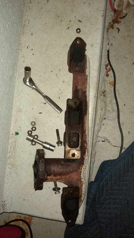

I took off the exhaust manifold as I figured I was there and I know these don't have gaskets...or should they?
Looks like you said, the valve covers are leaking. I've got oil on everything. Looking at the manifold to exhaust flange looks rough as well. Like he tried to make it work. The middle exhaust manifold stud nuts were super loose and had no torque on them. Jeeze .. laundry list of crap.

Mopar B and RB series engines do not use manifold gaskets as they are a precision fit. The heat shields should be left in place, they protect the spark plugs and the wires from degrading from excessive heat. Loosening or taking out head bolts runs the risk of breaking the seal between the head gasket, head and block. If you are still running a stock carb, the choke will not function properly if the heat riser is blocked open. If you have a manual or electric choke installed you can get rid of the heat riser altogether. There are rebuild kits available if you need to repair the heat riser.
