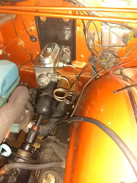

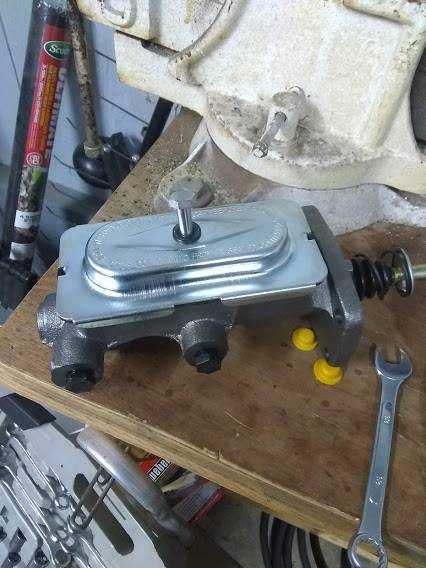

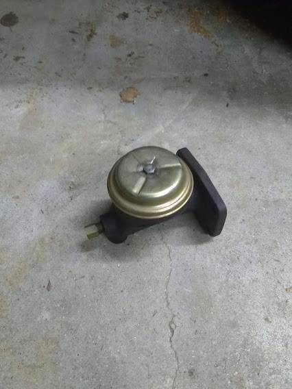

I changed out the single pot master recently
Bench bleed and ready to go
Installed and 2 new lines made.

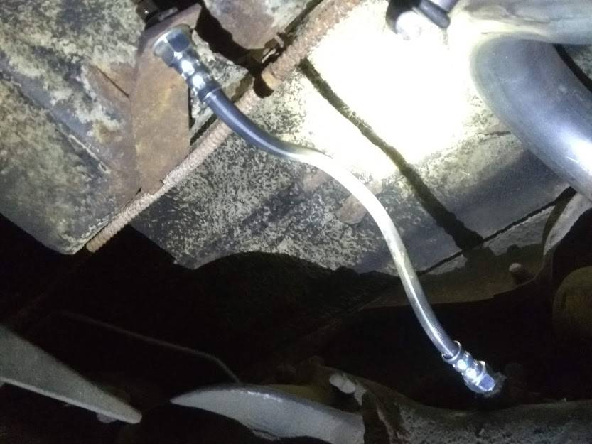

Started bleeding the brakes at the wheels, RR first then LR and lost all fluid to LR????
Did the front brakes and came back to the rear, it had fluid at the master, cracked the line at the rear hose and I have fluid. So I ordered a rear brake hose and swapped it out. Bleed the rear brakes again and now were happy, all the brakes have fluid.:)
New hose

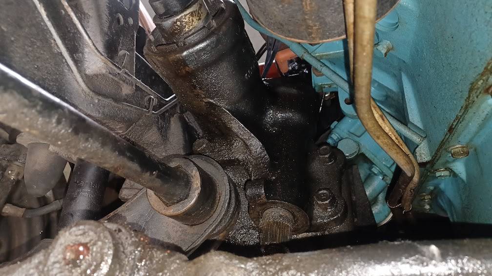

The old box with the pitman arm removed

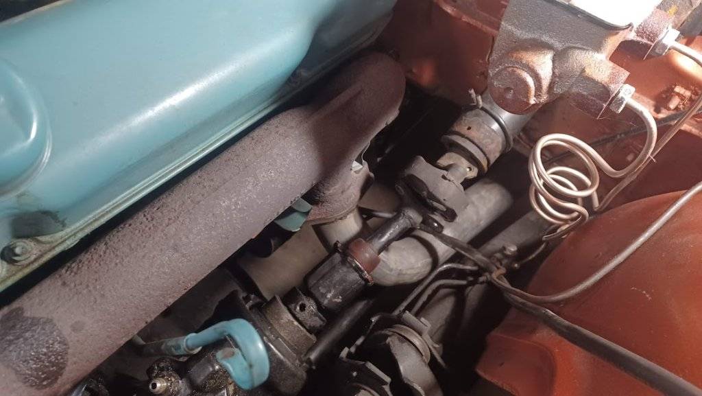

The box with the hoses removed and the lower column shaft removed at rubber coupler

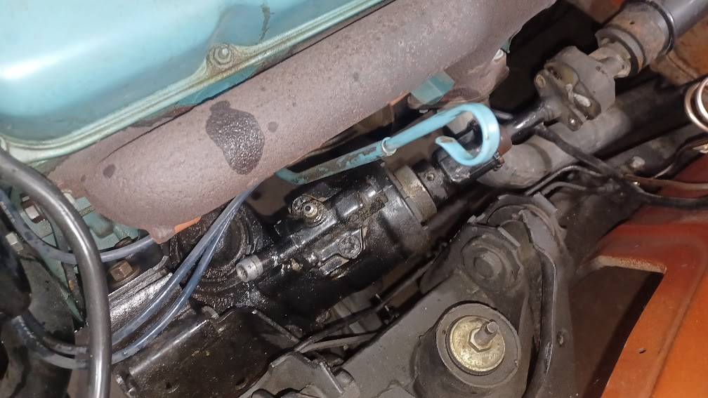

I had the box and the steering shaft installed at this point and I was putting the P/S pump in place. I then found out the pump doesn't clear the 1 year only 65 big block LF motor mount
The pump is still loose and I haven't even tried the pressure hose yet

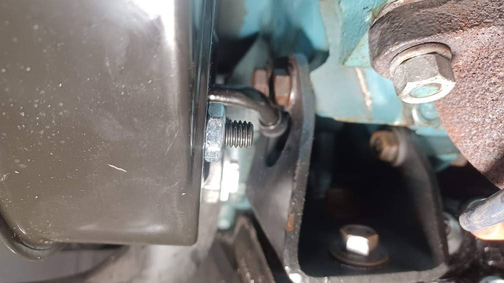

I modified the LF motor mount to clear the pressure and return lines. I didn't get a good pic of it because I was just zoned out on getting it finished. This is it reinstalled

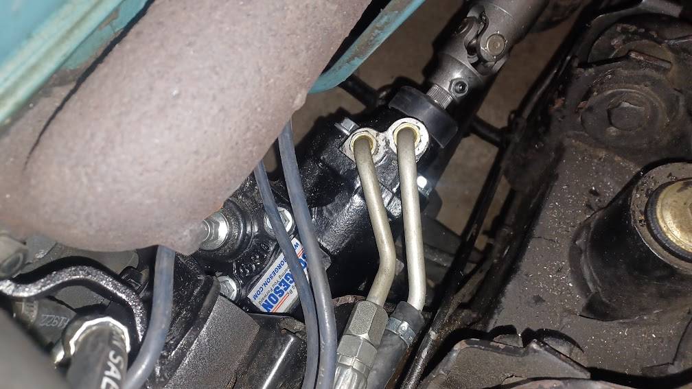

The box with lines and the shaft installed. You can see part of the modified mount at the pressure hose

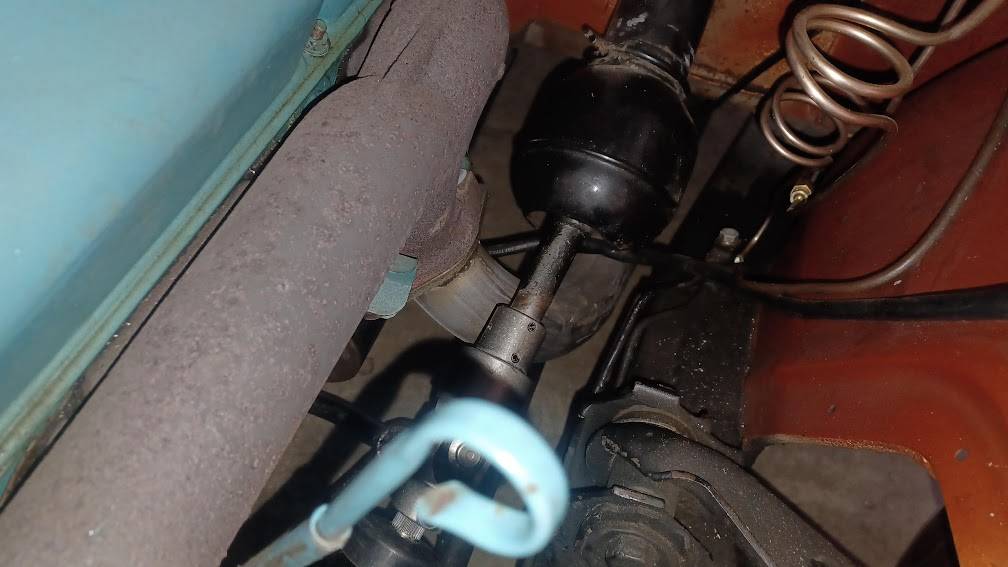

The steering shaft with the cover reinstalled

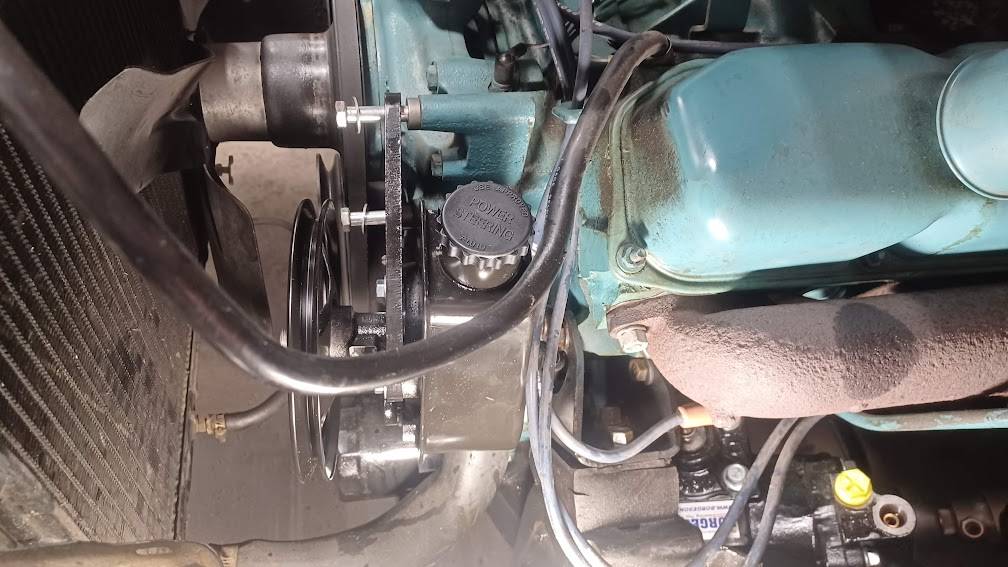

The P/S installed, belt tight, hoses on and the engine is running
