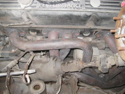

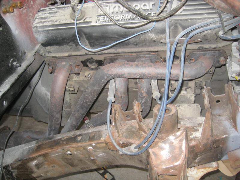

couple of pics of my 100 dollar craigslist headers. they need to tweaked a little more and then they'll be off to be cleaned up and ceramic coated.
What are those supposed to fit? You don't know a part number do you?
i knew that question would come up. I have no idea and neither did the guy i bought them from. They were on a 67 Charger with a 440. So they were close to being dented in all the right places. he wanted 200 for them and I got him down to 100 since he didnt know the brand, model, ect. I figured for 100 bucks if they didnt work I could easily get rid of them.
I talked to a guy on cbodydrydock (dacuda) who has a 66 Fury w/440. He said just about any B-body headers for a 440 will work. They just need to be dented in all the usual places. He used Hooker Super Comp headers. He had to bend them up a bit on the passenger side because they sometimes rattled on the torsion bar. Then I think he wrapped something around the torsion bar.
Pass side looks like it fits good, drivers looks like some clearance work is needed, nice find

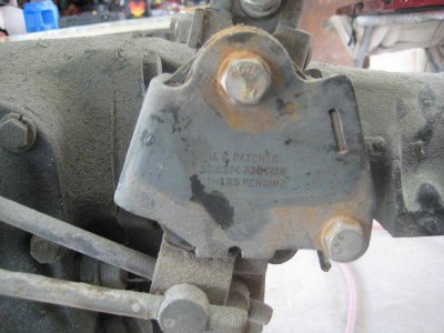

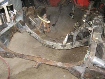

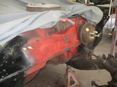

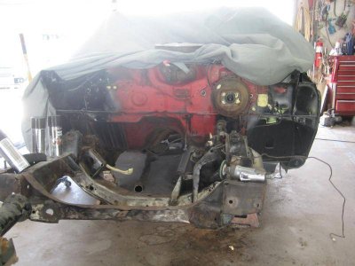

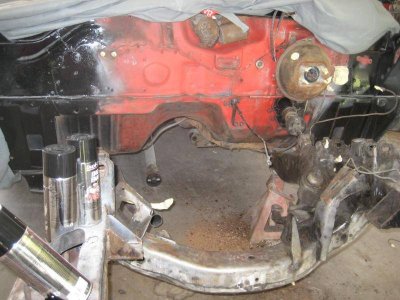

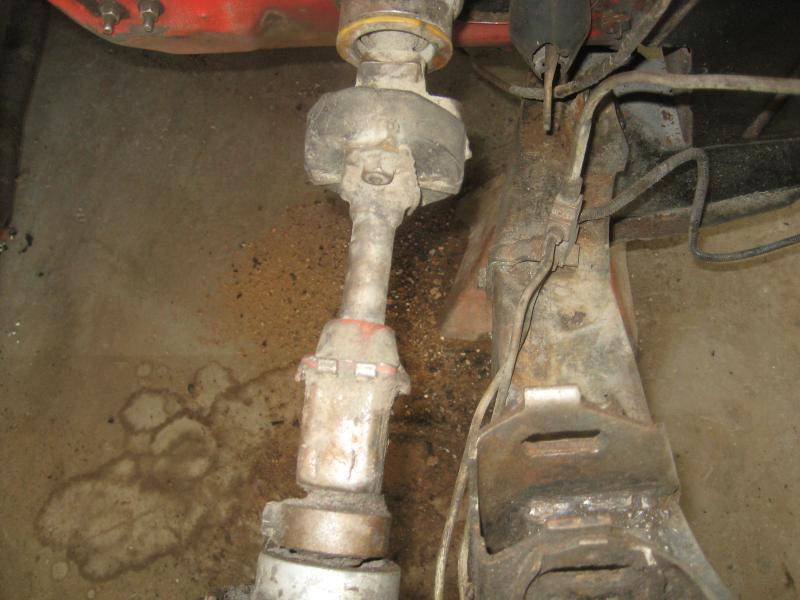

Not much of an update. Here are some pictures of the subframe and firewall. The engine and trans were pulled to be able to paint all sides of the subframe. I'll be getting new motor mounts from Schumacher (engine-swaps.com) with poly-locs. They have a solution for 65 C-bodies that they don't advertise on their website. I'm going to ask them if they wouldn't mind if I post the solution here on this forum. Since it's an unadvertised offering I feel asking them if it's ok rather then just posting it. The solution deals with B/RB blocks that don't have the necessary mounting bosses for the motor mount. I am also looking to replace the lower steering shaft setup with some u-joints and a a shaft. I'll also need to check the end of the steering column and replace the pieces at the end to reduce steering shaft movement as well.
anyway some pics to pass the time.
Well that's just plain silly of them unless it's in the prototype stage and they are waiting for feedback first.
