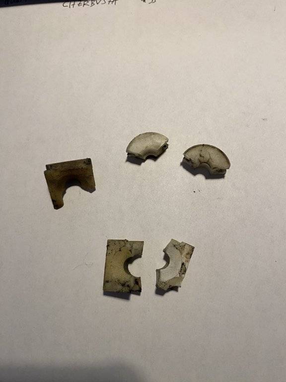

darth_linux
Oct 9, 2022
402
356
Spokane, WA
Well, I now know why my quarter windows don’t roll down. Looks like between the window seals, repair kits and cat whiskers it’s gonna be $350 to get them working again.
