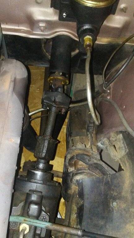

Can anyone else pull the heat shield off their C body (close to '66 as possible) and see how much angle there is there? Mine has like 5 degrees. I don't see any way it could be different and still make it's way to the steering box. Pic is of mine so you can
see the angle.
