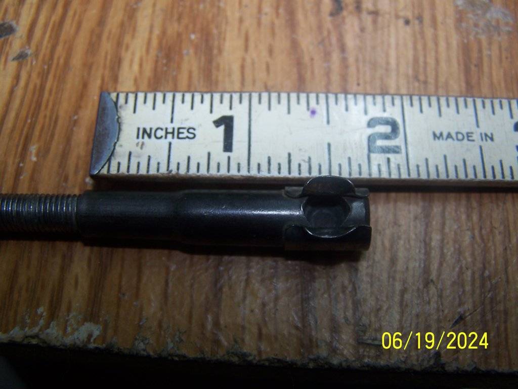

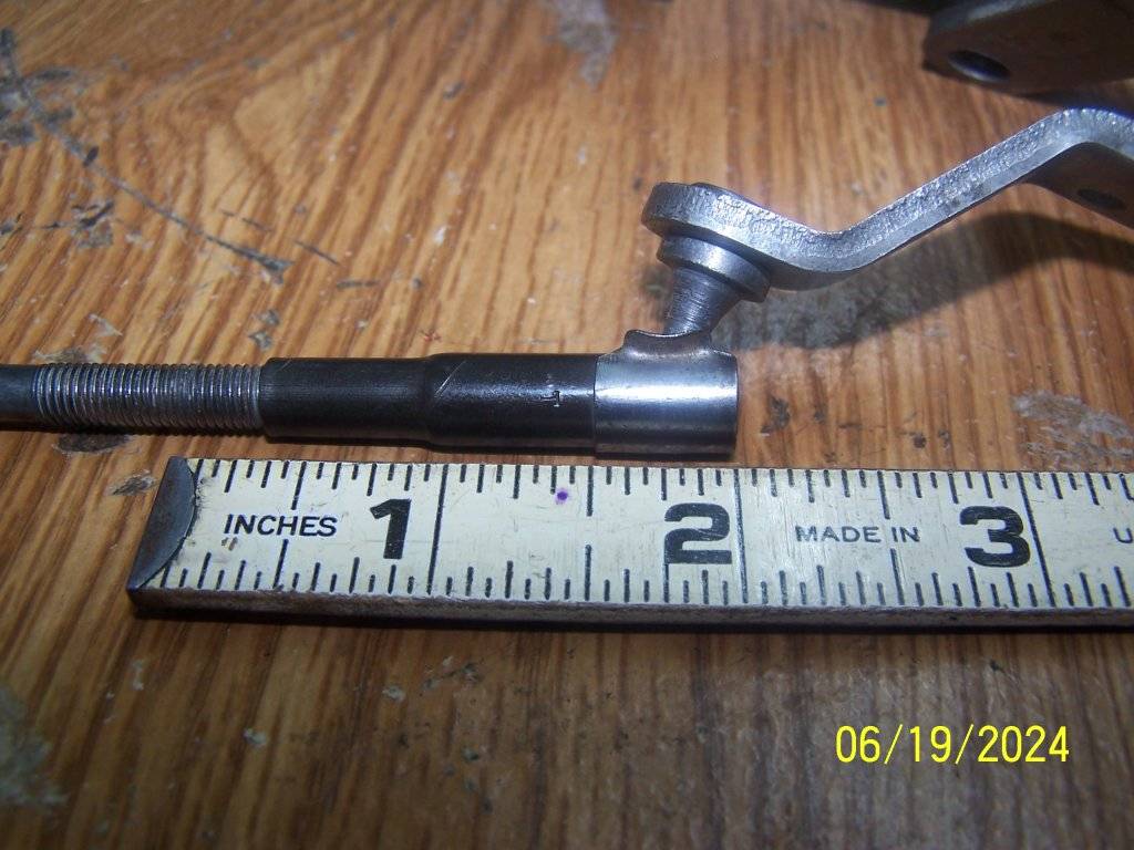

I just adjusted my kick-down linkage on my 65 Sport Fury a couple weeks ago. The service manual tells you exactly how to do it. If yours is set up properly and the rod falls off of the ball, you probably need a different rod. I have a couple of them. I believe they were the same for 383 and 440.
Maybe all you need is the threaded connector shown in this pic.

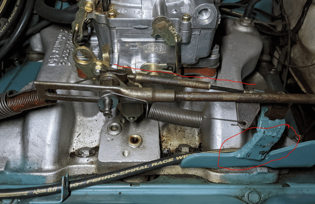

I glanced thru for the answer, didn't see it - have you extended your throttle linkage bracket, or does it have an aftermarket one?
My throttle cable did not align well on my 440 with the regular Performer manifold (so I welded a piece into it), I suspect the RPM manifold would be even worse.
It might be putting some extra 'stretch' into the KD linkage and cause the pop-off.
At the very least, your throttle cable should be verified to be pulling straight toward the throttle arm.

Good morning, fury fan. Yes. It is the same intake as yours. My bracket that holds the acc cable is stock for my car, with an additional ~1" raised base for the clamp (added/bolted a steel bracket). There is just enough thread on the KD rod (Mine does not have the short spring attach midway on the rod. I have the longer spring to the top bell crank.) to meet the FSM requirement for the 2-turn adjustment. I will revisit that. Hmm. Thank you.
