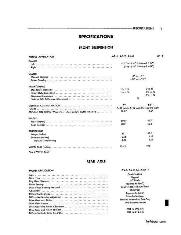

hi, ive got my 66 service manual, and it talks about adjusting the torsion bars to control the front ride height. I'm wondering how much I can crank them to get the front to rise. I'm either an idiot, or the front height is not in the service manual. all I know is that my nose sits about 3 inches lower than my buddies 67 newport, and I like the way it looks for his car. the bottom of my front bumper is about 9 inches off the ground, and the tops of my wheel wells are 24 inches off the ground. thanks guys.
