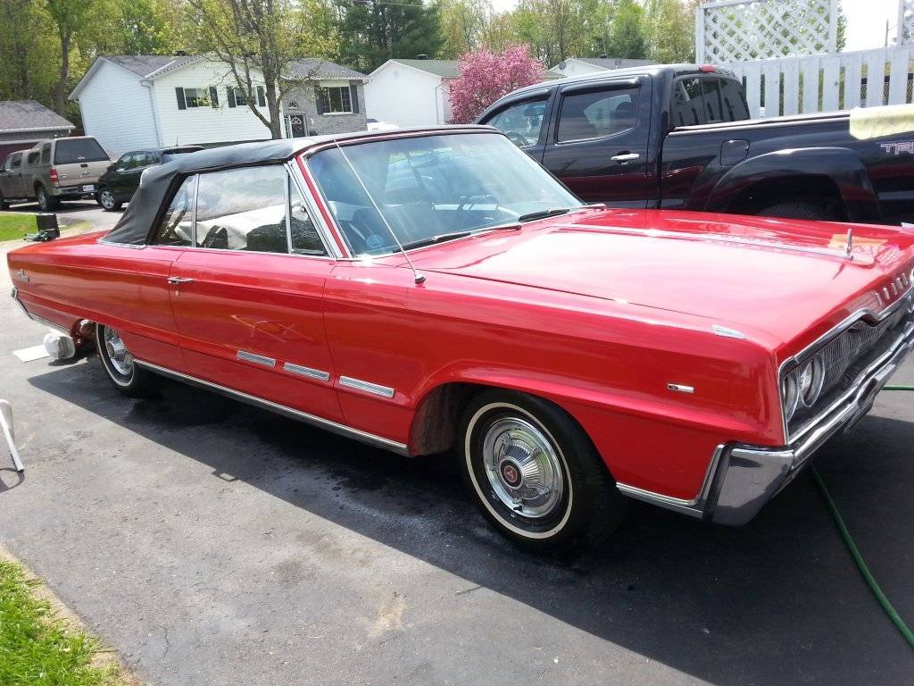

looking to replace tires and wheels on my 66 dodge monaco. tires are 10yrs or so old and the steel rims are original as far as I know. this was my dads car(original owner)
It appears that steel wheels for this car are not easy to find.
wheel size is 14 x 5.5
bolt pattern 5x4.5
OEM tire size 8.25x14??
which i believe equates to a P215/75R14 or P225/70R14
1. first things first, can someone please confirm original tire size for this car. is it 8.55x14 or 8.25x14? info i have is conflicting.
2. i have P215/75R14's on the car right now but i find them to skinny. need a wider profile tire to improve handling.
What are you guys running for tires on a car like this or a similar car. ? I think i prefer a whitewall tire which might limit my options.
3. For Wheels, can you still get 14" steel wheels with a 5x4.5 bolt pattern for this car. I still want to use the original wheel covers.
Im also open to an aftermarket wheel tire combination that have the classic look, maybe chrome spoked wheels might look good with white walls.
Im also looking in parallel here, interested to see what other people are putting on their monacos and fury's and other similar cars.
thanks
glen

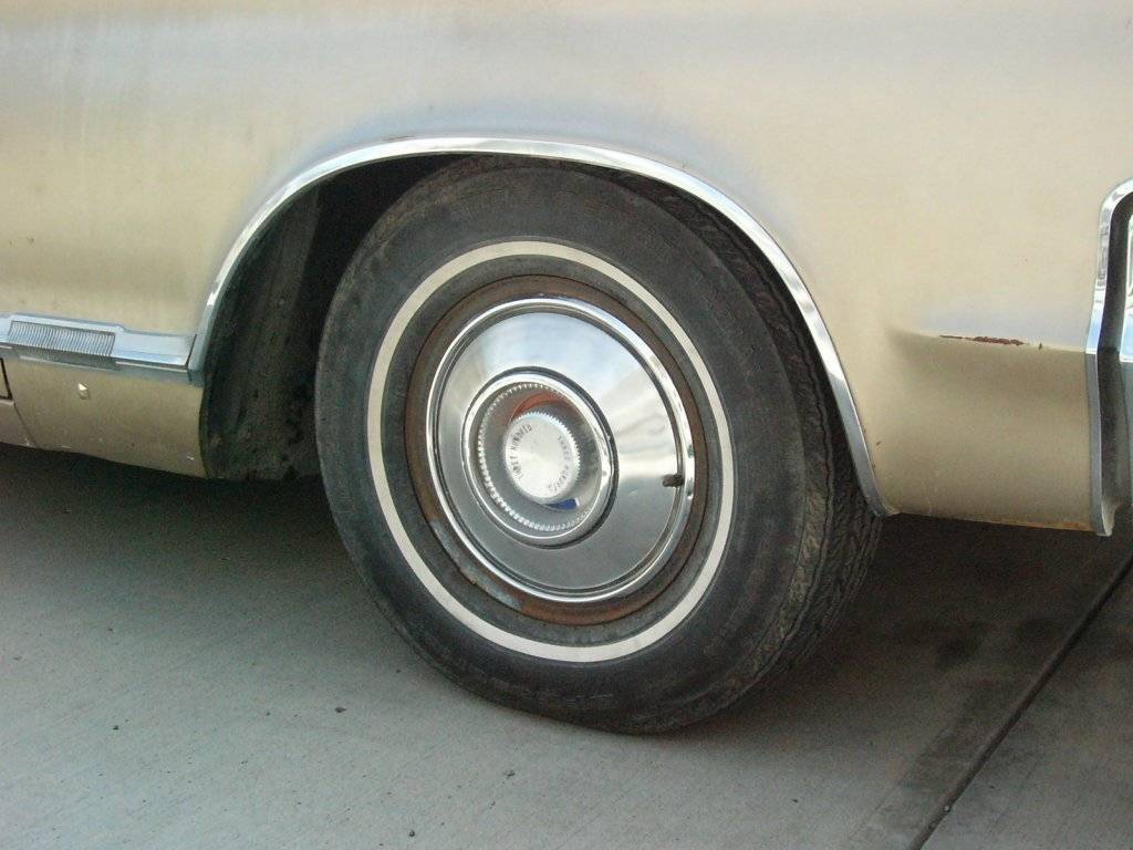

14" tires in a size suitable for a C-body are $$$ Coker reproduction.

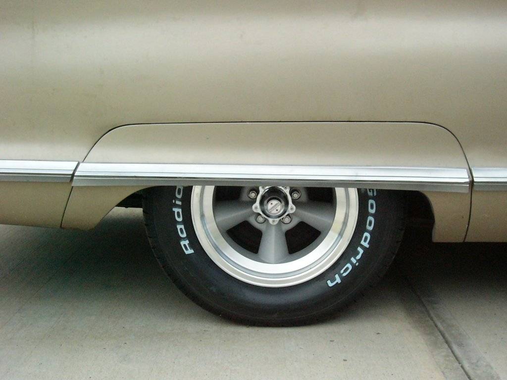

If you plan on driving the car more than looking at it then it's time for 15" in a 235/70 or 235/75 on 4 corners or if you need some traction, 275/60 on the rear.
If you like the stock "correct" look, you could try and find some original disc brake hub caps and a set of steel 15" rims off just about any Mopar or go with Wheel Vintique repro steel wheels in 15x7. I prefer 15x8 with a 275/60.
If you can find a set of C-body Road Wheels, they look good too.
While a Magnum 500 type wheel wasn't available on a 66, they do look like they belong. These are 15x7 with 235/70 all around.

Ran into the same problem looking for 14" steel rims for my '66 while restoring the originals. Most did not have a large enough center bore. Believe it or not trailer wheels come in the original bolt pattern and 14"x6". Found some for $40 ea. Mounted hankook optimos 225's. Largest available in a 14" without going to Coker. Going to 15" will give you many more choices.

So with these trailer wheels, I can still install wheel covers? the rims are essentially the same? Are they meant for passenger vehicles? I'm just curious why they are available for trailers and not listed for passenger vehicles. Sounds like they are working for you.
And thanks for this info. this is a little frustrating nailing down some rim and tires for this car.
15x7 Magnum-style (as said above, wrong but very appropriate) with
235/75-15's.
Will look great, be appropriate, won't bankrupt you, leaves you open to more options down the road.

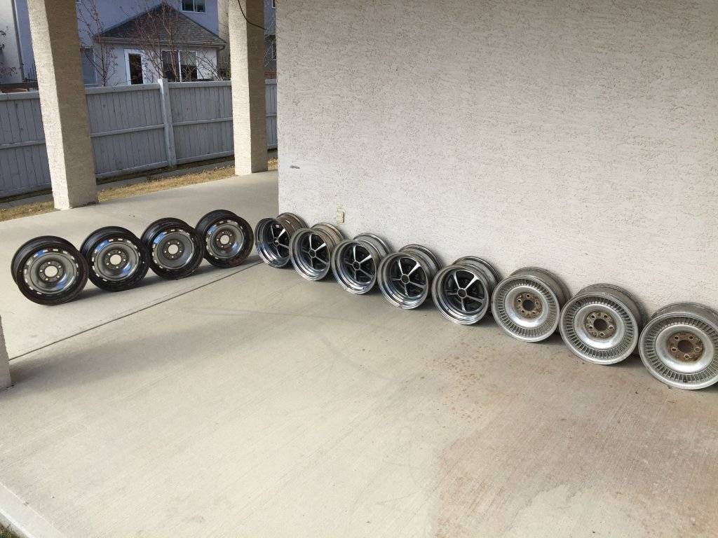

Ya I wanted to keep the factory look while i restore the originals but ive come across a few sets since that i may upgrade to.
Road wheels on left magnums in the middle and 79 Cordoba rims on right so have to decide which to use
