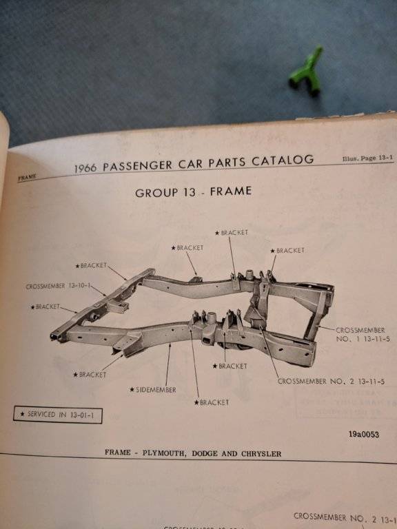

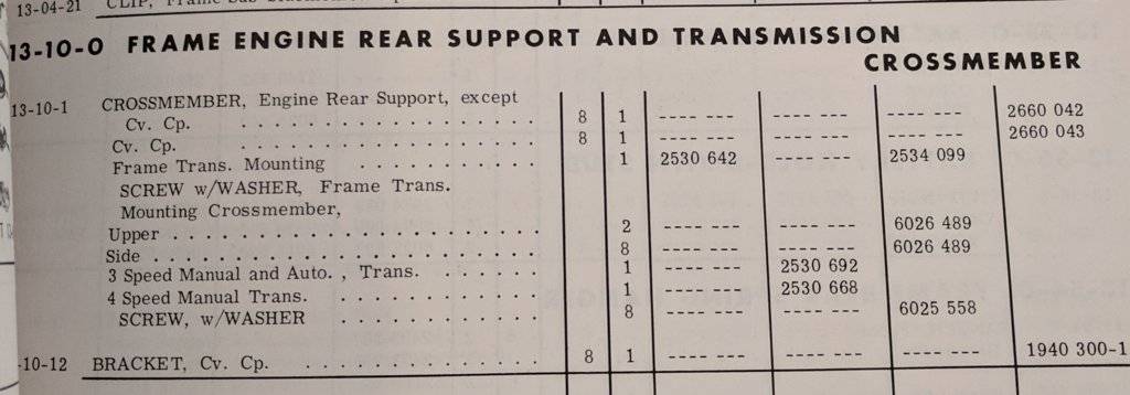

If you can wait til tomorrow, I can get the part numbers, I don't think I'll have time here's work to look through the digital version. My book is very easy to get to in my basement.
The transmission crossmember is the same for all cars and any transmission, just the mount differs.
Crossmember 13-10-1
Frame Trans. Mounting
Different p/n in 65, the cross member may work but I dunno if it would.
