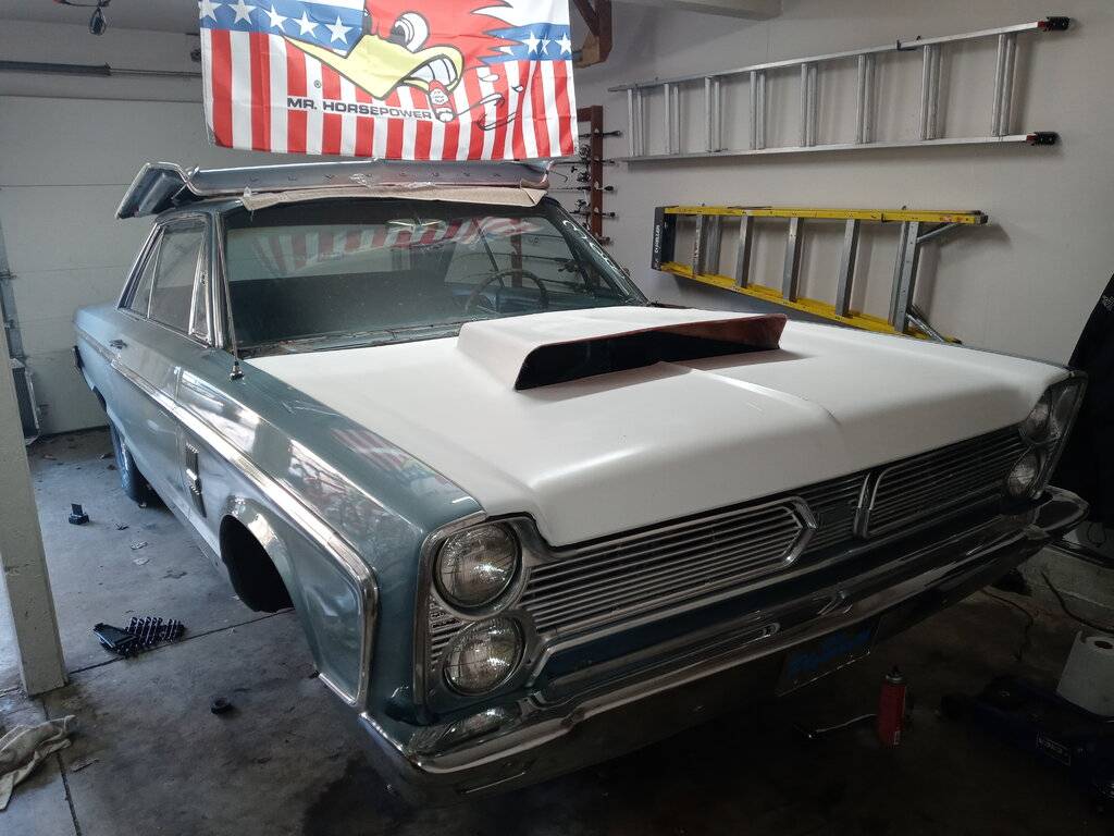

I've got a 66 Plymouth Fury with factory disk brakes and spindles. I'm looking to go aftermarket "Wilwood or any other performance brake" but can only find kits for aftermarket drum spindles. My question is there any difference in drum and disk spindles? Or is there a bolt on aftermarket for a factory disk spindle? Car is going to be running E-85 with a 500 stroker.

I've got a 66 Plymouth Fury with factory disk brakes and spindles. I'm looking to go aftermarket "Wilwood or any other performance brake" but can only find kits for aftermarket drum spindles. My question is there any difference in drum and disk spindles? Or is there a bolt on aftermarket for a factory disk spindle? Car is going to be running E-85 with a 500 stroker. View attachment 495966
