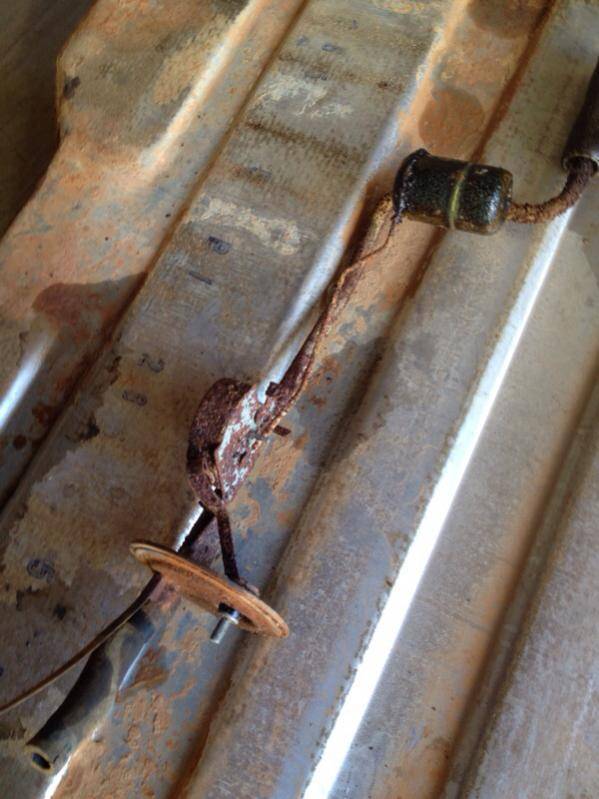

Yes-actually I took it out before I gave it to him.
Check this out..... It was quite rusty:

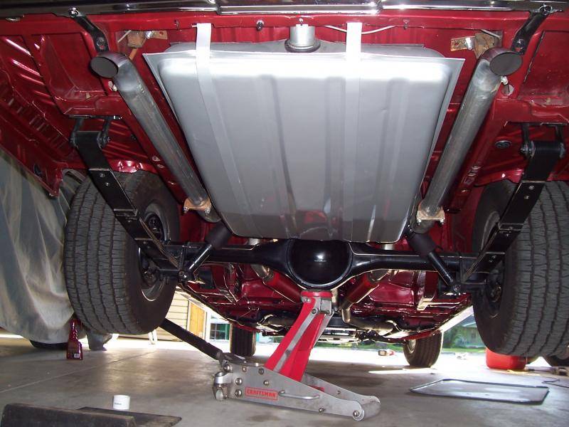

Search posts a few months ago. I have been holding off on a fuel tank for my 65 Newport for years because new ones are $300 (see ebay). Several people said a B-body tank fit fine, and they cost ~$150. They said the straps didn't match the depressions, but no worry. I recall several photos. Of course, 66 may differ.
I put a b-body gas tank on my 68 Fury didn't have no problems at all. Notice how the straps are offset this allows room for the exhaust to run between the frame and the tank.005.jpg
