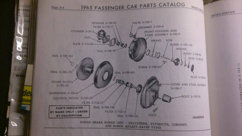

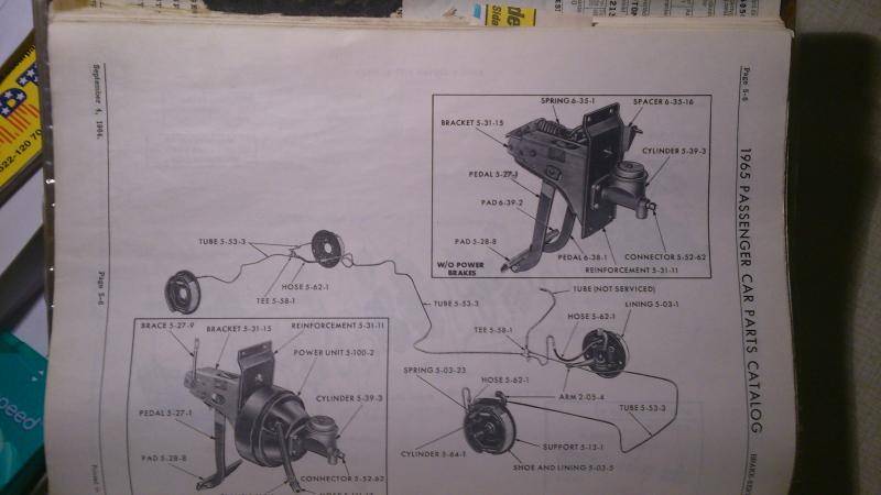

DSC_0309.jpgMaybe something like this.

You need a 1967+ power brake booster, a 1967+ drum brake dual master cylinder, and a 1967+ proportioning valve.
And brake lines plumbed for dual master cylinder brakes.

Thx for the pics but that isn't what I need. Surely someone has made this change before and can tell me specifically what to buy? I see they have rebuilt boosters with and without the mastercylinder, So I need to know if theres a bracket, or a special vaccum piece or whatever to make it complete.

A stock '67 system is a direct bolt in. No mods necessary except for new brake lines. After 47 years, you need new brake lines anyway. You're a head on collision waiting to happen as you sit right now.

OH!, with a power brake booster, you need a new brake pedal to booster rod.

Your car should only have a distribution block. The proportioning valve would be used for disc/drum applications. If you follow your brake line down to the frame, you will see the fitting down there.
