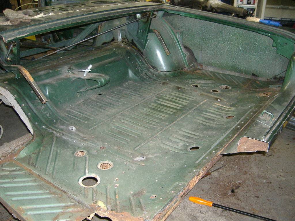

If the trunk pan from the Fury is real nice I would use it. If you have the skill to replace the pan, you should be able to handle some fab work to get it to fit. As Cbarge mentioned, there is a bit of a difference between the two in the area closest to the rear bumper end of the trunk where it angles up, but the flat area is the same. It could take years to find a nice '67-'68 trunk floor, as they tended to leak water worse than the '65-'66 cars did.

Here's a pic of a 1966 Chrysler trunk floor. The Fury should be almost identical. You can compare this to yours and see if it's close enough for you.
