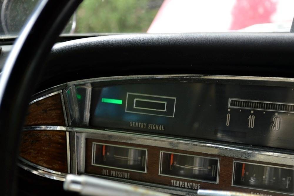

    Hopped inside and played with all things electrical, right in my wheelhouse so to speak. Discovered that many of the problems are related to sitting idle for 31 years. Imagine that. The rear driver's side window would not go up but I discovered it would go down more. Not the desired result, but at least the motor was good. Pulled the switch panel, switch is rough. But by applying some pressure to the connector and pushing the switch, eventually the window came all the way up. Success!
    Moved on to the courtesy lights. Nobody home. Same with the map light. And dash light. Turns out every damned bulb I've pulled so far is blown and looks to be original. A plus - at least they should all be a simple fix.
    Wipers work, horn works, aerial went up and stayed there. Locks make a nice noise under the dash but no workie in the doors.

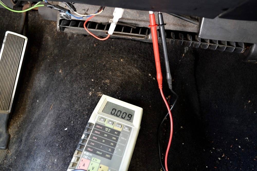

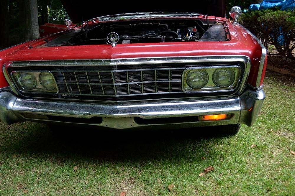

    Moved on to the directional signals my buddy had mentioned were non-functional. Grabbed my trusty Fluke meter and checked for voltage at the flasher plug. Sure enough - 12 volts in each position. Picked up the flasher unit and noticed it rattled inside. Huh...not supposed to do that. Hopefully another easy fix as soon as the flasher and bulbs arrive.

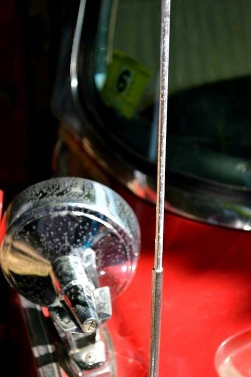

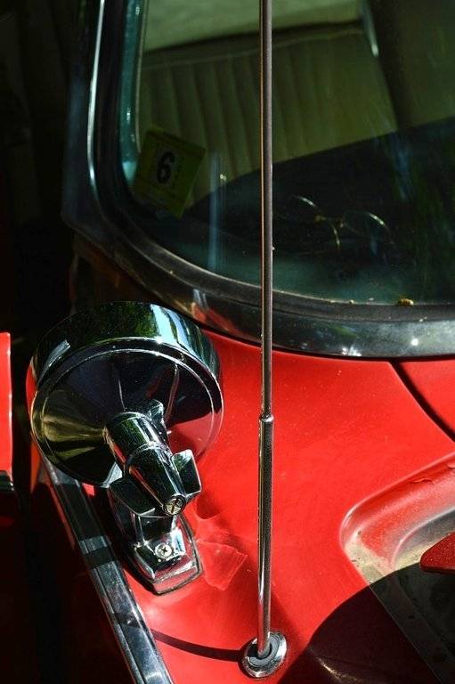

    Worked on the aerial yesterday evening. Couldn't find my electrical spray contact cleaner so I used the next best thing, the trusty standby: WD-40. Shot some into the switch, worked it up and down, no joy - up only. Reached around through the missing glove box area (did I mentioned the missing glove box?) and did a Stevie Wonder appraisal of the wire connections. A bit of wiggling and - downward motion! Worked the switch a few more times and wiggled the wires, it now appears to be working reliably. Waking Up An Old Car 101.
    Here are a few photos of the progress, including some quick chrome cleanup and voltage measurements from the flasher plug. And whatever else looks interesting.

    How did you cleanup that mirror?

    Len - I cleaned up the chrome with Windex and 4 aught steel wool. Sounds counter-intuitive, I know. Steel wool in common form(think Brillo pad) is very abrasive, but the higher grades like #0000 and #00000 are more for polishing. Still, they're not for everything and require care if used. Thinly-plated objects come to mind.
    Steel wool will leave behind residual steel bits like grit or dust as they break down in use. This can cause rust and other issues if not properly cleaned up. I usually wash well then spray or wipe with WD-40 or such.
    Though it looks and is a lot better, there are still small pits and other blemishes where the chrome was damaged by the pot metal beneath. But it's a lot cheaper than re-plating at this point for a car that is destined to be a driver.

    Dayum! That mirror and antenna came out great!

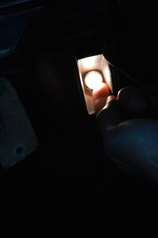

    Had to recharge the battery due to a new short somewhere. It's been on the Battery Tender a couple days now and was around 80%, so with new bulbs and flashers in hand, off I went.
    Plugged a bulb into the passenger door pull, on came the courtesy light. Tried one in the drivers side, no joy. Switch works as it activates the passenger side, so I'm guessing it's a ground issue due to having the handle off for repair. Could also be a bad pigtail.
    The map light must have been designed by someone with tiny fingers. I could barely get the blown 1004 bulb out and there was no way I was putting a 90 bulb in as a replacement. I suspect the larger glass envelope on the 1004 was selected for a reason: slightly more purchase when installing. I did push a 90 in temporarily and it lit with the courtesy lights, which is good.
    New 1891 bulb in dash, no joy. Haven't cleaned socket or checked wiring yet.
    On the the directional signals. Installed a replacement 224 flasher in the socket, turned the key to ACC, flipped up the lever and 'tink-tank tink-tank' away went the left signal. Got out and checked, both lights working. On the the right, same result except the green dash indicator ist kaput. I'll bet it's another blown bulb. But both outside lights work, a big plus on the road to passing state inspection.
    Hoping to get the back seat removed for an inspection of the trunk Sunday if wx permits. Hopefully I'll be able to reach a good distance into the trunk with a ratchet. Looks like the better part of 3 feet otherwise, that's a lot of extensions!

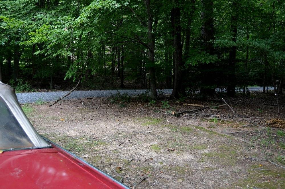

    Photos of progress attached. Also a shot of some dead limbs that fell nearby. Need to get it moved sooner than later. Door Light.JPG Map.JPG Left Signal Dash.JPG Left Signal Rear.JPG Left Sginal Frt.JPG Limbs.JPG
