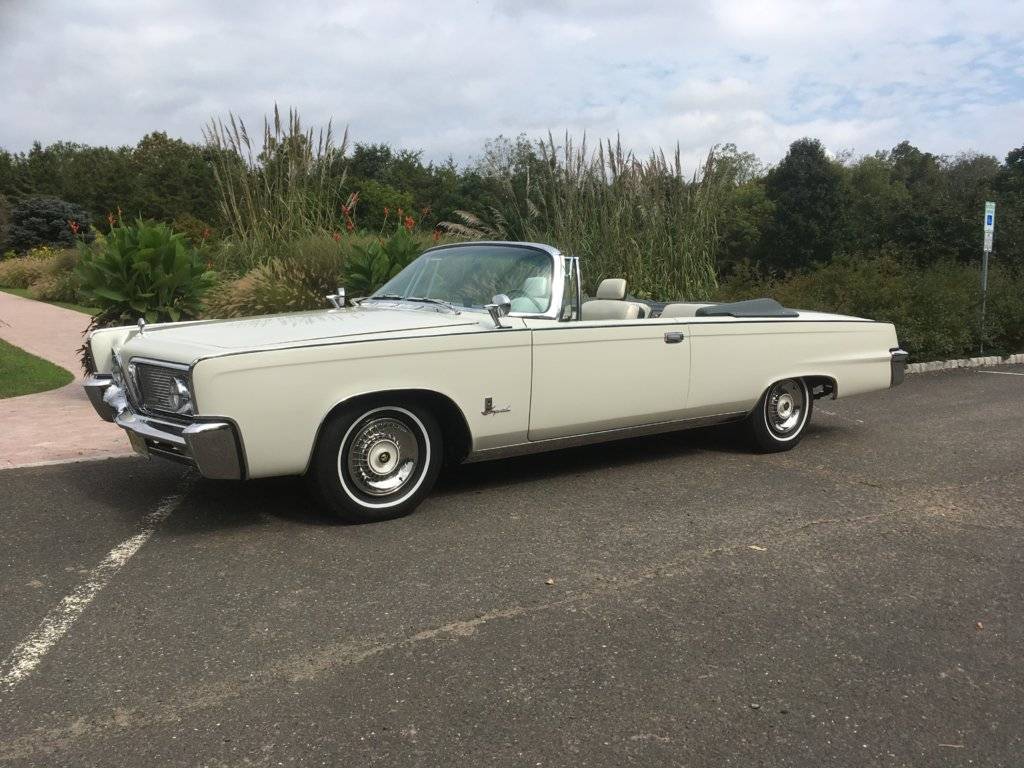

Thanks Bob! Here's a pic of both of my Imperials. (57 and 66)

Because mine is a Shriner Imp it was sold with every available option at the time. I never thought to decode the tag. I can offer the following to you based upon the docs tha Chrysler Historical sent to me on Oct 8, 2014....this is verbatum-

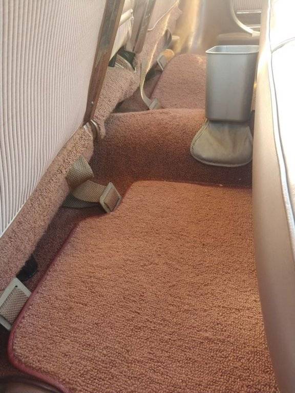

I have a dysfunctional courtesy light in the right rear quarter of my Imp. To repair it means the rear seat has to be come out, the side panels have to come out and the bulb serviced. It doesn't seem to be something worth attacking and the older I get the more I wish I had become interested in more user friendly cars! I tell folks I'm coming back as a Ford or Chevy guy..........or a Schwinn!!! But then, how much fun would that be? :rofl:
Let me know how much of PITA removing those big back seats tends to be.....I like the stuff in the car to work.....:BangHead:
And have a good day!
bob
BTW, I'd love to see a few more pix of your Imps....esp. that '57! What's the stories on your cars?

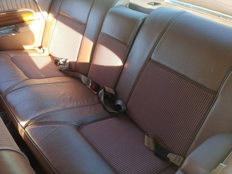

The bottom of the rear seat is no big deal to remove. You push it down, then back to remove. It works better with 2 people. I don't think you will have to remove the seat back to get to the lamp, but if you do, it's easy too; just heavy!

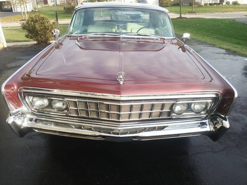

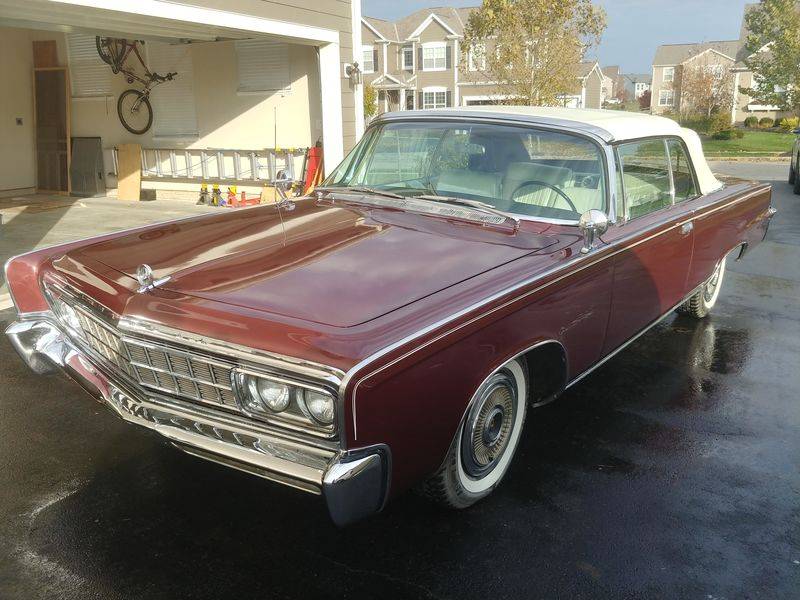

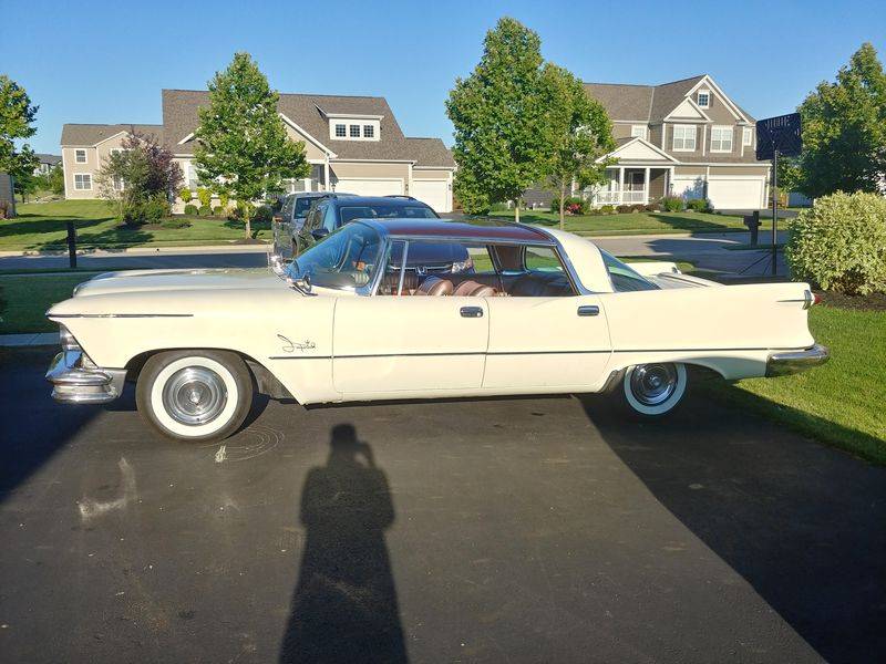

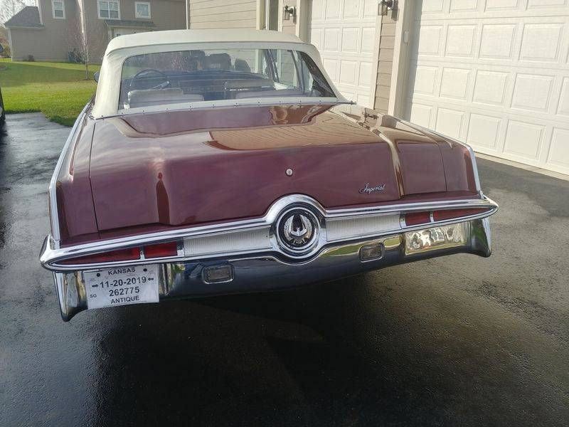

Well, here's my story, then I'll post some pictures...
About 7 years ago I bought my first classic car - a 68 Cadillac convertible. Enjoyed it and fixed up a few things on it, but it was an ugly poo-brown color on the interior, and the exterior was a sandy color. It was a good price, but the color made it where I just couldn't love it.
Eventually bought a 66 Lincoln Continental convertible which was a decent car, but it had some body damage that I wasn't aware of and the bondo started coming off with the paint. That car was the smoothest riding car I've ever been in. Didn't like the dash at all, but loved the suicide doors and the awesome convertible top. Also hated the convertible top as I spent several days squatting in the trunk of that car fixing the relays to get that thing working again after it decided to quit.

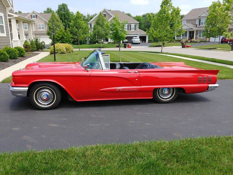

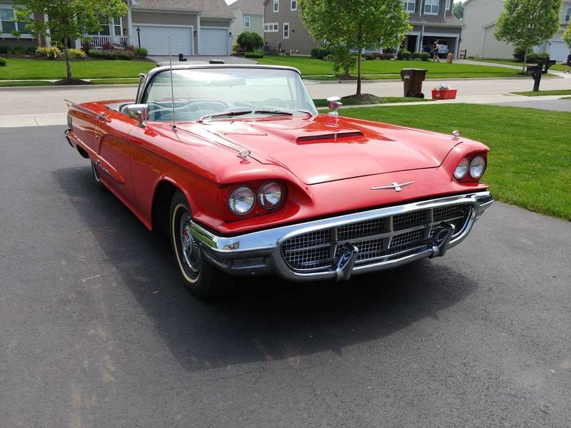

Both of those cars are gone, now have a 57 Imperial hardtop southhampton and the 66 Imperial convertible. Convinced my wife to get a 60 Thunderbird convertible which she loves, but after breaking down once on the road, she's terrified to drive it without me.
Unfortunately the 57 imp had an engine fire, so it's in the shop getting an engine rebuild right now, but the other two are safely tucked away in the garage.

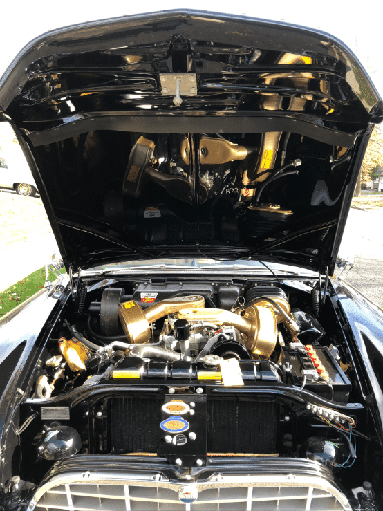

These cars are gorgeous! Are they restorations or did you have the good fortune to find preserved originals. Having the '57 300C and the '64 Imp (and a '61 300G) I'm partial to Chrysler/Imperial, but that Bird looks to fly well! The 1957 Imperial for my money is stunning!! How did you come about it? Sorry about the engine fire. Do you know what caused this? I once had a '62 Chrysler 300 and one night it caught on fire. The e-brake cable somehow shorted against the started and became so hot that the wire harness ignited. When I opened the hood he cable was glowing red! I actually had a gallon of water in the trunk (had cooling troubles) and was able to douse the fire and rescue the car. The clue was when the headlights went out. I understand your wife's proclivity about driving the T=Bird. I eventually had with similar feelings with the '62 300....it was just a headache. I'm guessing your T=Bird is FAR more reliable than that '62 300 ever was! LOL! Tell her to get back on the road and enjoy that thing!
Thanks for sharing...good luck on rebuilding the hemi! Stunning cars!
