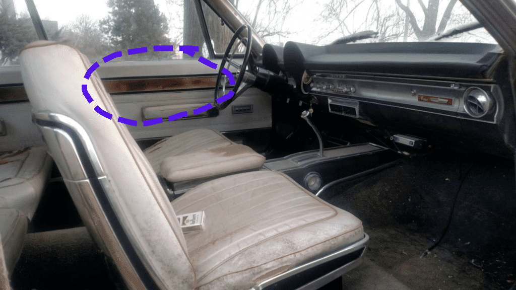

How hard is it to find this wicker material used in the Monaco 500?
And how hard is it to replace? Can it be swapped out with the door panel off?

I am quite sure that was not standard. I dont think wicker was stylish until the 80s or 90s but never in cars.
There is probably woodgrain applique under it. Probably much easier to find sticky paper with woodgrain.
On the center console too.

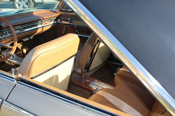

My car.
Bright sun kinda washed out the color but I'm happy with the results. Fortunately the seat backs were not scuffed up and came out well.
