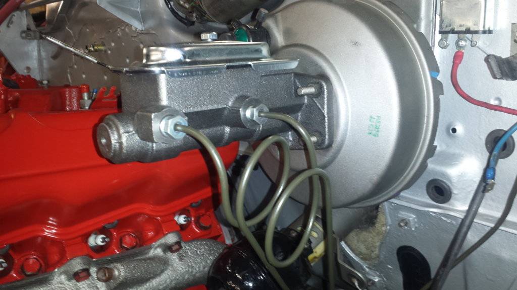

    Hi,
    I took all the 1967 dual components and bolted them into place.
    Really what you need is the dual drum M/C and the distribution block from a 1967 C body and be sure to plumb it into place correctly.
    If you can't locate the distribution block then you will need to add a metering valve going to the back brakes only and adjust until the rears don't lock up under a heavy application of the brakes
    If you are converting to power drum if not equipped already then you will need to change the brake pedal assembly and add a booster from a 1967 C body as well.
    Last advise is to plumb the rear pot to go to the front brakes and the front pot to the rear brakes for proper installation
    • Like Like x 1
    • Disagree Disagree x 1

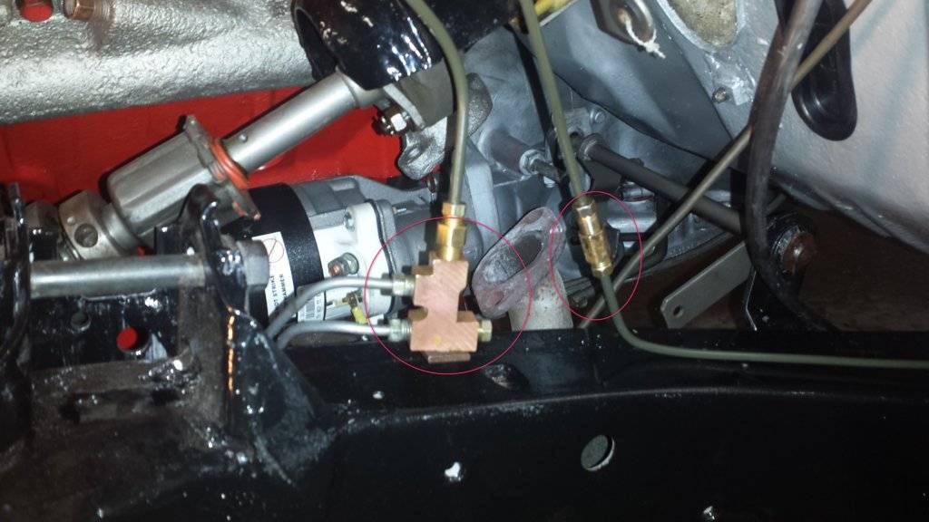

    Here is where the metering valve would go highlighted on the right red circle
    This was my first attempt without the correct distribution block
    the left circle is what you need to either block off as shown here or replace with a 1967 distribution block and plumb all lines into that then to the back

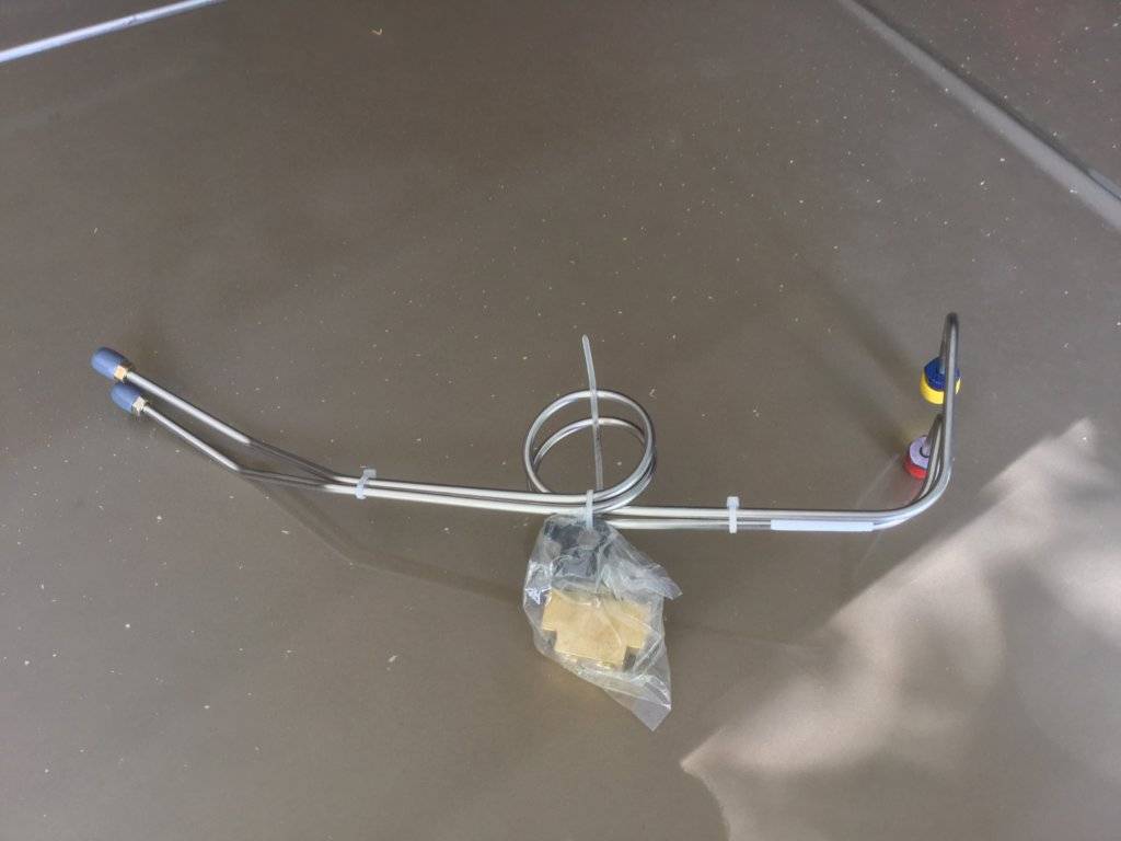

    Inlinetubes inc. has the conversion kit. Pre-bent lines, fittings and block that bolt right in place of the original block.

    This is the inlinetube kit for our cars.
    No bending tubes or modification of existing tubes required.
    Swap this dist. block with existing. Done.

    1965 C-Body Dual Master Conversion - Master Cylinder Lines with Block
    CDB6503 - Stainless $79.00 or OEM $69.00
