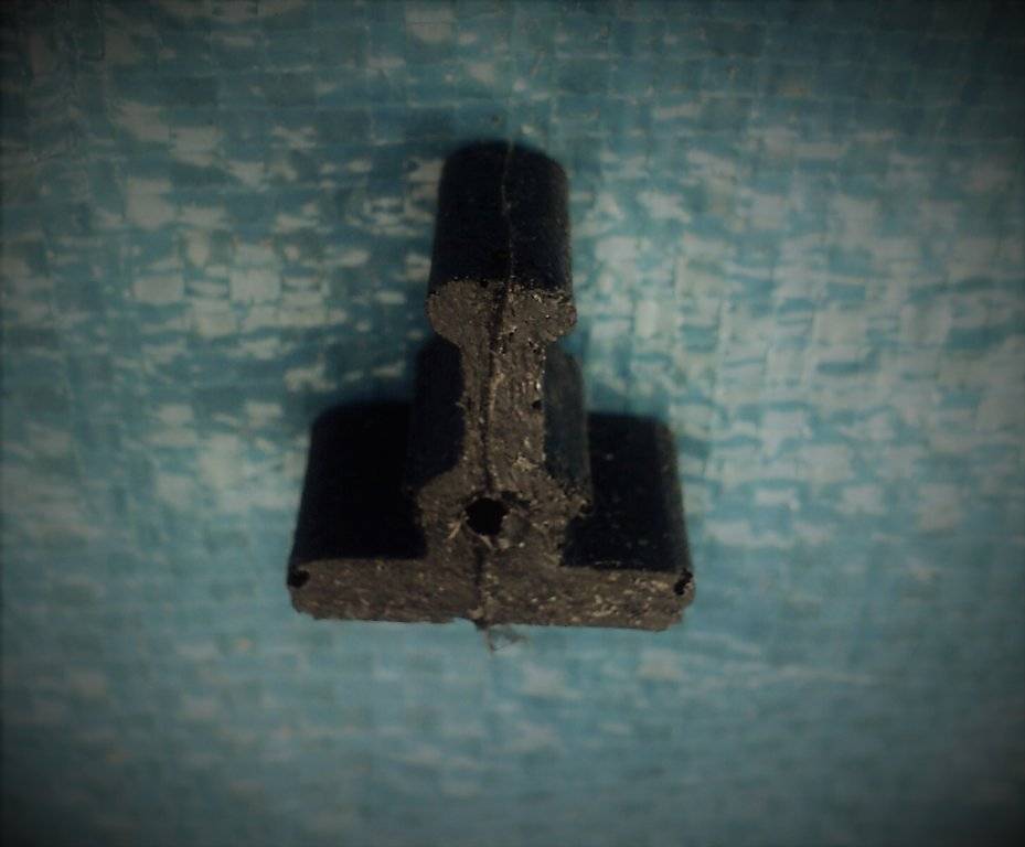

I have a few of the Power steering bracket "snubbers" New ,10.00 each+ postage. PM me if interested

I have a few of the Power steering bracket "snubbers" New ,10.00 each+ postage. PM me if interested.
Now with Picture !
FWIW those snubbers really help, plus making sure the pivot holes are not worn out of round.
That's the same snubber used on some brake and clutch pedal brackets to cushion the pedal return.
There are so many of those brackets running around with a block of wood wedged into them that the wood block should have a Chrysler part # on it.
