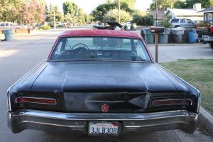

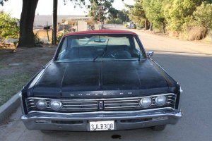

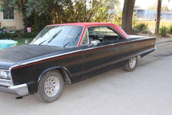

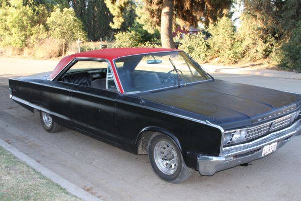

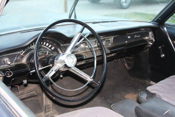

hello all.i just got a 66 2 door newport yesterday,it has a 383 2 bbl it has oil coming out the breather. it leaks,runs alote hotter than my 318 that was in my dart .id like to keep the original engine but at the same time id like to find a 440 to build for it.more torgue sense u guys know these cars best whats the best engine and performance upgrades to go with and the best fuel milage yeah rite haha.is one engine more efficeint?maybe a 383 or 400 with a 2 bbl?or is the 2 bbl vs 4 bbl any better on gas milage?im retaining the a/c it has power brakes also.although i do a have a crane cams reserve tank laying around.this thing needs all the power it can get to move this land yaght lol.
