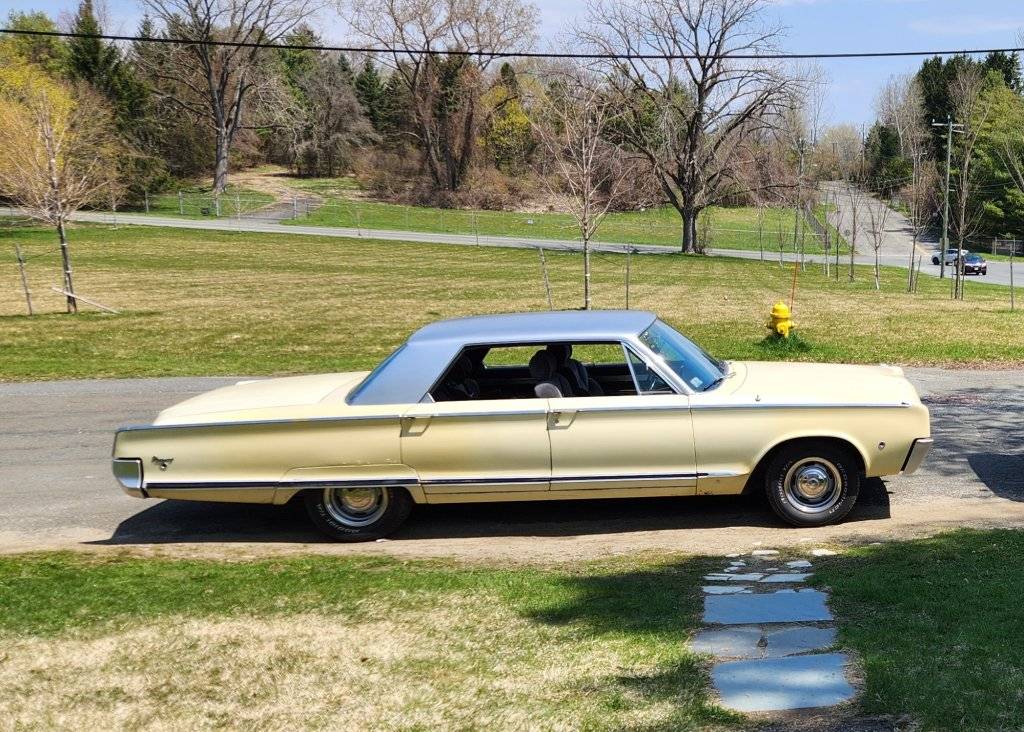

66 newport 383 3 on the tree been dailying it since the weather broke up here in the northeast, took it out this morning got a coffee dropped the son off to school and about 20 minutes into my commute to work it feels like I lose a cylinder, being only 10 minutes from work I brave the rest of the drive and low and behold 5 minutes later it clears up and doesn't come back. Fast forward to later on the day I leave work and do a substantial amount of cruising around and turning the car on and off running errands etc and no misfire. The Mrs. and I go for a cruise and all of a sudden misfire comes back and it's more noticeable than this morning, turn the car around and start heading home and sure enough 5 minutes later it clears up. Car is still points and I did plugs last fall before putting it away, any pointers of where to start digging would be appreciated, I can't imagine it's compression related if it's coming and going so I'm guessing it's spark related but being that it keeps disappearing I haven't been able to throw an inline spark tester on it

Coming back to update, simplicity seems to prevail I filed the points and here we are several days later without issue. 2 theories I have mustered up, 1 being of course the points and the 2nd being that I have never had to put more than 6 to 8 gallons in the car at any given time as the fuel gauge doesn't work so I stay on top of it. The day of the issue the car took 12 gallons so I am curious if it there was any moisture in the tank if it had gotten low enough to suck it up
Moisture and ethanol'd fuel results in "phase separation" where the moisture-fueled gunk settles to the bottom of the tank. Guess where the fuel pickup tube is located. That stuff can cause some flaky running, but not sure about exhaust smoke.
