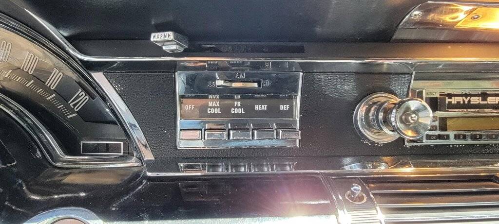

Here's a photo of my AC controls

Yup, factory AC. In regards to puking coolant after driving - is the car overheating? If so, there's an issue. If not, and the gauge reads OK temp-wise, then it's possible you're over-filling the rad. Don't fill it right up to the neck, but leave it about 2" down. Typically they'll stop puking once it gets down to the level that allows for rad fluid expansion to fill the available space in the rad without overflowing (roughly 2" down). Your cap may also be weak.
