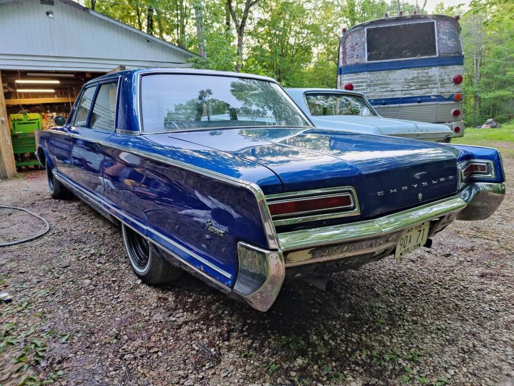

I finally pulled the trigger yesterday and picked up a Viper T56 with the .5 OD. I've been chasing efficiency and high speed for a while so this was the obvious choice as soon as I heard it existed. There seem to be plenty of options for hooking a T56 up to a big block but I'm interested in what folks have tried and how it has performed. Before anyone gets too upset about me cutting up a car this one is plenty rusty and anybody restoring it would need to cut up the flloor and tunnel anyway to replace the swiss cheese floorboards. The car has 242k on it and I can't bring myself to go to all the effort of swapping a trans and still having an automatic afterwards.
What I'm looking for more than anything else is pictures of one being installed. I'll obviously have to cut a substantial amount of trans tunnel but I'd love to see just how much.
Should I swap to a short throw shifter since I'll be adding a rather tall shifter compared to the viper setup? I'd prefer a "truck style" no frills shifter and I'd like to be able to shift without smashing the dash and preferably the center drawer when its open.

I already have people telling me I won't be able to use 6th and that I'll just stall it trying to start every time unless I find the weakest clutch available. I get blank stares when I remind them my 1st will be deeper than an a833 1st. 6th will be perfect for cruising without spinning the engine stupid fast all day.

I'm not really interested in burning rubber or stoplight racing. I am interested in how far I can stretch 25 gallons of gas across Kansas. I'll eventually end up swapping to a Dana60 for cheap rear disc brakes so I'll have to bump to a 323 if I remember correctly. I still haven't decided if the Dana60 is worth losing the 2.76 though.
If I actually have any trouble with rpm being too low I'll throw a truck cam in it before I swap gears.

I'm really not here to argue if my gearing is a good or bad idea. I can go to any car club meet to listen to people tell me I'm "doing it wrong" building something with a different goal than the usual. They usually quiet down after they watch me hit 115 in 2nd.
I want to see what I'm going to have to cut and see what clutch, flywheel, and bell housings people have used and how they like them.
