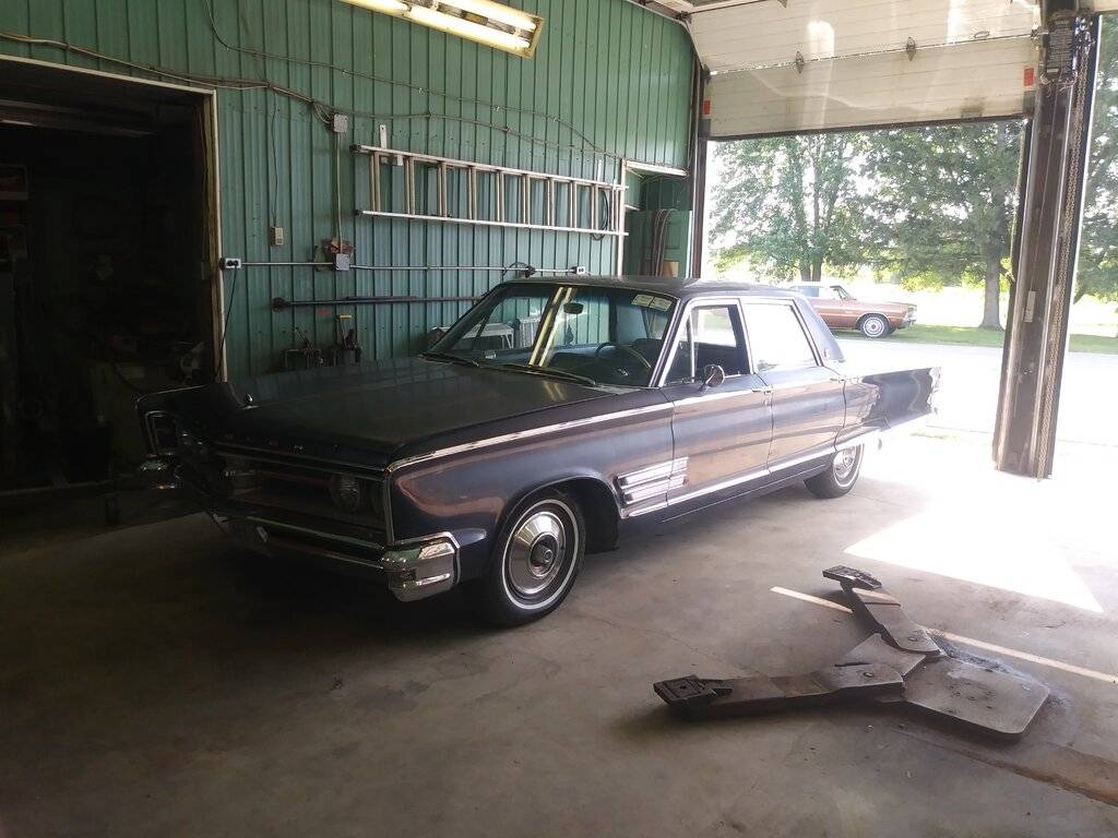

This post ended up much longer than I expected so I'll add some pictures to make up for the great wall of text. :D
She's a Convertible 500 with a 440 and she's never left Big Sky Country. I inherited it from my uncle after he passed away. He loved this car and I want to take proper care of it in his stead.
