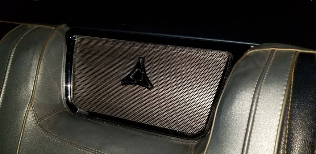

This one has seen better days. Does anyone have a better looking one or a part number?

I managed to find some stainless steel mesh at a local metal shop. I tore out the old one flattened it out and used it as a template to trace and drill holes. I simply cut out the new one with tin shears and pressed it into place.

I got a 24 inch square sheet of mesh for $10 and still have enough for at least 3 more speaker grills.
Sorry I didn't see this.
Your fix looks great, good job.

The DIY route paid off! I wouldn't know the difference, I see a handful.of convertibles each year. Now I'll have to start paying attention.
