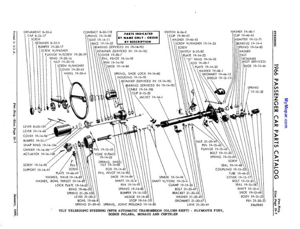

The locking ring has several sets of holes to line up with the 3 screw holes in the actual locking mechanism flange bolt - this is the bolt with the great big flange that screws into the centre of the column. The big flange bolt needs to be put on AFTER the locking ring is in place, and tightened up until it nearly bottoms out against the locking ring. Use a pair of medium needle nose pliers to tighten it up so that the telescoping is just engaging. Then find the 3 best holes to line up with the locking ring so that you still have another 1/4 turn to the right to allow it to tighten down enough to lock the column from telescoping. If you don't have the flange bolt turned in far enough, then it takes more than a 1/4 turn, and the spokes of the locking ring prevent it from turning that far. It's a bit fiddly, but it works.
As well, if the long hardened steel 3/16ths rod that hides in the centre of the column managed to fall out, then the column will not lock the telescoping function. The flange bolt presses down onto this rod as it threads inside the column shaft, and the rod presses against the locking clutches deep inside the column. No rod, no lock.
To pull the wheel you have remove the horn ring too I believe, as well as you have to remove all the parts associated with the telescope locking ring and flange bolt to be able to remove the steering wheel. Sometimes the steering wheel puller isn't properly centred in the column, and that will impart a tilt to the force you're putting on the splines to pull the wheel off. Try making sure it's dead straight, tighten it up, and try a few taps with a decent hammer around the spline area. Be careful, as it can come off with a fair amount of force.
I've tried to attach a picture of the page from the parts catalogue. I hope it works, and I hope this helps.

Thanks Ross
Would it be possible that the wheel has come away a little bit and jammed and now that is why when I tighten the flange bolt it is not reaching the rod to press on it? Either that or do you know how long that flange bolt thread would be, perhaps it is broken and I have some of the flange bolt stuck in the column hence no lock?
